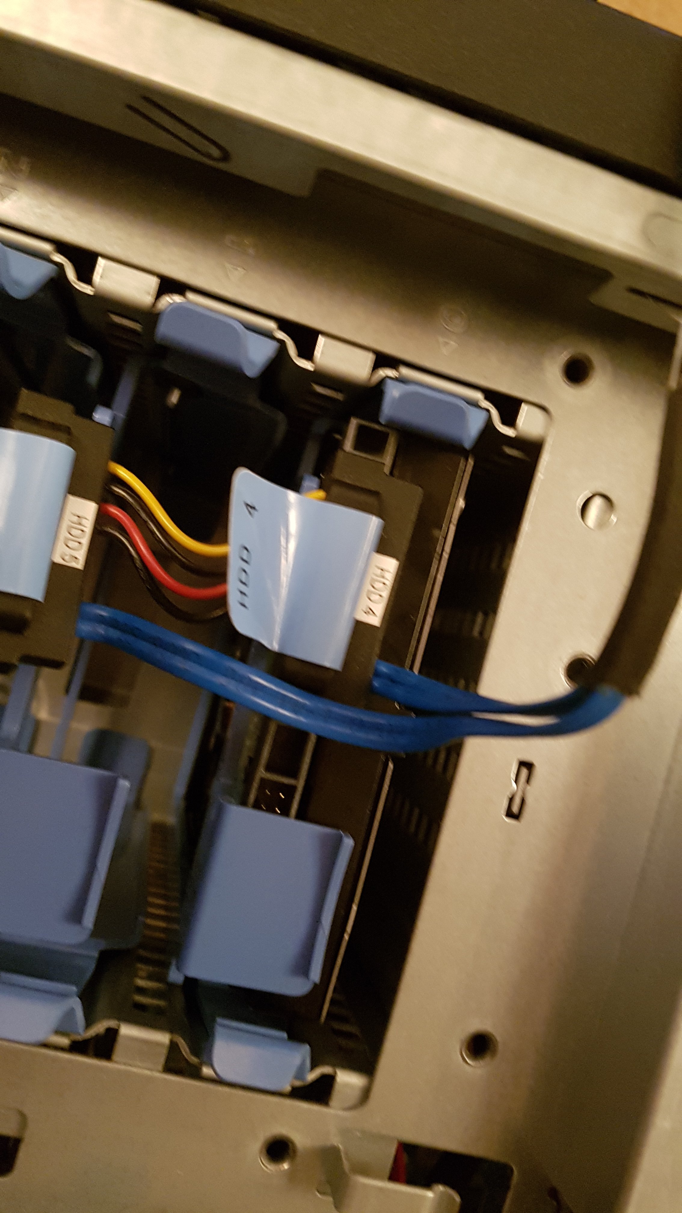

Anyway, a further update is that I've managed to get my server up an running by following the video tutorials and I was just about to set up the array when I noticed that although the SSD I intend to use as a cache drive was showing up, the hard drive I've got in there isn't!?!? (I've just put a small 160GB HDD in there to play about with before I'm ready to put the proper drives in there!)
Anyway, it occurred to me that I'm not entirely sure I've got the HDD plugged in correctly (and this may be the stupidest question yet!) - there is a strand of cables that come from the mechanism that is attached to the PSU - these are labelled "HDD0" to "HDD5" and the connectors cover the power connector along with the SATA part of the hard drive - and at the end of the 2 "strands" there is a larger connector that was slotted in to the RAID controller card (I took it out thinking I didn't need it and could just connect the drives without!).... I know this is probably a ridiculous question but I assume this needs plugging in somewhere??
I'm used to desktop builds where you have a power cable from your PSU and then a SATA cable that goes into the motherboard - I presume server connections are different given that the connectors cover both the power and data connections?
I can't see anywhere on the motherboard for the larger connection on the end to go so does this mean I need to put the RAID card back in and use that somehow??

Photos may be helpful....
Sorry, I know I'm not explaining things overly well!

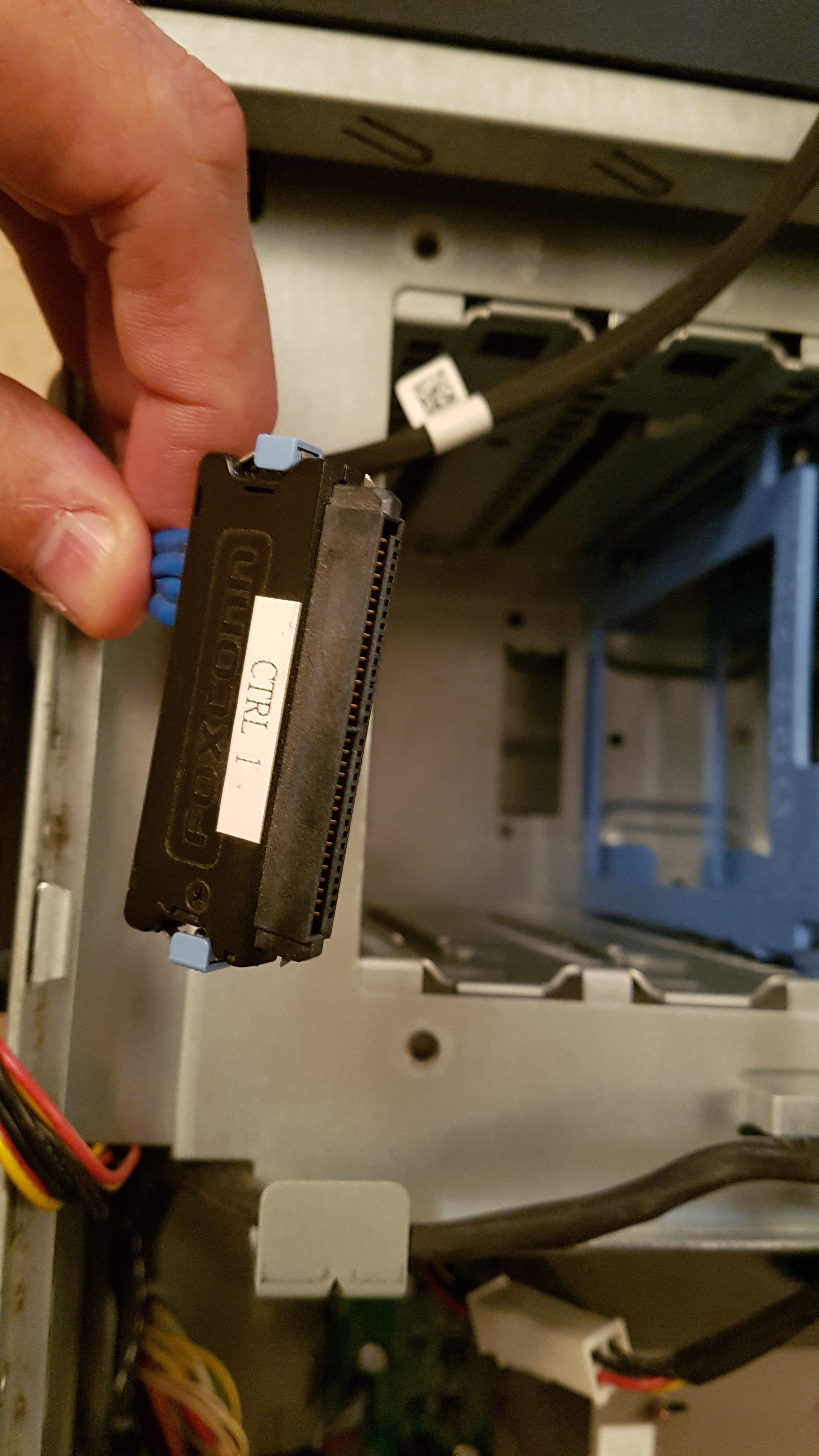

Here are a few pics - one of the connector at the end of the HDD connector strand coming from the PSU, one of the RAID card I pulled out and one of my small HDD plugged in with the connector plugging in to both the power and data connections.
 I really hope this is clear - basically I thought by plugging one of the connectors into the HDD it would magically appear - but on thinking about it, they aren't connected to the motherboard - so maybe I have to put the RAID card back in? (I've never got involved with RAID before so have literally no idea about it!)

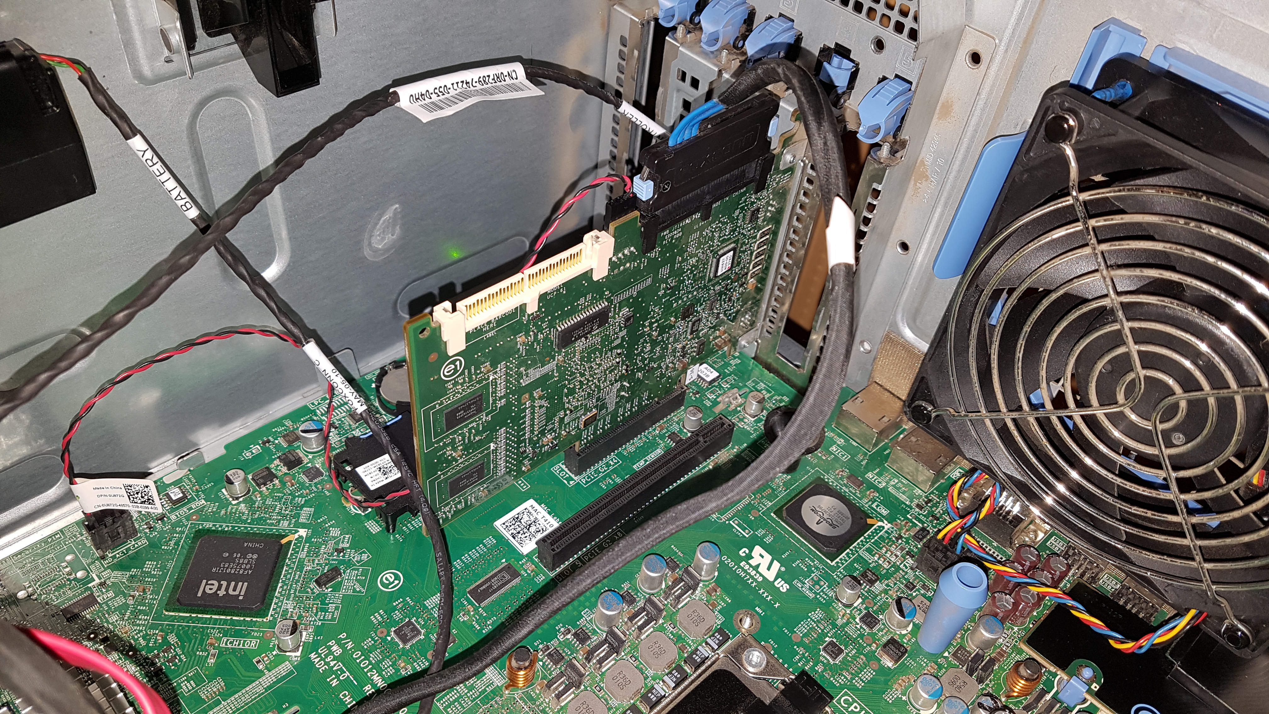

Quick update on this - I put the RAID card back in and now the system finds the HDD no problem and I've created the array - of course now my issue is that when I start adding other drives, will the RAID card mess things up somehow??

Right, I've got unRAID working OK but I'm still not sure that I've got the HDD and SSD installed/configured correctly - to this end I've taken a few photos that will hopefully explain what I've done!

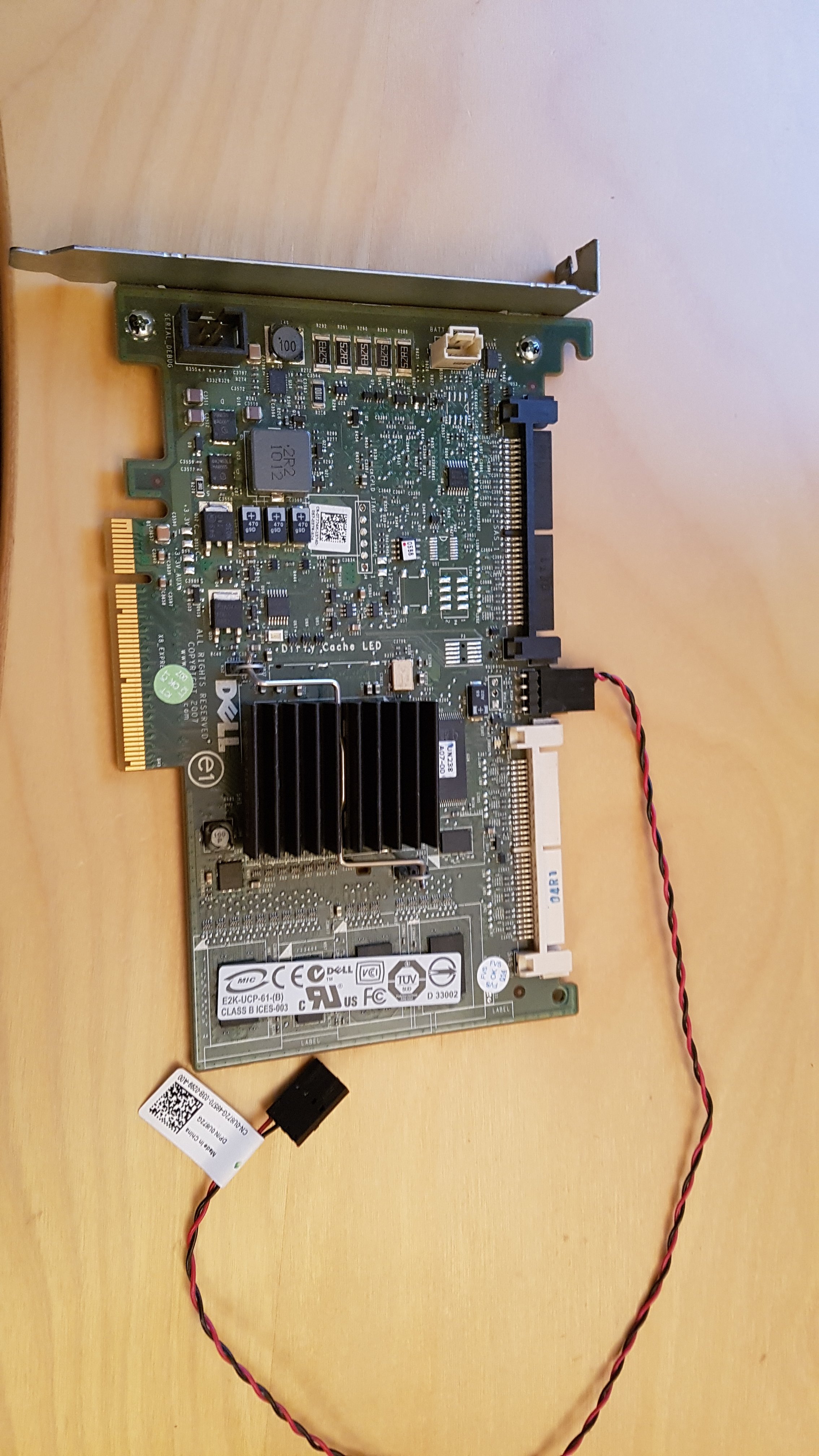

This first pic is the RAID controller card that I originally took out of the machine - having no experience of a hardware RAID device, I assumed I could just connect the HDD's to the motherboard without: (am I right in saying that the connection is a "SAS" connection - if so does this matter?)

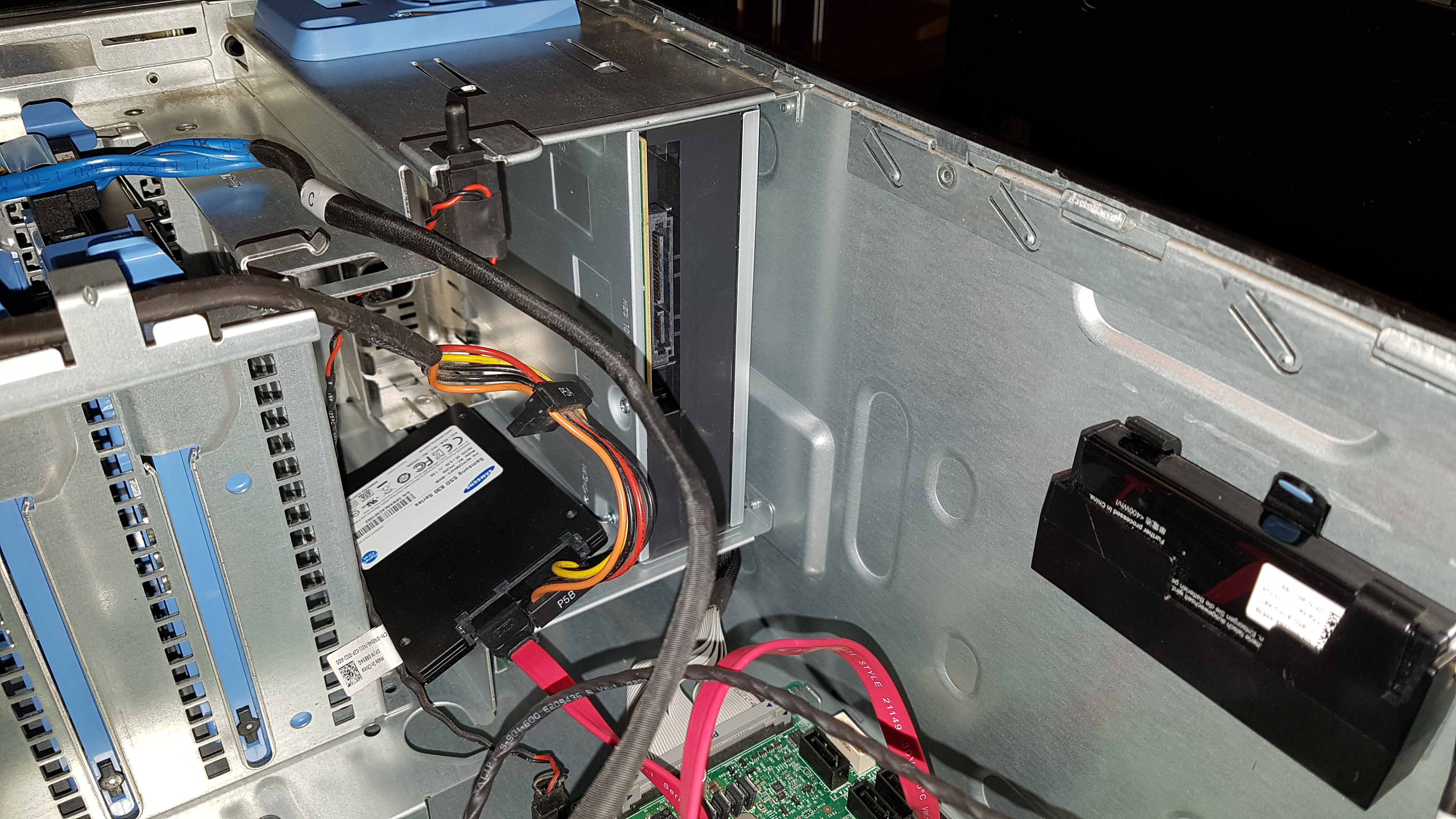

Next is a pic of the SSD placement (not fixed in yet as I'm just playing around with this!) - this is powered with what I would call a "traditional" power connector (as you would have in a desktop PC) and connected to the motherboard with a SATA lead, plugged into "SATA A" on the motherboard

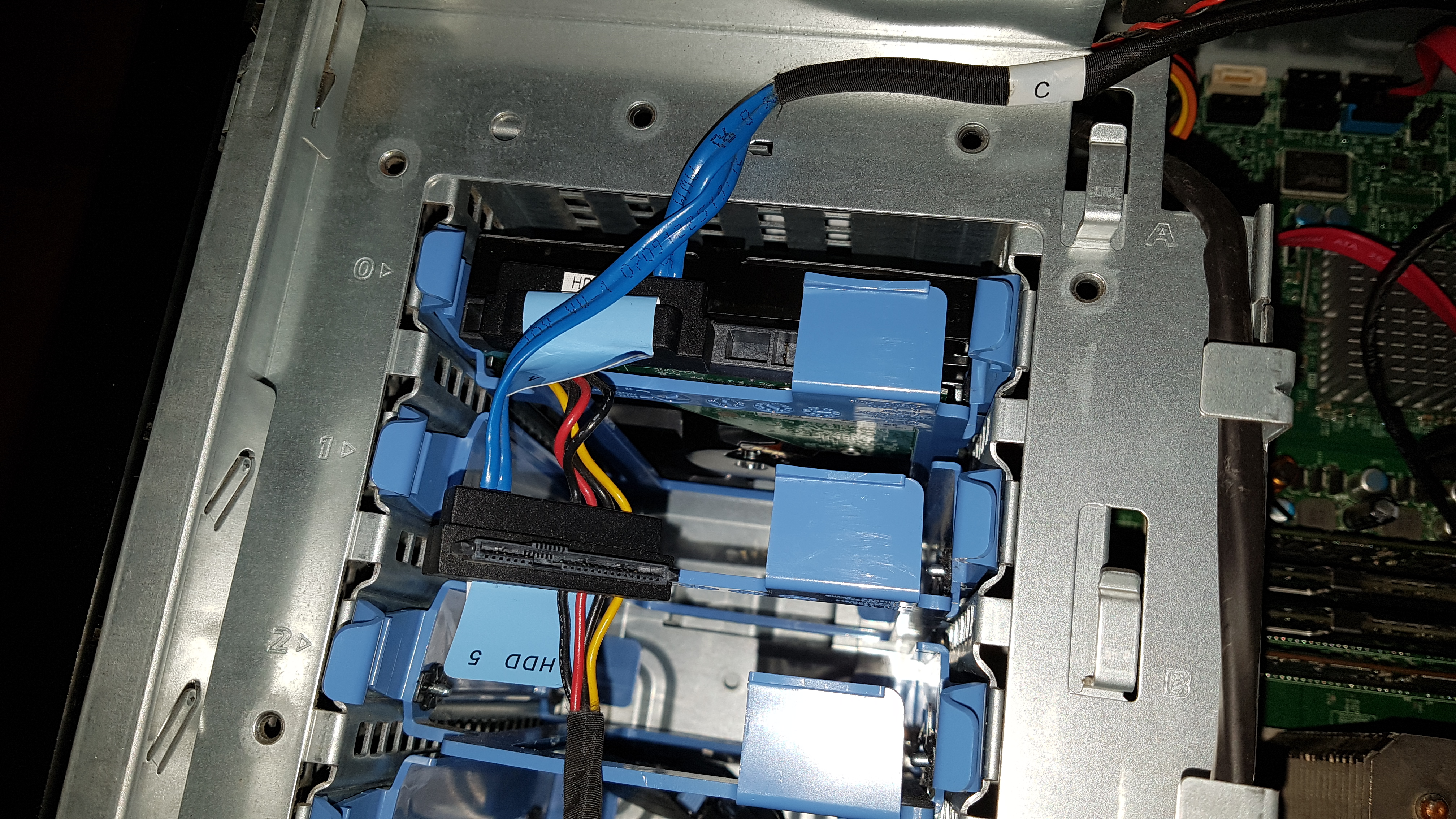

Next is the  connected 160GB HDD (in the top bay) - the connector that you can hopefully see below attaches to both the power and data connectors on the back of the drive (I've turned the next connector in the chain upwards so you can see the two elements) - this cable comes from the PSU (actually there are two but I'm only using one) and ends with the connection to the RAID card as seen above in the first pic.

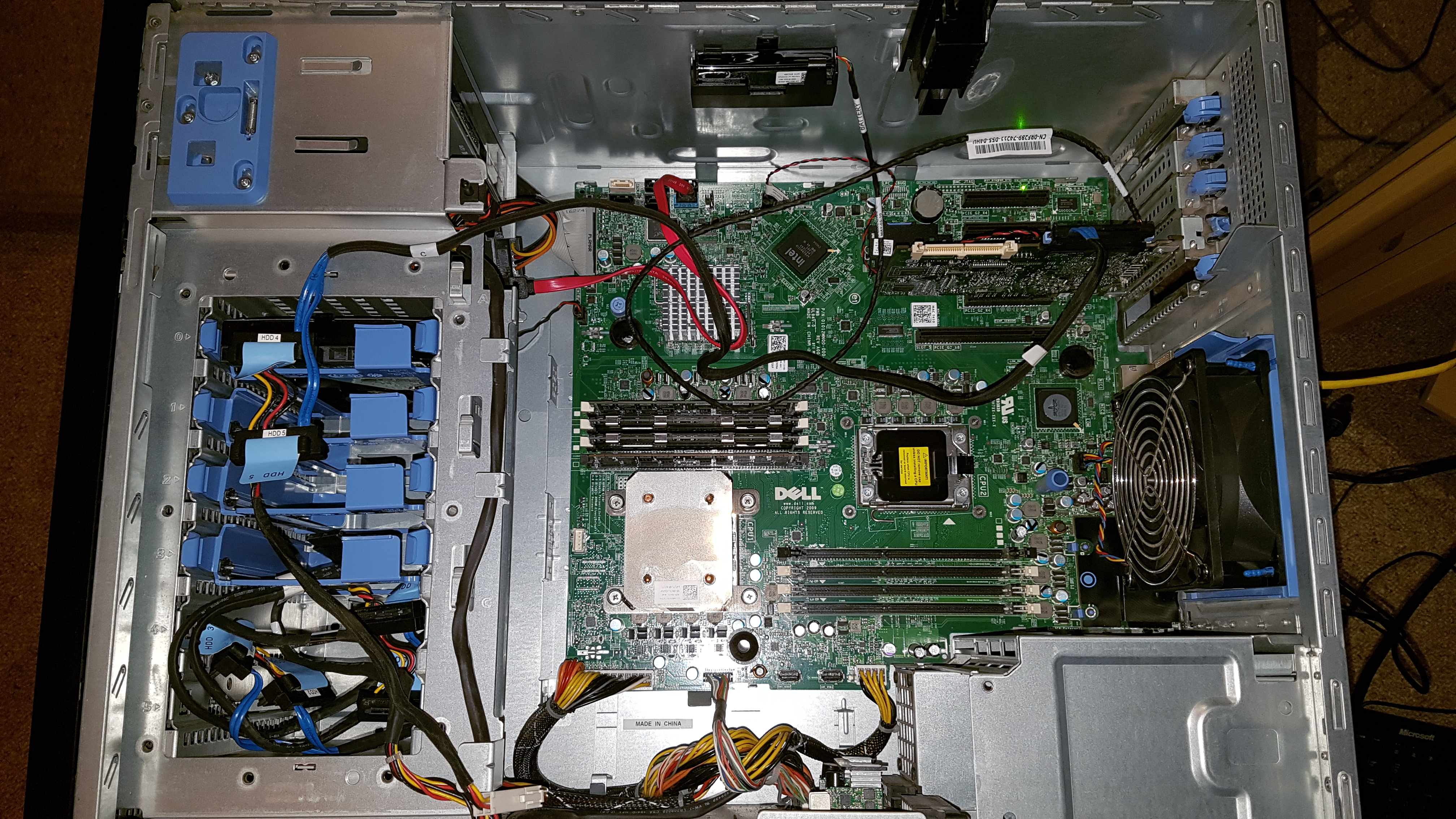

Lastly here is a pic of the board as a whole so hopefully someone will be able to tell me whether I've wired this up right or dangerously wrong!!!
As mentioned at the start of the post, with the wiring as you can see above I've managed to boot into unRAID, set up my array (albeit with just the one drive) and set my SSD as a cache drive - what I'm worried about is with the RAID card in the mix, will things go pear-shaped when I try to put more than one HDD in there? (I've got 2 x 4TB WD Red's inbound that should be with me tomorrow!)
Many, many thanks for anyone willing to give me a hand with this - I feel like if I can get the hardware set up properly then I can crack on and learn about the features of unRAID at my own pace!
Those are SAS disks connect to an old SAS controller, it's certainly limited to 2TB size disks, you'll want to connect your 4TB disks on the onboard SATA connector, which may or may not correctly detect >2TB disks, if it doesn't you can always buy am HBA, like an LSI 9211-8i or similar.
