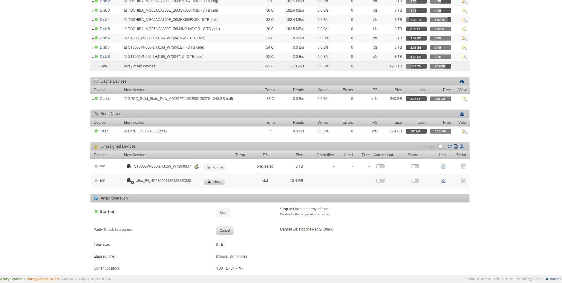

I have built myself up an Unraid server, loaded everything across to it while it was on the trial period, paid for Plus registration and literally the day afterwards the flash drive decided it was actually an unassigned device.
The shares that I had previously set up still all work fine, I can access everything just fine and I can still add files to the array.

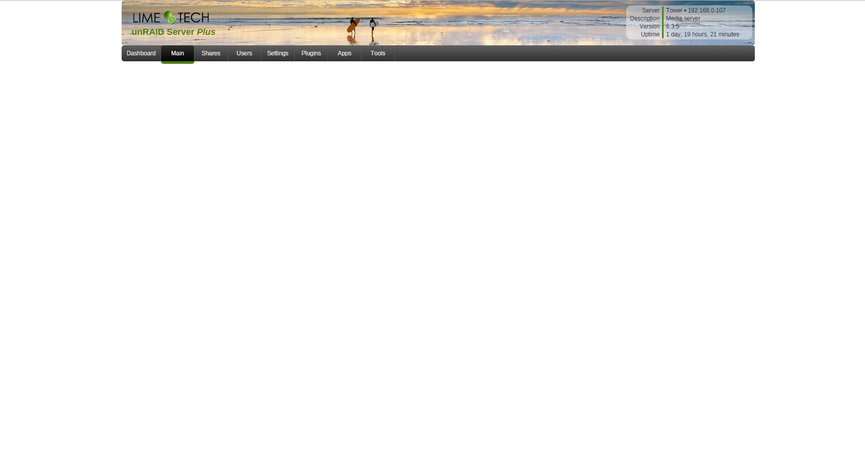

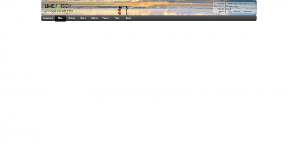

But all I can now see through the web page for the tower is the banner. None of the tabs show anything.

This can happen when the flash drive drops offline and gets reconnected, it's now sdn, originally it was sda, make sure you're not using a USB 3.0 port.
