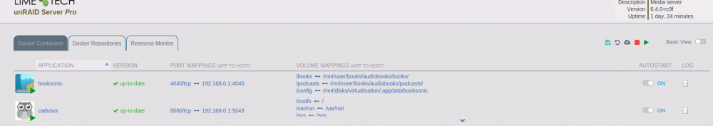

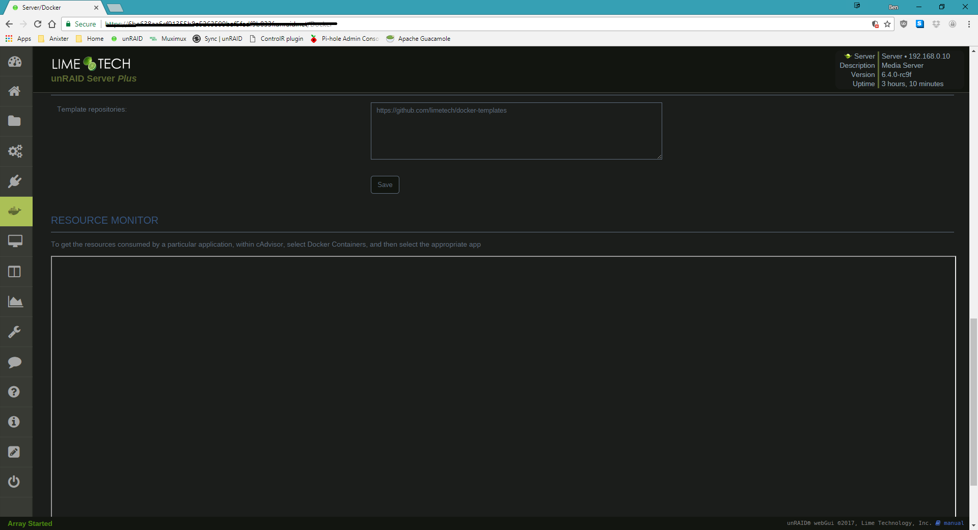

@Squid
The CA Resource Monitor no longer shows cAdvisor, I have removed the plugin and docker and reinstalled, tried other browsers and gui theme. My backup server however on 6.3.5 works just fine.

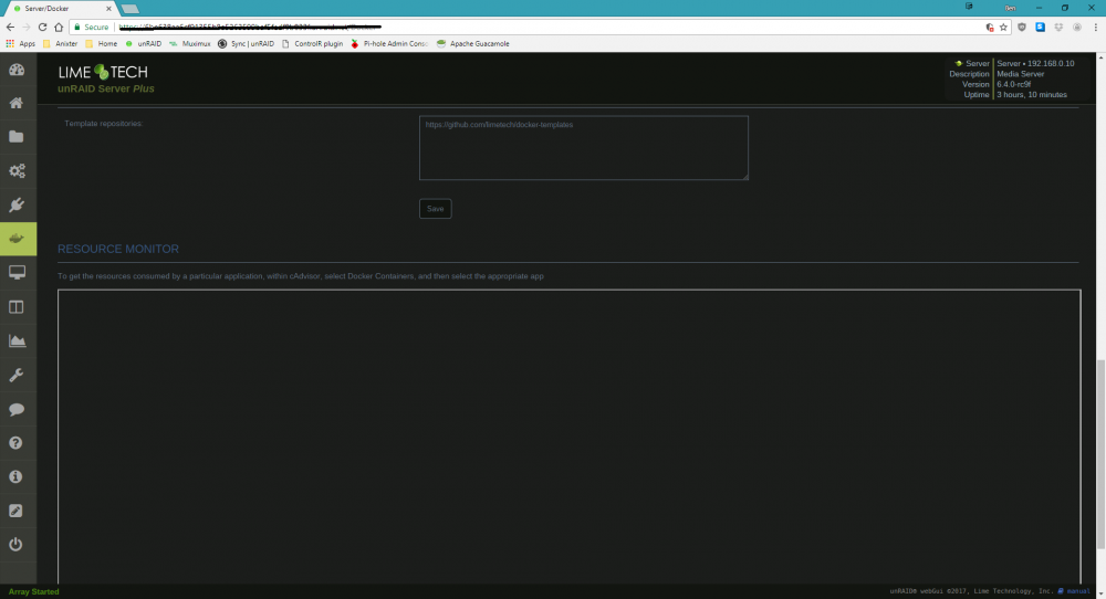

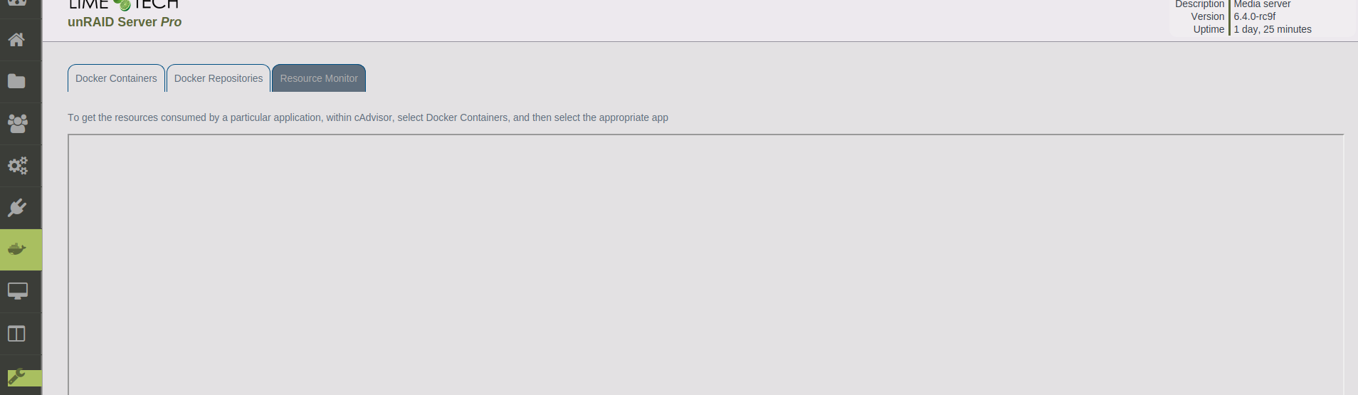

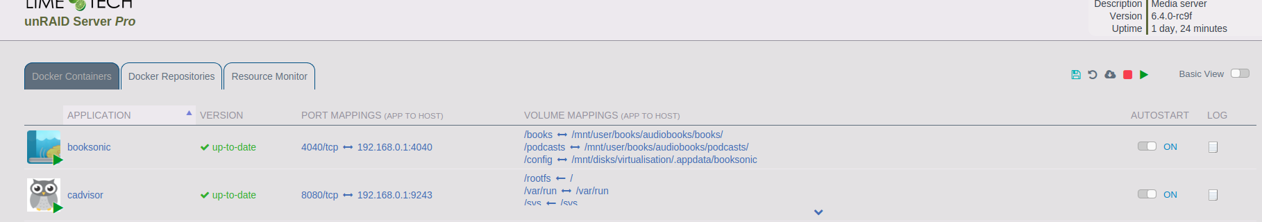

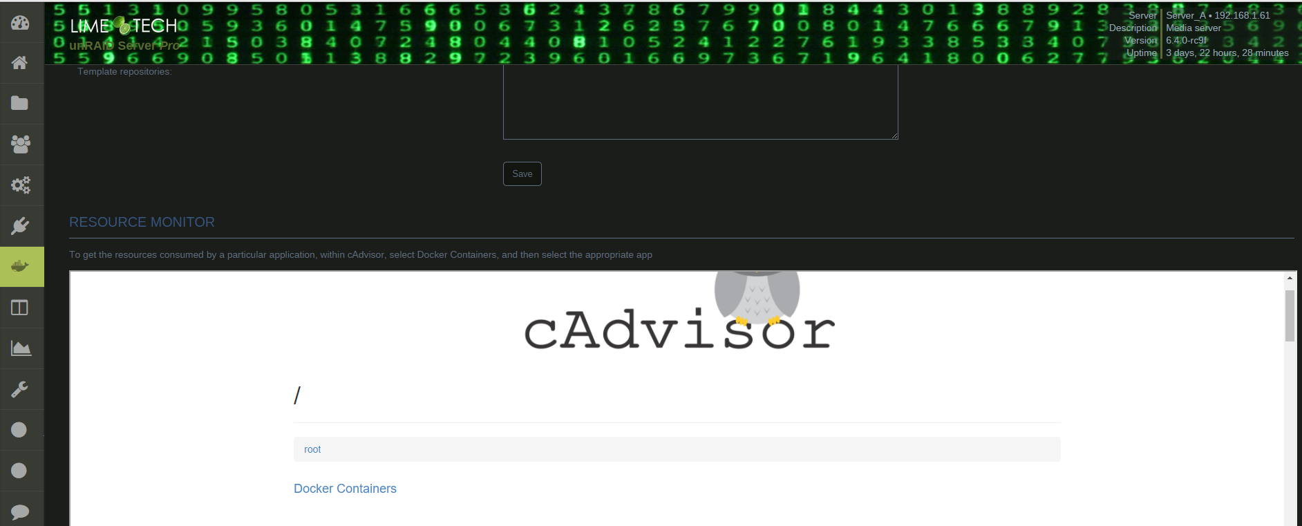

8 hours ago, Lebowski said:
@Squid
This happening to anyone else?
2 hours ago, CHBMB said:
Yep, same here,
uh ok?!
[mention=10290]Squid[/mention] Could it have anything to do with the new letsencrypt SSL stuff?
I'll revamp the code. Code expects no separate IP don't know about SSL
Just now, Squid said:
I'll fix the code. Code expects no separate IP don't know about SSL
FTFY YW! :D
