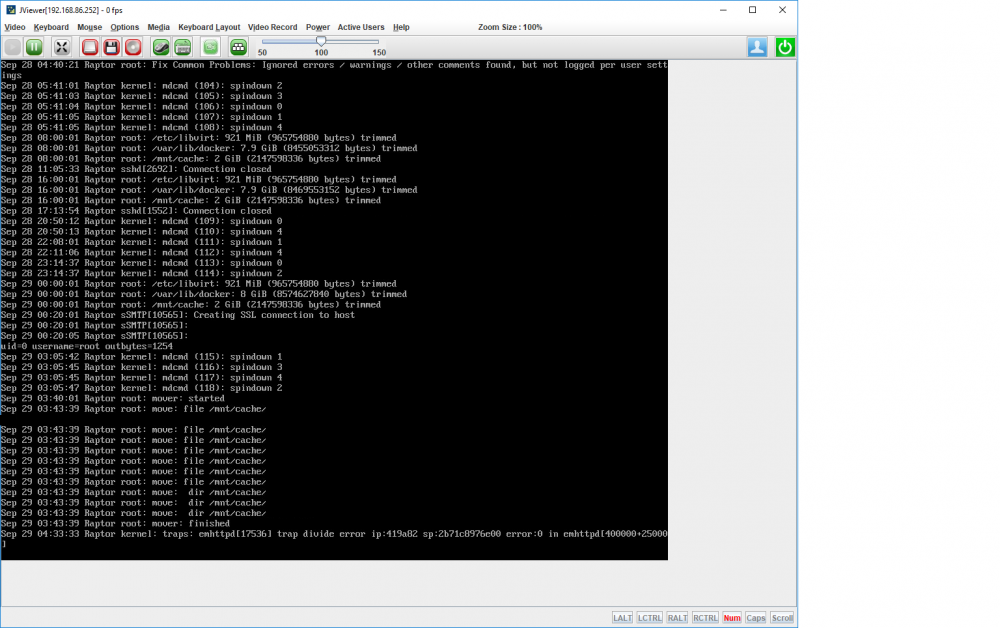

If running an RC release and you get a full system lockup where the logs are unavailable to be obtained afterwards, you'll need to hook up a monitor and keyboard to the system directly, login to the console, and type the following command:
tail /var/log/syslog -f
This will start printing out log messages to the screen locally which may reveal a kernel panic right before the hang up.  Take a photo of those messages after the system reaches this hung state and post a new topic highlighting the system crash.  Without this, we cannot research the issue further at all.
I've manually redacted some information from this, so it's not just moving `/mnt/cache` and it sent an email, etc. etc.
But the last line looks interesting to me... Not sure what it means ;) But hopefully that helps!
Rebooting now.

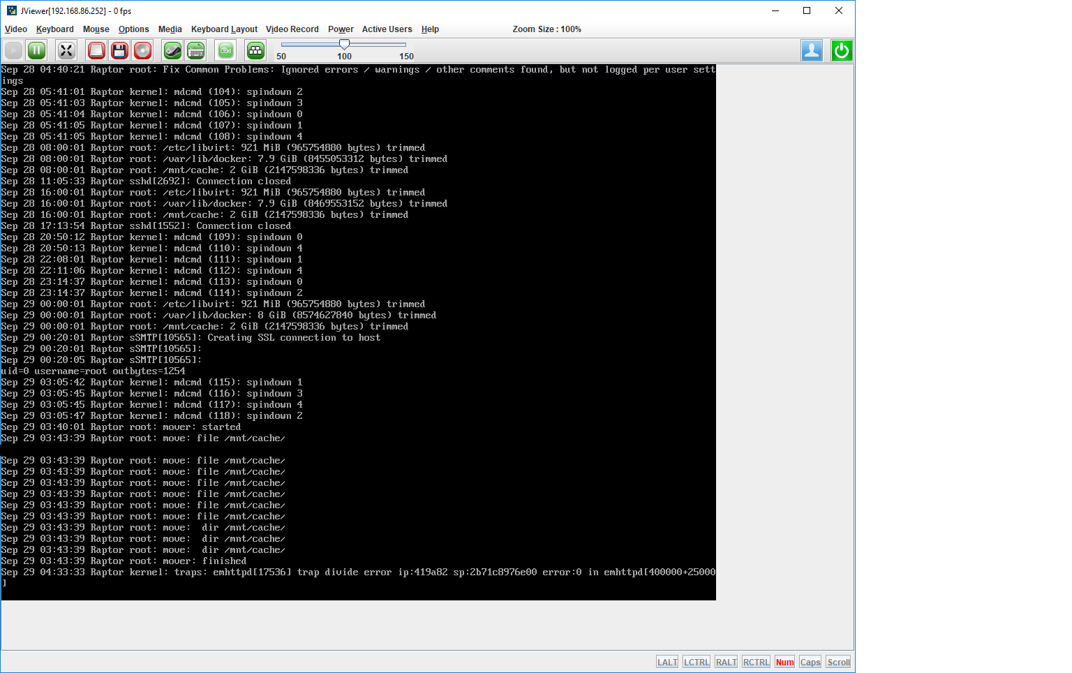

Rebooting now.
Thanks for capturing this!  I've forwarded it to Tom for review.
Cheers Jon! :) Fingers crossed it's useful for him haha
