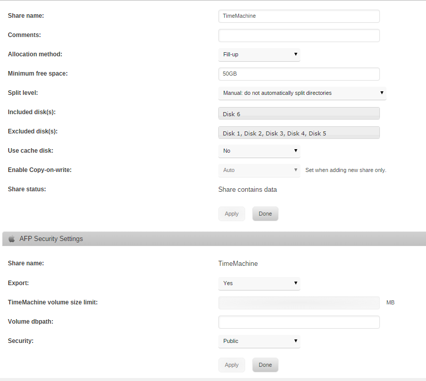

Did you enable the time machine setting in your unRAID share? I have multiple TM shares setup on my unRAID server and they all show as possible destinations in TM preferences in every Mac I have.
I enabled AFP in settings and then set the AFP to export that share.
Sent from my Nexus 5X using Tapatalk
I followed what was recommended in other form posts for setting up a TM share.
Can you post a screenshot of your AFP Security Settings for that share?

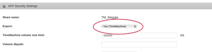

This is a shot-in-the-dark, but try changing the AFP Export setting to this-
You can set volume size limit to whatever you want (limits max size of the TM backup). Don't forget to click "apply".
I'm thinking that this may change the way that unRAID broadcasts the AFP share and hopefully after applying the changes you'll be able to see it in TM preferences (maybe :)).
I am officially a moron. The export setting was the trick. I don't recall seeing that option when I setup the share but I must have just overlooked it. Thanks so much for the help!
