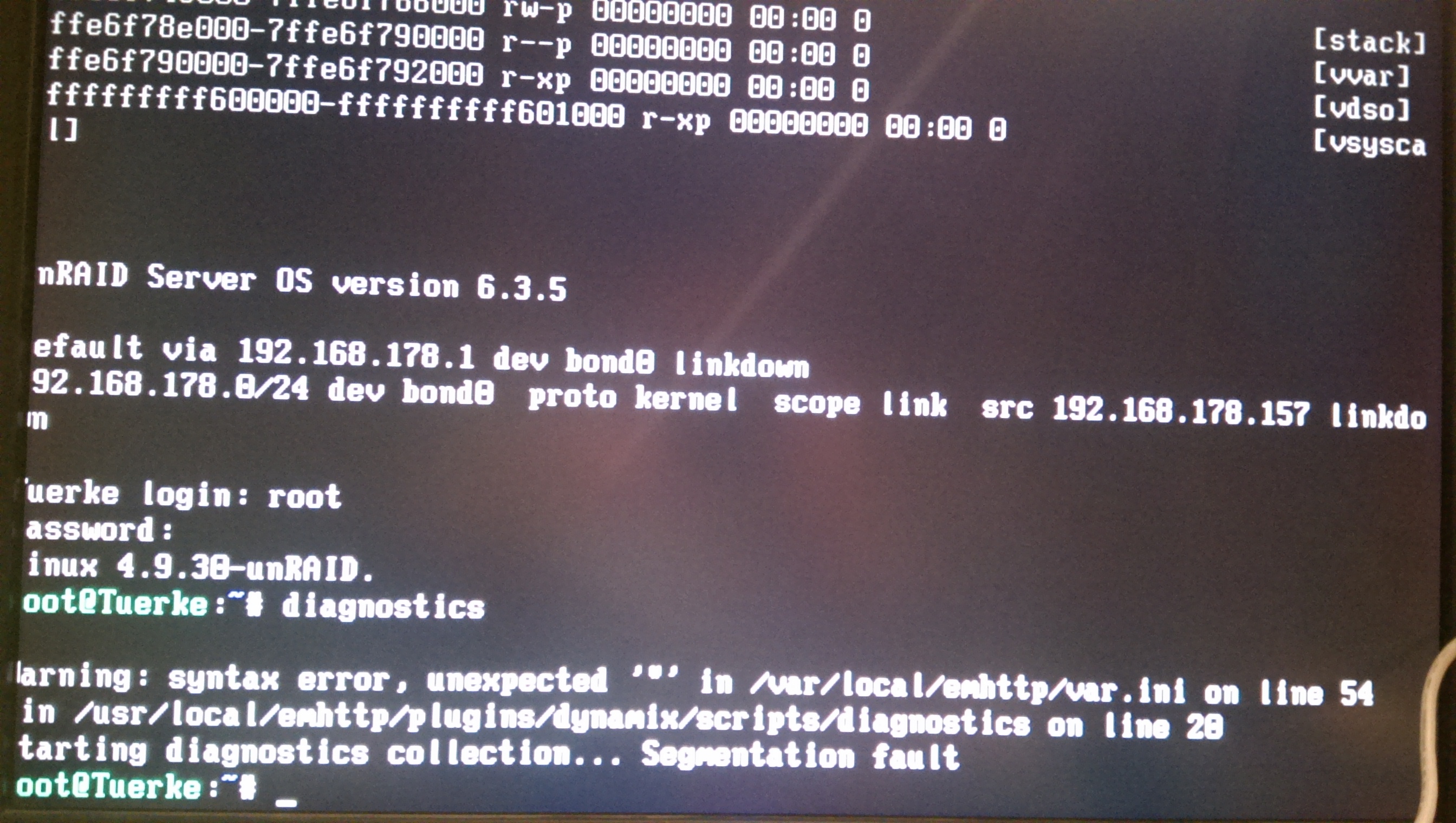

Plugged a keyboard and a screen to grab the diagnostics.
Fist issue, see attached pic. What should I do now?
The server is still running and waiting for yor input. :D
Try to at least get the syslog.
OK, got the syslog already but need to shutdown/reboot to pull it off the stick.
Anything else I should get before rebooting?
Will do a memtest afterwards.
Reboot and run memtest, rest of the diagnostics can be downloaded after.
OK, indeed a memory issue. Right after start of memtest everything came up red.
Server is up again with some other RAM and the movies play just fine.
Rebuild was successful.
