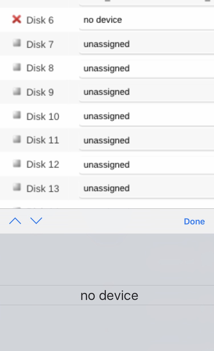

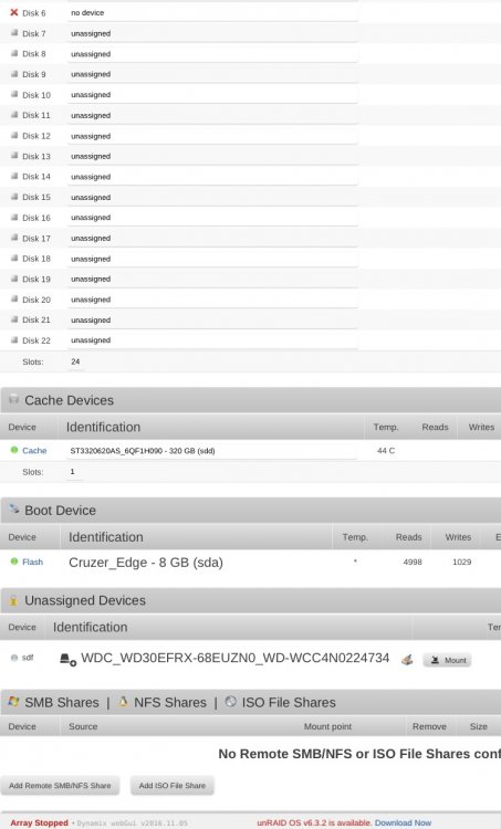

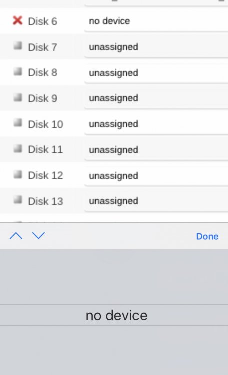

Thanks! But currently when I stop the server, the disk slot is already "no device" and I cannot assign the unassigned drive to it since it doesn't allow me to choose it. Any ideas why?
Edited by CyberMew
If the disk is already unassigned you just need to assign it and start the array to begin the rebuild.
Yea I get what you mean but it doesn't allow me to select the drive lol.
Maybe the disks dropped offline again, post new diags.

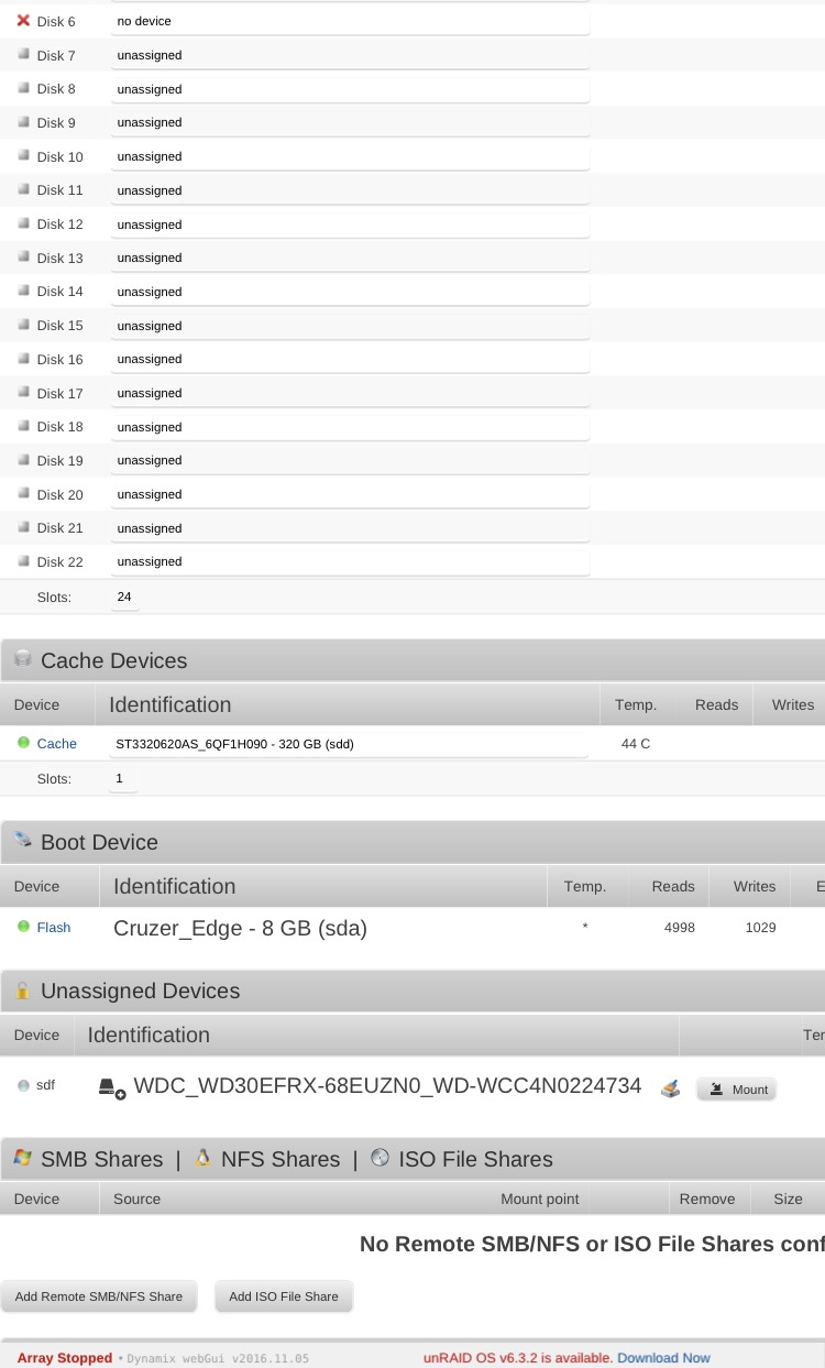

Yea but it certainly is weird because it appeared in unassigned devices. I did notice the website (tower/Main) took a short while to load though, before loading the unassigned devices section. Is the drive taking more time to be detected? I have attached the diagnostics again.
tower-diagnostics-20170925-2306.zip
Strange, disk is still online, reboot and try again (take the opportunity to update to v6.3.5)
