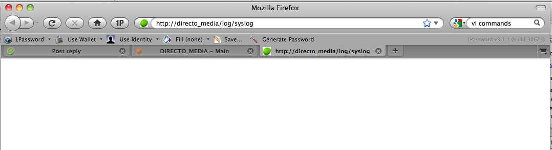

Cannot access my syslog from my browser either.  I just get a blank screen.  I just checked if I could access my flash drive from the mounted share, and I could.  I telnetted in, copied the syslog to /boot, but right after I did that, the files on the 'flash' share disappear.  After checking the flash drive manually, the file wasn't written.  Do I have a bad flash drive?

OK, the ability to get to the syslog through the browser did not get added to unRAID until the 4.5 series.  That is why it did work.

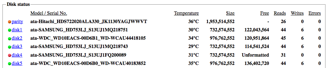

no such luck!  still showing up as unformatted...
Again, unformatted simply means not mounted.  Do not press the "Format" button.

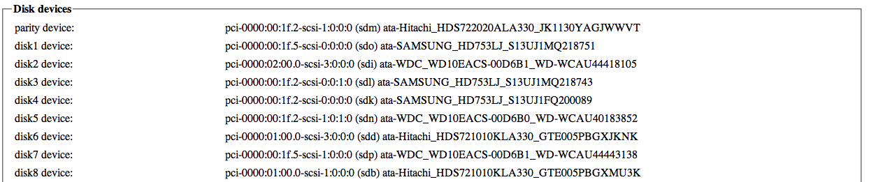

On the "devices" page, is the disk that is failing showing as "(sdk)"
I haven't touched anything :D
disk4 device: pci-0000:00:1f.2-scsi-0:0:0:0 (sdk) ata-SAMSUNG_HD753LJ_S13UJ1FQ200089
I'm also attaching a screenshot of the devices page (just the top few disks which include the problem ones)...

May 3 14:09:13 DIRECTO_MEDIA kernel: FAT: Directory bread(block 8195) failed
May 3 14:09:13 DIRECTO_MEDIA kernel: FAT: Directory bread(block 8196) failed
May 3 14:09:13 DIRECTO_MEDIA kernel: FAT: Directory bread(block 8197) failed
May 3 14:09:13 DIRECTO_MEDIA kernel: FAT: Directory bread(block 8198) failed
May 3 14:09:13 DIRECTO_MEDIA kernel: FAT: Directory bread(block 8199) failed
May 3 14:09:13 DIRECTO_MEDIA kernel: FAT: Directory bread(block 8192) failed
May 3 14:09:13 DIRECTO_MEDIA kernel: FAT: Directory bread(block 8193) failed
May 3 14:09:13 DIRECTO_MEDIA kernel: FAT: Directory bread(block 8194) failed
May 3 14:09:13 DIRECTO_MEDIA kernel: FAT: FAT read failed (blocknr 4298)
May 3 14:09:17 DIRECTO_MEDIA kernel: FAT: FAT read failed (blocknr 4298)
May 3 14:10:44 DIRECTO_MEDIA last message repeated 5 times
May 3 14:10:55 DIRECTO_MEDIA last message repeated 7 times
May 3 14:11:09 DIRECTO_MEDIA kernel: FAT: Directory bread(block 8496) failed
May 3 14:11:09 DIRECTO_MEDIA kernel: FAT: Directory bread(block 8497) failed
May 3 14:11:09 DIRECTO_MEDIA kernel: FAT: Directory bread(block 8498) failed
May 3 14:11:09 DIRECTO_MEDIA kernel: FAT: Directory bread(block 8499) failed
May 3 14:11:09 DIRECTO_MEDIA kernel: FAT: Directory bread(block 8500) failed
May 3 14:11:09 DIRECTO_MEDIA kernel: FAT: Directory bread(block 8501) failed
May 3 14:11:09 DIRECTO_MEDIA kernel: FAT: Directory bread(block 8502) failed
May 3 14:11:09 DIRECTO_MEDIA kernel: FAT: Directory bread(block 8503) failed
May 3 14:11:09 DIRECTO_MEDIA emhttp: get_config_idx: fopen /boot/config/network.cfg: No such file or directory - assigning defaults
May 3 14:11:11 DIRECTO_MEDIA kernel: FAT: FAT read failed (blocknr 4298)
May 3 14:11:42 DIRECTO_MEDIA last message repeated 42 times
May 3 14:12:44 DIRECTO_MEDIA last message repeated 22 times
May 3 14:12:44 DIRECTO_MEDIA last message repeated 3 times
May 3 14:13:27 DIRECTO_MEDIA ntpd[1466]: synchronized to 209.167.68.100, stratum 2
May 3 14:14:25 DIRECTO_MEDIA kernel: FAT: FAT read failed (blocknr 4298)
We have to ask, what in the world would the two errors have in common?
You said earlier you checked the flash drive for errors and it checked fine.  You ran memtest overnight, and it tested fine.
The only thing in common with all this, other than the memory, is the power supply, cpu, and motherboard.
So, one thing at a time.  You have 2 gig of ram, can you try booting with just one RAM strip? and then with just the other?
You have a lot of disks, what power supply are you using?  Is it possible it is at its limits?
Joe L.
I will try the swapping the RAM later tonight or on the weekend.
I'm using a Corsair HX620W.  I will have to see if that's enough juice...
