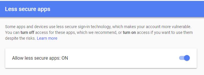

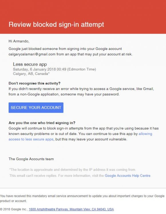

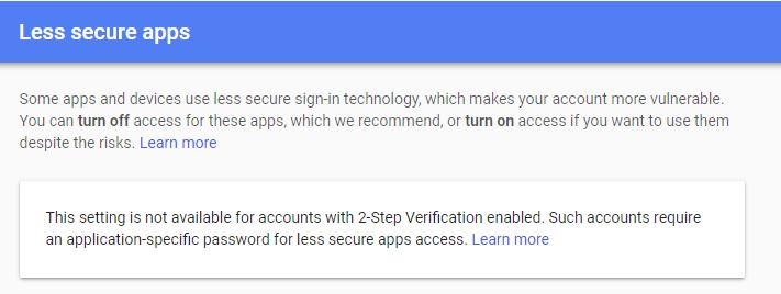

January 6, 20188 yr I had another complete different issue with GMail: After much checking and double checking my user name and password and some head scratching it turns out Google considers unRAID a "Less Secure APP" and automatically blocks it! (See pic 1.jpg) You can turn off this feature with GMail but there's a hitch: You cannot use GMail with 2 factor security login - OK, reasonable... (See pic 2.jpg & 3.jpg) Google considers both regular GMail and GMail with TLS preset services to be "Less Secure Apps" from my test. Just a heads up everyone. 1 Edited January 6, 20188 yr by Calamari
