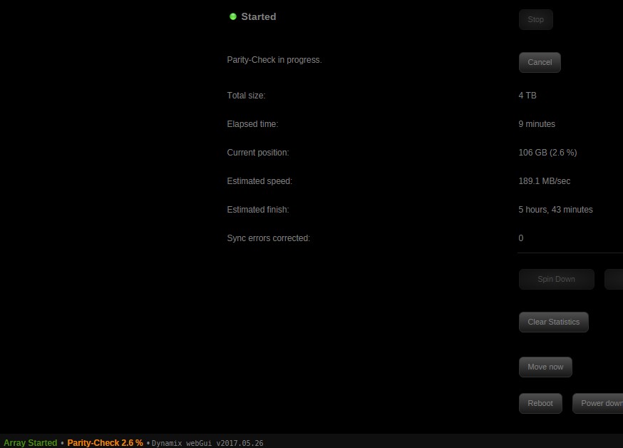

After a shutdown, added a new HDD my unRaid server and enabled "Intel VT-D Tech" in BIOS it won't start my array. It freezes/restarts when it does a Parity-Check for around 10min.
I ran a Pre-Clear on the new HDD for 1h and that worked.
I can start the array in Maintenance Mode but as soon as I run a Parity-Check it freezes/restarts.
It doesn't matter if I start unRaid in Safe Mode or not.
Any advice?

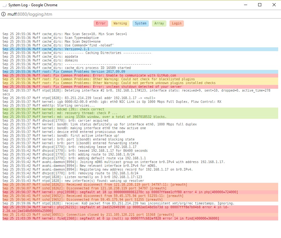

It sep 25 22:50 and the last entry in the Log was:

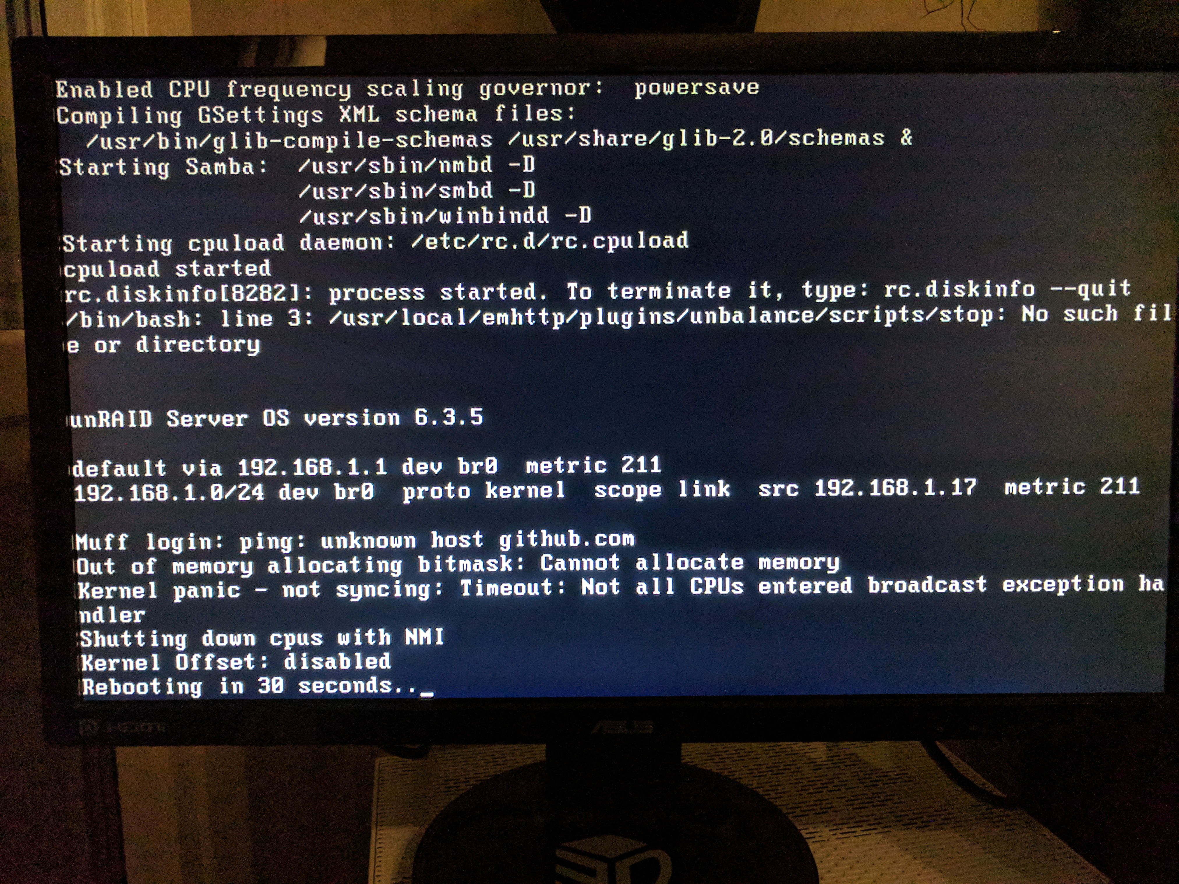

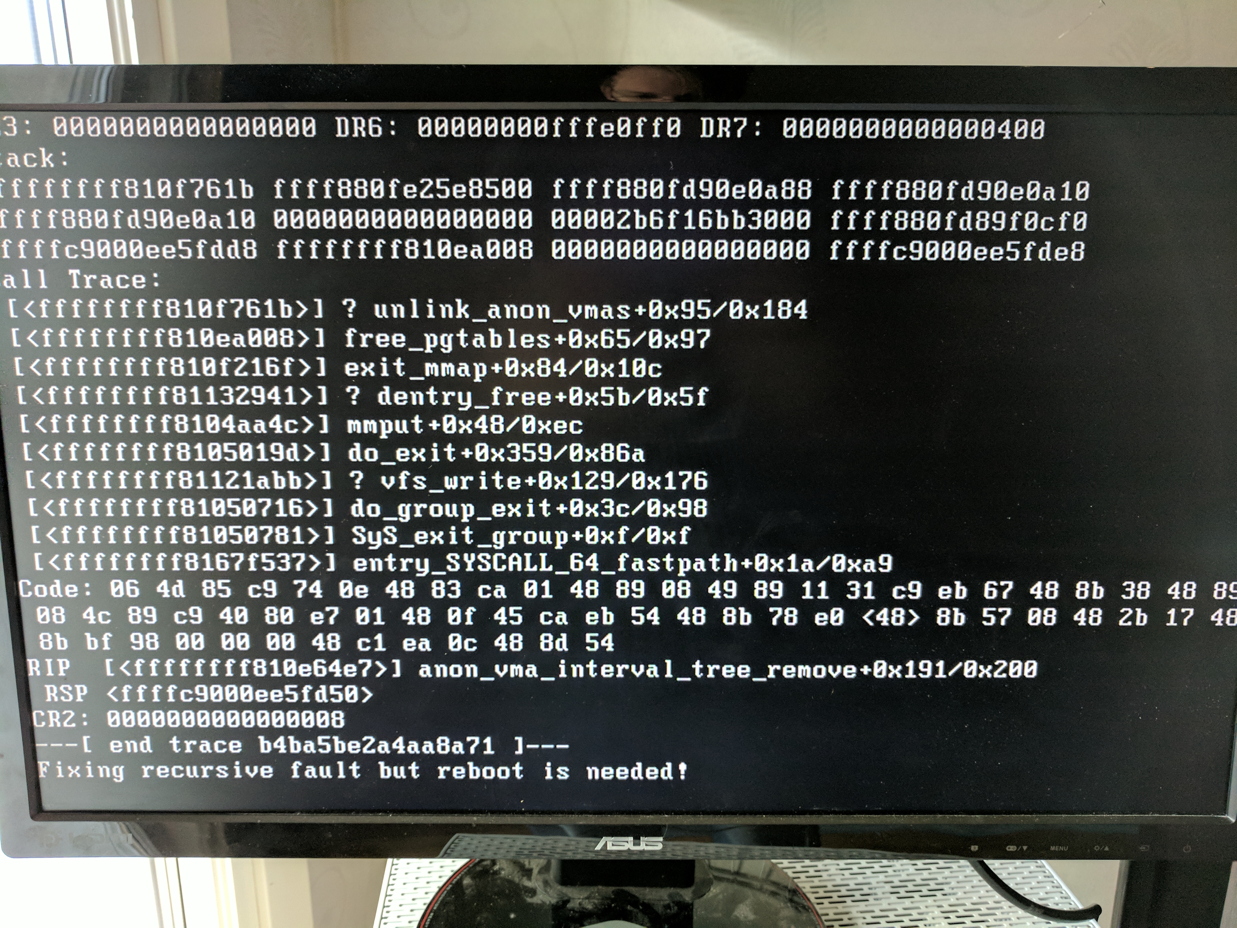

I'm thinking of leaving it under the night.
This is what I got in the morning:
I've made a ticket to the unRaid support
