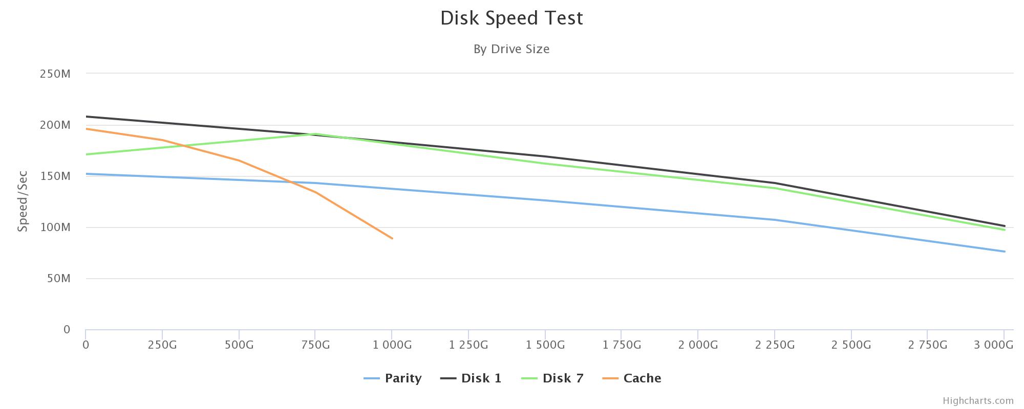

No current HDD can exceed SATA2 speeds during sustained transfers, speeds are mostly a result of the disk's rpms and number of plates, search for the diskspeed plugin, it will give you a graphical display of your disks speeds.

Interesting results (especially the Cache drive drop off!)
Thanks for your time, I am changing my Parity to one of the Toshiba's now...
