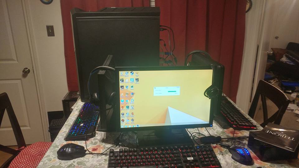

Tried countless times about 7-8 months ago where i was running into an issue with windows updates completely ruining windows 7 and 8.1 VM's.  eventually i gave up on it.  figured i'd give it another go after the software had more time to mature.  i have run into less errors and less problems this time around.  whichever dev.  fixed this issue, i salute you good sir.

well just for grins and giggles i thought i would try just choosing the videocard on a new VM and starting it up.  its working-ish.  it still shows remnants of the GUI.  its really weird.  i see the boot time in the upper right and that the array is started in the lower left.  but everything else is what is viewed from the VM.

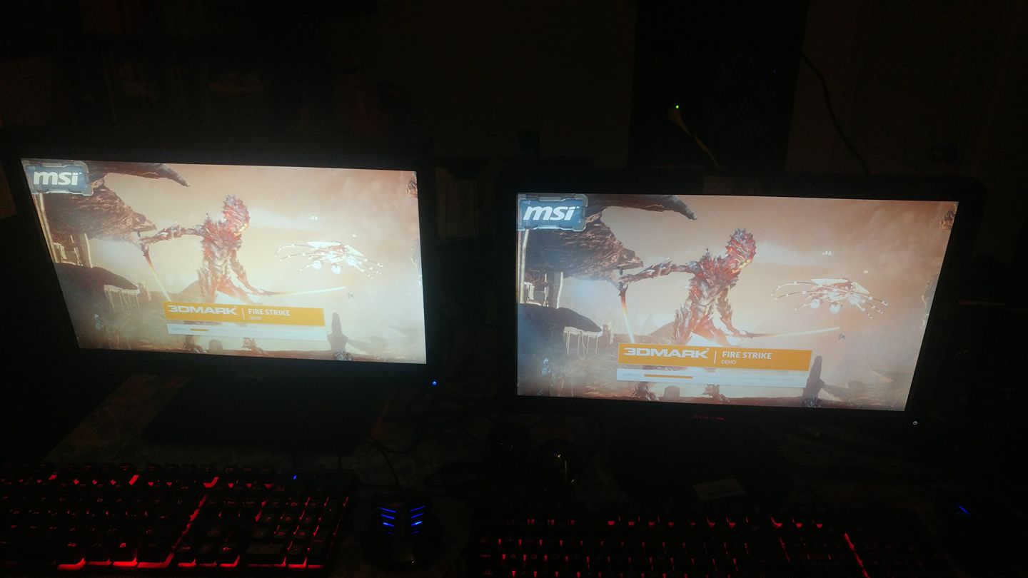

well it appears to be working correctly.  once i set up automatic VM startup the artifacting of the GUI is gone.  now the weird thing im running into is benchmarking.  im trying to run 3d mark on both VM's.  it appears that either 1 or the other fails upon starting up of 3dmark.
any advice on that?
just retried it a couple more times.  seems its a luck of the draw if systeminfo from 3dmark causes a VM crash or not.

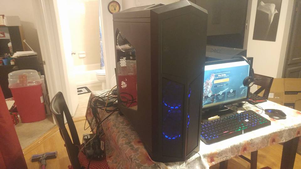

yeah the ghosting went away when i stopped booting unraid into GUI mode.  now it runs headless and doesnt effect the VM.
