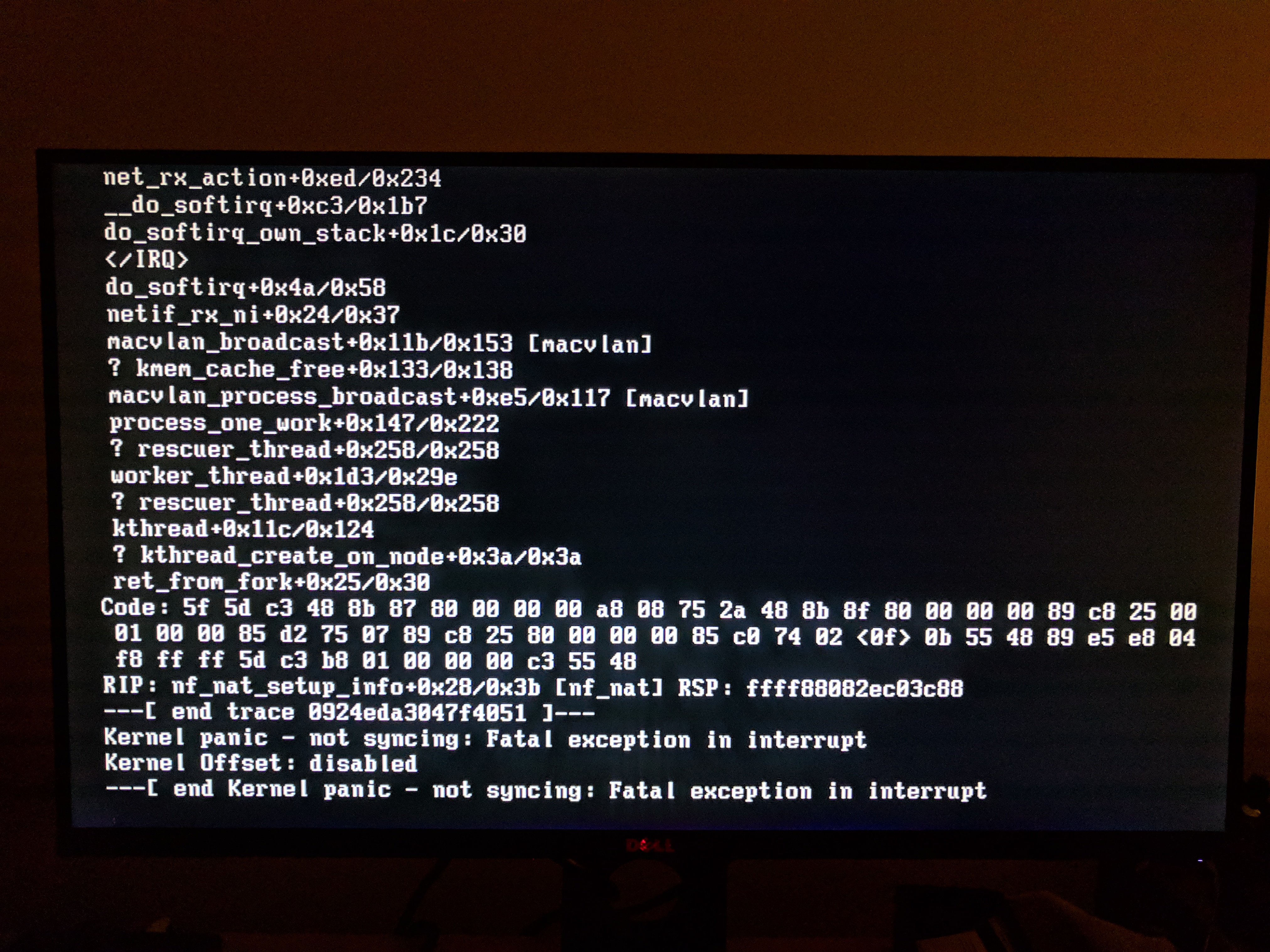

October 27, 20178 yr this is my 6th or so KP with the 6.4 series, finally got something captured from console. Edited October 27, 20178 yr by Dephcon

November 4, 20178 yr I went 30 days without a crash running on RC9, updated to 10, waited a few days and then turned on bridging for one of my dockers (plex) instead of host mode. It ran for about a day, then crashed shortly after applying an update to the docker this morning. Earlier in the beta I had been running bridge mode on all of Dockers and would crash constantly. I have disabled this mode again and will advise if another crash occurs. I hope this helps.
