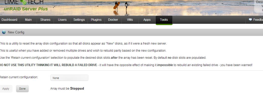

September 27, 20179 yr Community Expert 10 minutes ago, neuk34 said: I had a red bullet on my disk 8 You should have mentioned this in the first post. 11 minutes ago, neuk34 said: from 06/2017, but I left it like that because it was working. And should have fixed this ASAP, not let the array work degraded for months, disk8 is full of pending sectors and needs to be replaced. Depending on if anything changed or not in the array you may still be able to recover the missing data, follow these steps carefully, any doubt ask before doing it: -Tools -> New Config -> Retain current configuration: All -> Apply -assign any missing disks, check that all disks are assigned, including parity and old disk8-check both "parity is already valid" and "maintenance mode" before starting the array -start the array -stop array, unassign disk8 -start array, check emulated disk mounts and contents look correct, i.e., missing data is there If it works copy the data from the emulated disk or better yet get a new disk to replace old disk8. PS: You need to improve disk cooling, all your disk have reached between 55 and 60C in the past, that's way to hot, ideally they should never go above 40C, 45 tops.
September 27, 20179 yr Author Quote Tools -> New Config -> Retain current configuration: All -> Apply retain current configuration is grey. cannot change anything. it's just written None.

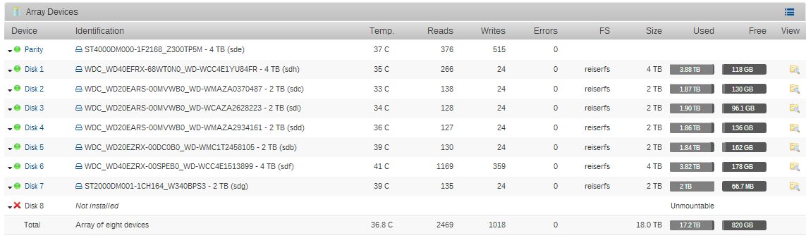

September 27, 20179 yr Author Quote -Tools -> New Config -> Retain current configuration: All -> Apply -assign any missing disks, check that all disks are assigned, including parity and old disk8 -check both "parity is already valid" and "maintenance mode" before starting the array -start the array -stop array, unassign disk8 OK, done. see picture. Quote start array, check emulated disk mounts and contents look correct, i.e., missing data is there content is worst. it miss more files than before. Quote if it works copy the data from the emulated disk or better yet get a new disk to replace old disk8. It didn't work. Content is not emulated. What should I do now? Thank for your help.

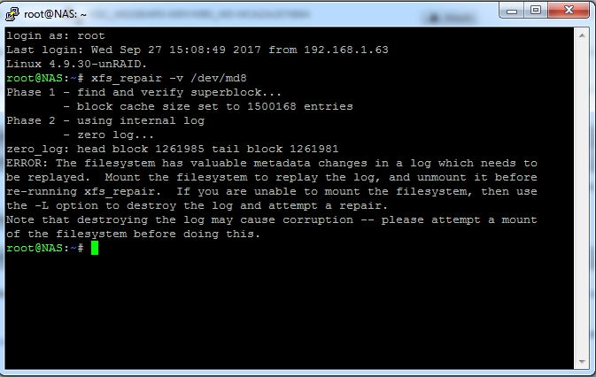

September 27, 20179 yr Community Expert Stop the array, start the array in maintenance mode (you need to check that box before starting). Then on the console or SSH type: xfs_repair -v /dev/md8 Post the output
