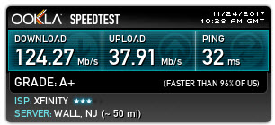

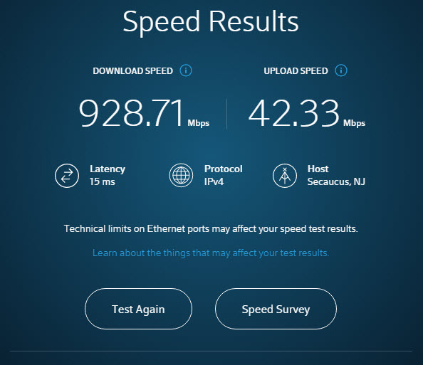

But the speeds I get are just 200-300Mbs speeds, while my other machines (bare metal) on my network are pulling 900Mbs on a consistent level with the speedtest. When the speedtest happens, is it writing the file to the array or just the cache drive? I have attached a diagnostics as requested. Maybe someone can see something I do not. Thanks for helping out.
P.S. I also installed the command line speedtest and the same results. Example....

Thanks for replying. Hard to get the time to get to all the forums. Anyway, it seems my duplex on my card is at 1000 according to my dmesg log.
[   32.037340] e1000e: eth0 NIC Link is Up 1000 Mbps Full Duplex, Flow Control: Rx/Tx

Office desktop.
And then there's unraid. Getting slower each day for no apparent reason. Has to be 'the ghost in the machine' here. I have concluded the internal wiring is good. I have eliminated the Asus router completely and hooked right into the cable modem, which is a gateway itself in bridge mode. Same results. Only test I have not done (for whatever reason) was plug the unraid server directly into the modem. Hey, if my other computers can get 900+Mbps consistently so should my unraid box. If anyone here has 1Gbit service with Xfinity what does your unraid download speed top off at? Love to compare and see what you have or don't have. Happy late Thanksgiving. Hope everyone had a safe time!
Office Desktop
