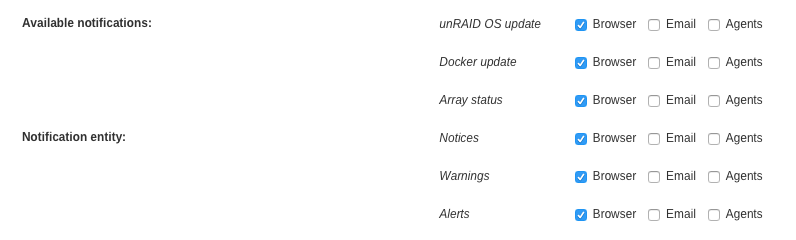

The thing is, I don't have email notifications configured as I keep a browser window open on the GUI and all six types of notification are set to Browser only. The SMTP settings are unconfigured. By that, I mean I haven't changed anything from the defaults. This wasn't a problem with 6.3.5 but with the rcs it seems the system is trying and obviously failing to initiate a secure SMTP transaction with Gmail's server. How do I stop this, please?

Have you looked at the 'Notifications settings' under the 'Notification' page on the 'Settings' tab and make sure that you don't have any of the "E mail" boxes ticked on the bottom?

Thanks for your reply, Frank. Yes. I believe I said so in my OP.
Here's a screenshot:

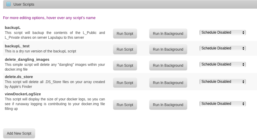

So, root is the only user with a crontab. The one that runs daily at 04:30 is /etc/cron.daily, which contains exportrotate, logrotate and user.script.start.daily.sh. The latter looks like the likely culprit. However, the User Scripts plugin's Settings page shows that all schedules are disabled:
Nevertheless, I'll remove the plugin and see what happens at 04:30 tomorrow morning.
