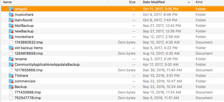

I still notice, btw, that if I do a direct mount to disk2 via Mac OS the folders have 'no permission' icons on them.  This is not the case for direct access to other disks.  Do I still need to do any sort of permission repair or rebuild?

I am now able to mount shares successfully.  However, when I attempt to mount a disk directly, i.e. smb://10.0.0.x/disk2 I get the 'no permissions' icons.  I could be mistaken, but in the past I believe I was able to mount volumes this way?  Is this not correct?  If not, then I can attempt the process of moving over files from the temp folder i created on disk2 over to the appropriate folders via Midnight Commander or the CLI.  I would prefer to do it via GUI, but it's not a requirement.  Diags posted.  These were from after rebooting unRAID but before starting the array.  Also, a screenshot of the 'no permissions' mount.  Thanks.
Yes, as long as disk shares are enable, though I don't regularly use OSX so I'm not familiar with that no permissions error, go to the shares page and check if settings are correct for the disk shares.
