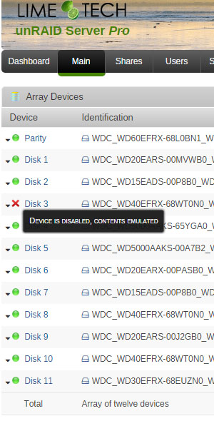

So this all started on Sept 23rd when I was away and disk 3 failed (the server was frozen). Upon reboot I had disk 3 (WD 4TB RED) showing "Device is disabled, content emulated"

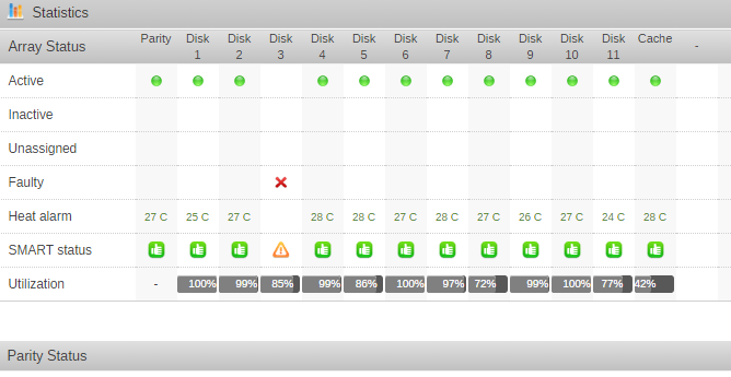

During the copy I found 'taracopy' say network device (unraid) unassailable. I went back to the WebGUI and refreshed and then saw another error on Disk 3
The device had a RED X and I checked out the Dashboard, and it was also FAILING S.M.A.R.T.
I checked the .log file and there is a ton of write/sector errors.

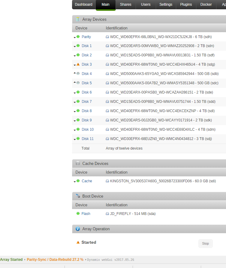

Replacement disk installed.
Start will start Parity-Sync and/or Data-Rebuild.
Yes I want to do this
I am doing this now, it is going to take a good 20 hours
I started this process, and DISK3 has a orange triangle next to it. Saying...  device contents emulated
Also, this disk is NO LONGER plugged into the SuperMicro SAS card, rather the Marvell on-board SATA port / chipset
I have also posted NEW syslog.txt for any other info that may be needed
syslog.txt
Edited by bombz
This is normal

Currently
Parity-Sync / Data-Rebuild 18.5 %

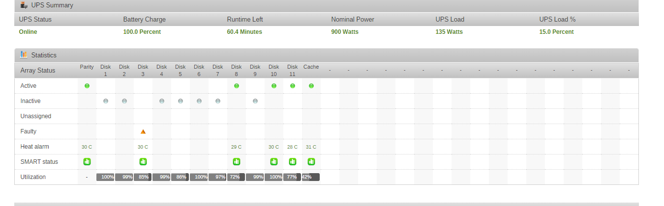

New screen
64% complete rebuild/sync
