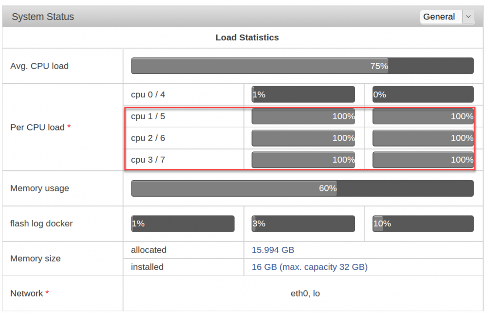

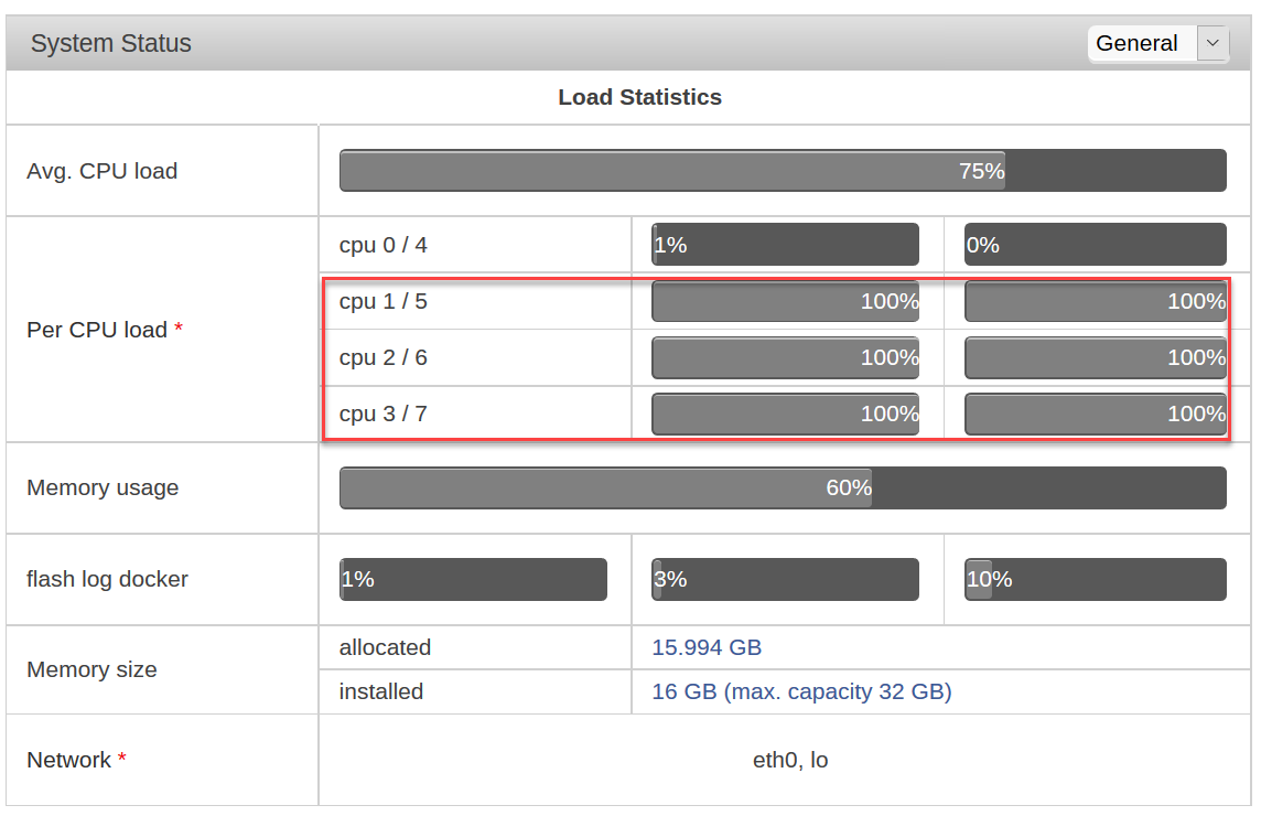

The strange thing is that it is very likely the Windows VM start-up will be hanging in the windows logo, and the CPUs assigned to VM just stay with 100% utilization.

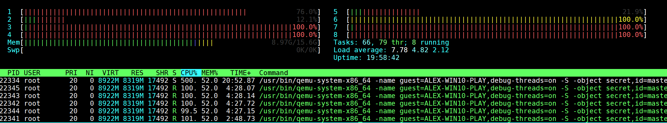

In ssh, htop I can see the CPU are used by qemu-system-x86_64 KVM processes.

How I work around the issue:
Just like the instruction or video said, windows VM might be not able to boot when doing the installation. Change to one core sovles the problem.
For me, I just reduce the cores (threads) from 3/6 to 2/4 or 1/2 then VM can boot without any problem.
Once it is started, if I changed the VM configuration back to 3/6, sometimes it works, but most of time it doesn't boot.
