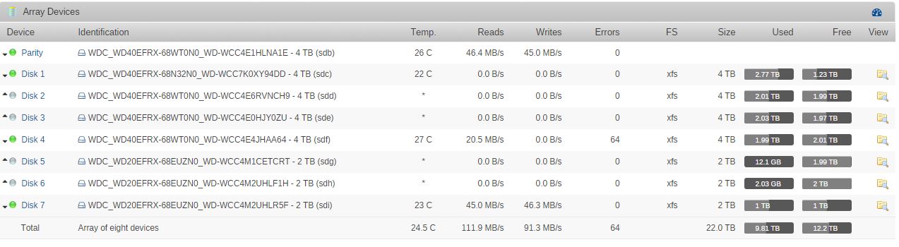

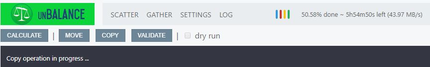

Okay, I'm in the process of copying data from the faulty disk to a new disk, and I think i'm getting som really slow speeds.
Is it normal speeds i'm seeing in the pictures ?
I'm copying from disk 4 to disk 7.
I can't help but think that something is terrible wrong in my unraid setup, the disks have all been tested using disk speed plugin a while back, and there i got teses speeds.

Looks about right, it should be a little faster with turbo write enable.

Well so far it is not even moving frm an emulated disk, i'm acutally copying from the faulty disk.
The disk isn't totally crashed, and to be honest, i'm not even sure it IS faulty.
It showed up with 64 write errors, and when I try to run an extended smart test, it fails.
The disk has som Raw read error rate fails, so I guess it is time to RMA it, if just I can find out where I bought it.

There's a read failure during the extended SMART test so it's a disk problem.
When I said the speeds are normal before I was aware you were copying from the actual disk.
