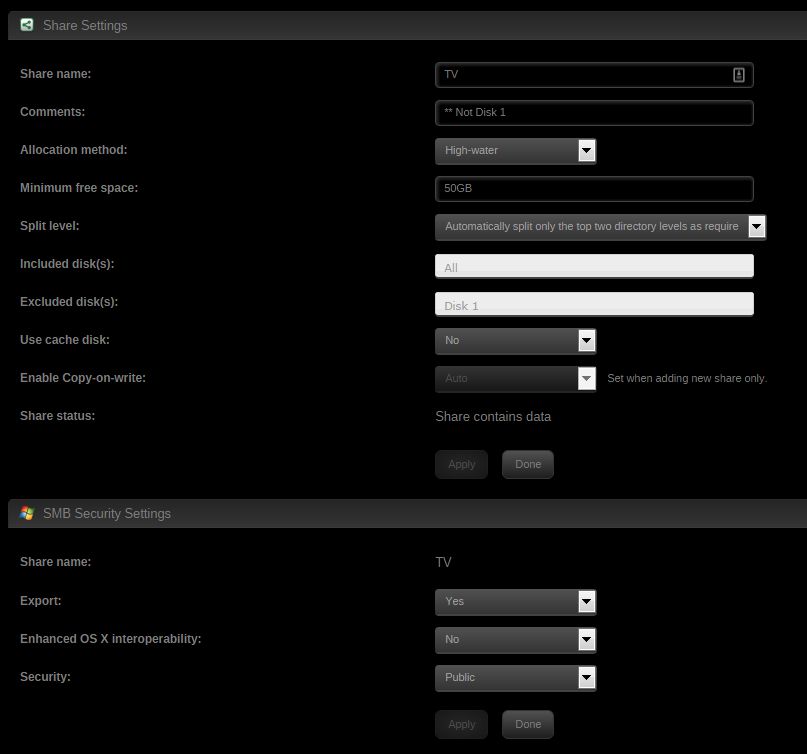

My share setup, attached, is for review.  Seems sane to me!
Kev.

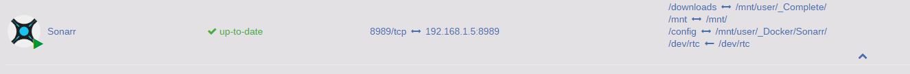

I am.  Here are my specific docker maps:
All my internal Sonarr TV paths are then accessed via /mnt/user/TV, /mnt/user TV (Kids), etc. which are the unRaid shares across my array.

It's because of mount points.  Any OS when moving a file will look to see if the source and destination are on the same mount point (in your case /mnt) since that's what you mapped to the container.  If they are then it'll just renames the file to the new location instead of a copy and delete operation.   Net result is that your file winds up on the cache drive in violation of the rules.
Solution is to map another path of /tv mapped to /mnt/user/tv and have sonarr move the files to /tv instead
This makes sense.  I have just mapped my two folders into docker and have re-pointed all my tv libraries to the mountpoints inside the root of Sonarr.  I think now that this was some kind of limitation from way back when I first started Sonarr and I never bothered to change it or even think of this.
This should fix it nicely...TY for making me see the obvious!  Fingers crossed it will work now!
