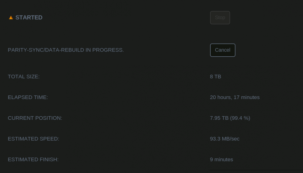

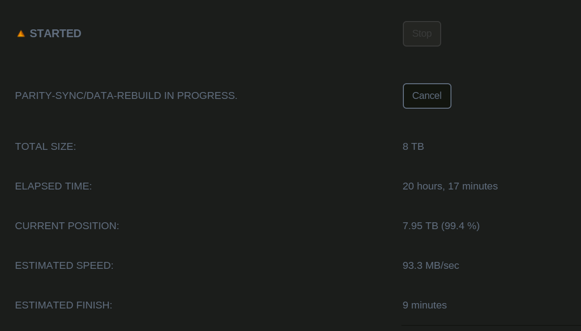

Looks good?
PARITY-SYNC/DATA-REBUILD IN PROGRESS. Cancel will stop Parity-Sync/Data-Rebuild.
WARNING: canceling may leave the array unprotected!
TOTAL SIZE: 8 TB
ELAPSED TIME: 7 minutes
CURRENT POSITION: 53.7 GB (0.7 %)
ESTIMATED SPEED: 123.7 MB/sec
ESTIMATED FINISH: 17 hours, 51 minutes

FYI: 5 PLEX streams going adds some major hours!
Completed and disk returned to normal operations.
