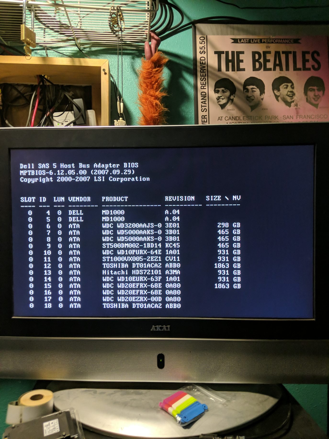

January 9, 20206 yr Hello, I'm not sure if this is the correct place to ask for help, but I am out of Ideas. I'm running Unraid plus 6.8.0 on a R710. I just picked up a MD1000 . I see the device and the drives in Dell Bios ctrl-c to get to setup, highlight Bios and OS and reboot. I see the R710 search for drive, it finds them, then loads Unraid. I expect to see the drives in Unassigned devices but no Joy. I've attached the diagnosis Any suggestion is appreciated. Chas tower-diagnostics-20200108-1654.zip
January 9, 20206 yr Not seeing anything out of the ordinary on the log, is the MD1000 connected to the same Perc controller as the other disks?
January 9, 20206 yr No, the MD1000 is connected to a SAS 5/E. I see the controller load in Bios, search for drives and find them. The Odd part is that I have a R410 with the same setup that sees a MD1000 fine. That is what has me at a loss. Chas

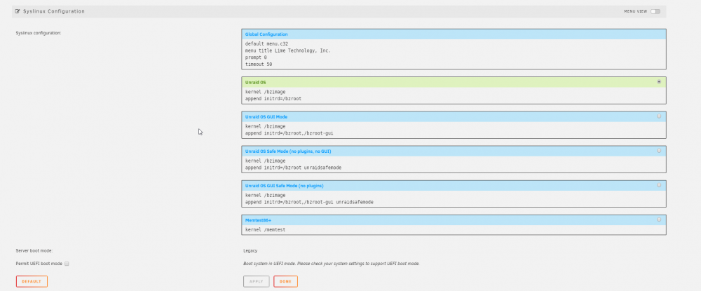

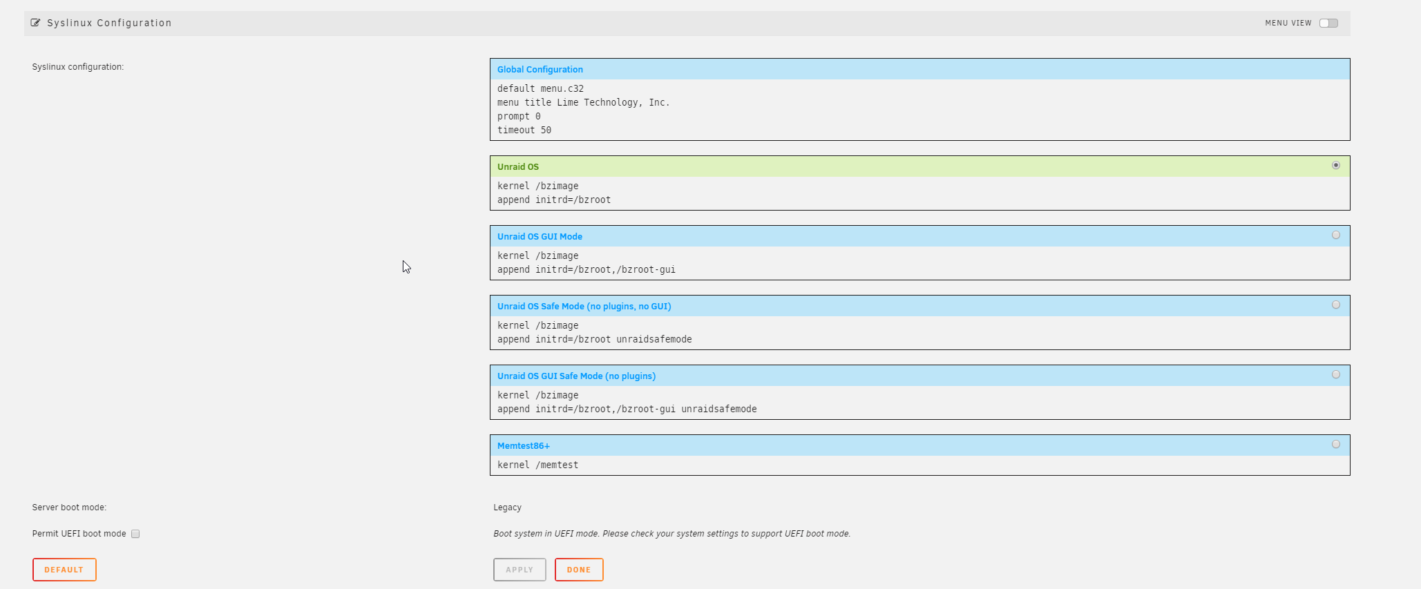

January 9, 20206 yr On the main GUI page click on cache and scroll down to "Syslinux Configuration", look for "append" and remove 1000:0054 from the boot command.
January 9, 20206 yr 7 minutes ago, kysdaddy said: Please pardon my ignorance. I do not know what to do with the information that you just provided? Did you attempt to PCIe stubbing any device in the past? It could be that you used the file method and the controller is in the same IOMMU group as the other intentionally stubbed device (probably your GPU). Unraid will try to stub everything in the same IOMMU group, which affected your controller without your realising it. If you used the syslinux method then follow Jonnie advice (click on Flash then scroll down to the syslinux section).
January 9, 20206 yr Gentleman, Thank you so much! Unraid now sees the drives and I am off to the races! Chas
