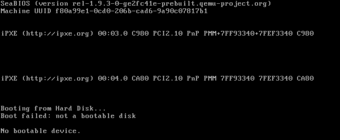

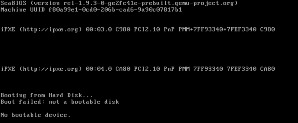

ok, so i rebooted my Unraid server (not for the first time, more like 3rd time), and my ubuntu VM says that the img is no longer bootable? but the .img is still there.
i can not figure out how to fix it to get it to boot again
i cant think of any steps to take to try to fix it
Without more information, we won't be able to help.  First we need your system diagnostics which can be obtained from the Tools > Diagnostics page.  Second, please take and post a screenshot of the exact error message(s) you are receiving.

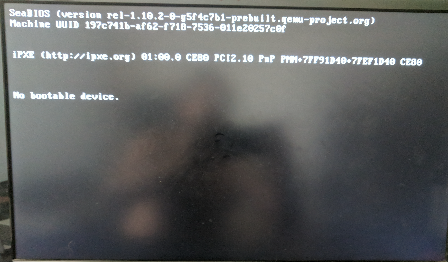

So I've just run into a similar issue after newly passing through a USB controller. I followed SpaceInvaderOne's video to do this but when I passed it through an already working Ubuntu VM I got a similar message, see attached.
My solution was to switch from USB3.0 to USB2.0 which allowed me to boot and then I tried USB3.0 again and it worked.
I've also attached the VM's XML for both the working 2.0 and 3.0 setups if they make a difference.
Hope this helps!
