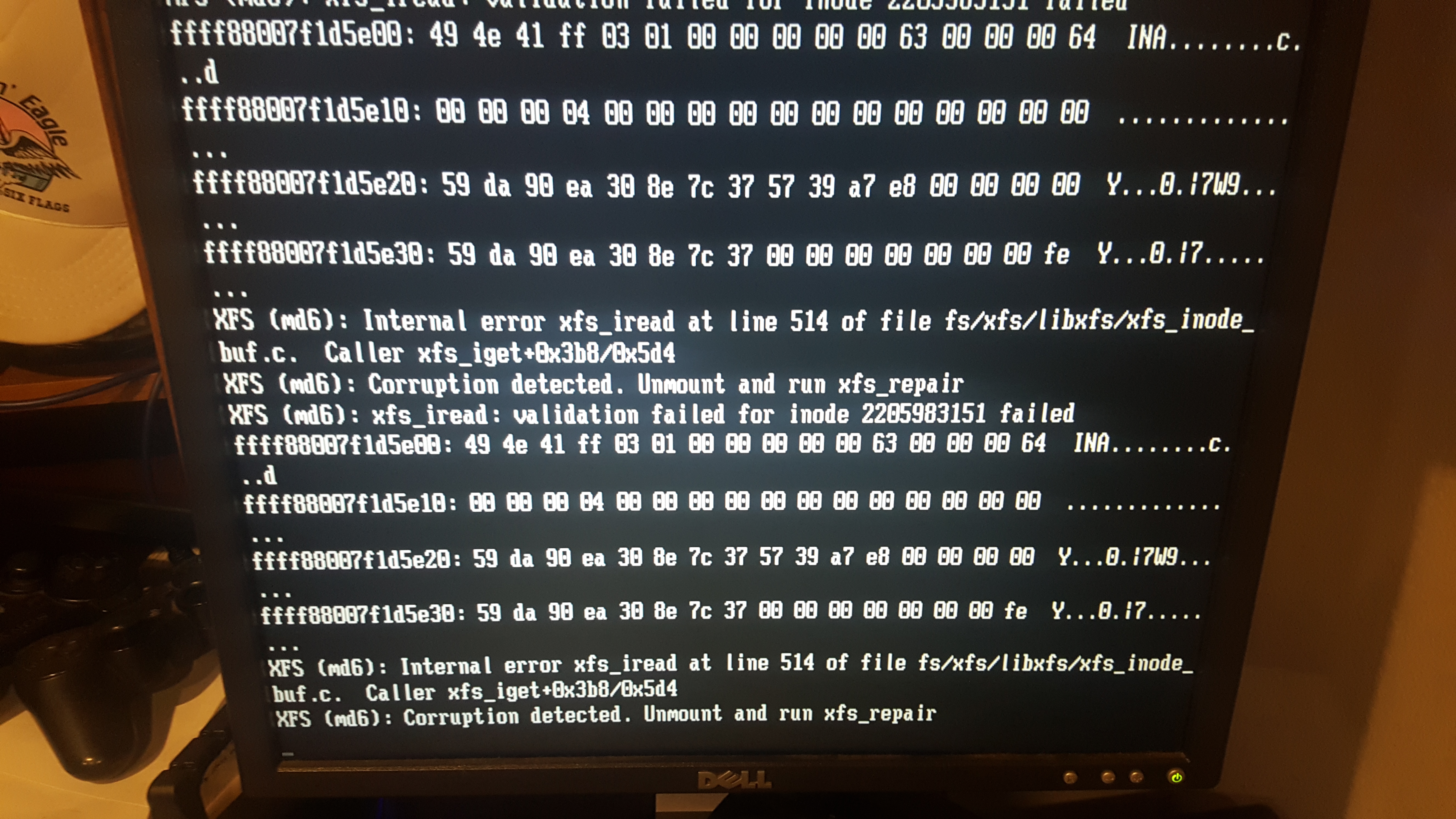

I noticed this error pop up on the monitor while the system was running. I'm wondering if this has something to do with the server crashing?
Most likely a consequence of the server crashing, you need to check filesystem on disk6:

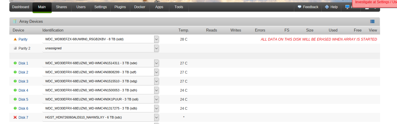

It seems like I can't win with this lately. Now I have lost Disk 7 for whatever reason.  Earlier today the array went crazy and did not respond to either the web GUI or telnet (monitor was just scrolling through text). So I had to do a physical reset.
I powered the system back on and disk 7 was missing. I powered off, and checked all the connections and powered back on. Disk 7 was found but it is now telling me that the contents are emulated and the device is disabled. This seems extra precarious because the parity was not built because of it crashing every time before it would finish. Am I SOL with the data that was on this drive?
This also begs the question if the PCI-express controller is the culprit as the last two drives are the ones being controlled by this causing the Pata issue.
unraid-diagnostics-20171015-1629.zip
unraid-syslog-20171015-1631.zip
Edited by SuperNotSupper
Assuming nothing was written to disk7 after being disabled, you can do a new config and re-sync parity, before that replace disk7 cables to rule them out.
