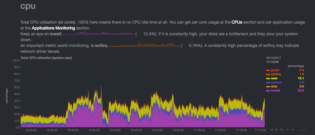

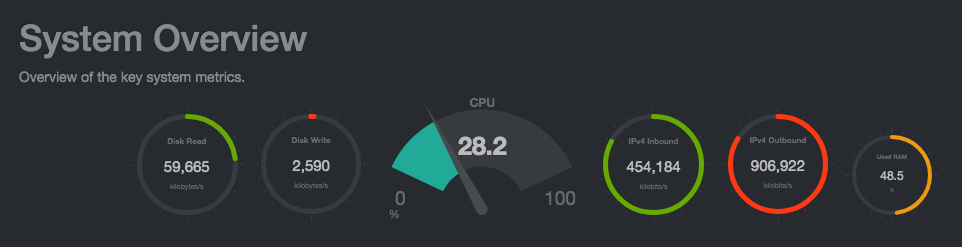

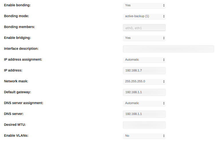

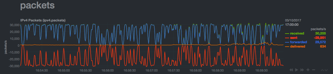

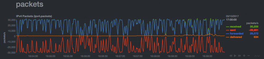

October 3, 20179 yr Hi, I'm struggling with high iowait during times when I'm downloading with NZBget and then extracted files are moved with Radarr/Sonarr. When viewing Netdata the interrupts are somehow coming from eth0: IPv4 outbound is practically at full capacity (its jumping up and down). Now, I dont know what is supposedly going through eth0. I'm at a 500mbit connection, and this data is not going to my switch so it must be internal in the Unraid server somehow. Is data between Dockers moved through network? See how sent and recieved/forwarded are following eachother? My network settings in Unraid: Any idea what is causing these interrupts/ipv4 outbound traffic and if I can do anything with it? Id really like to reduce the iowait Thanks!

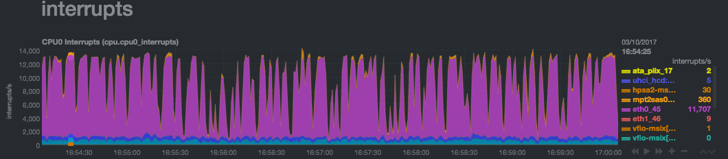

October 3, 20179 yr Author Following up with some more info: The problematic interrupts I'm seeing are all going to CPU0, which is basically drowning this core. I'm attaching my interrupts. When I'm searching for this problem it seems to be related to Linux kernel version, and I know the version used by 6.3.5 which I'm running is not the best for my Proliant. I could try downgrading to version 6.2.4 which I know to work. How do I downgrade? Get another flash and set it up with 6.2.4 and then just switch to test it out during the trial? Interrupts.xlsx

October 14, 20179 yr Author I get that the ipv4 reporting in netdata can be confusing here as it somehow also includes statistics coming from the docker-container-nics. Is this normal? As both containers (ie radarr/sonarr and nzbget) has access to /mnt/user/Downloads I don't understand why any data is going outbound ipv4.
