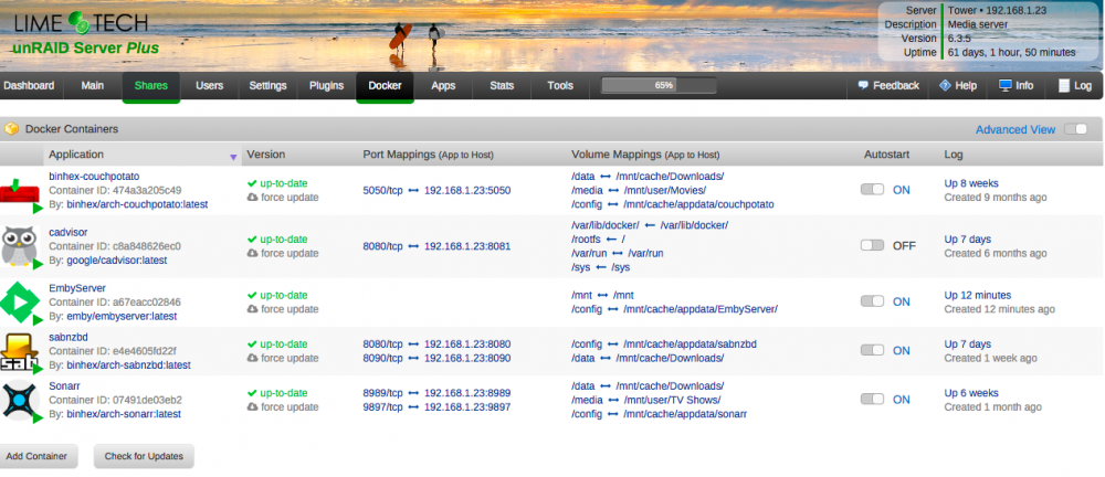

I've noticed that on my 250GB Samsung Evo cache drive that 104GB is used at all times. There is nothing that I can see that has to be moved to the array. I've used the likes of cadvisor to see if there were rogue log files building up etc but it doesn't show anything out of the ordinary. I've also ssh ed into the server and used various commands to list biggest files on the server etc but again nothing seems to be showing up. Is there something blatantly obvious that I'm missing?  I am only running five docker containers which are as follows:
  1. Sabnzbd
  2. Sonarr
  3. Couchpotato
  4. EmbyServer
  5. cadvisor
  6.
Here is a attachment of my container mappings? Maybe I've mapped something incorrectly?
If anyone can help me solve this it would be very much appreciated.
The only thing I see is that CP, SAB & Sonarr all point to /mnt/cache/Downloads are you sure they're not busy filling up the disk with downloaded files?
