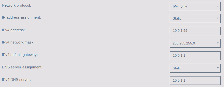

I have setup a bonded + bridged interface in load-balancing mode (6).
The bonded interface has fixed IP assignments.

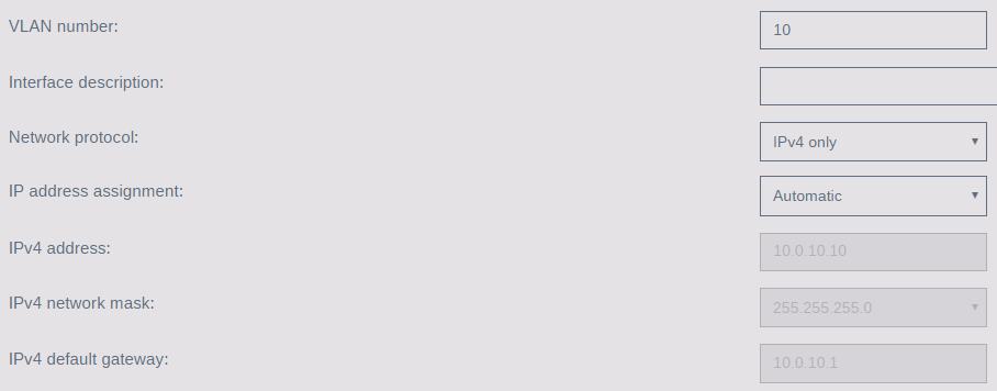

In addition VLAN 10 is created with a dynamic IP assignment (address 10.0.10.10 is obtained from the DHCP server on this VLAN).

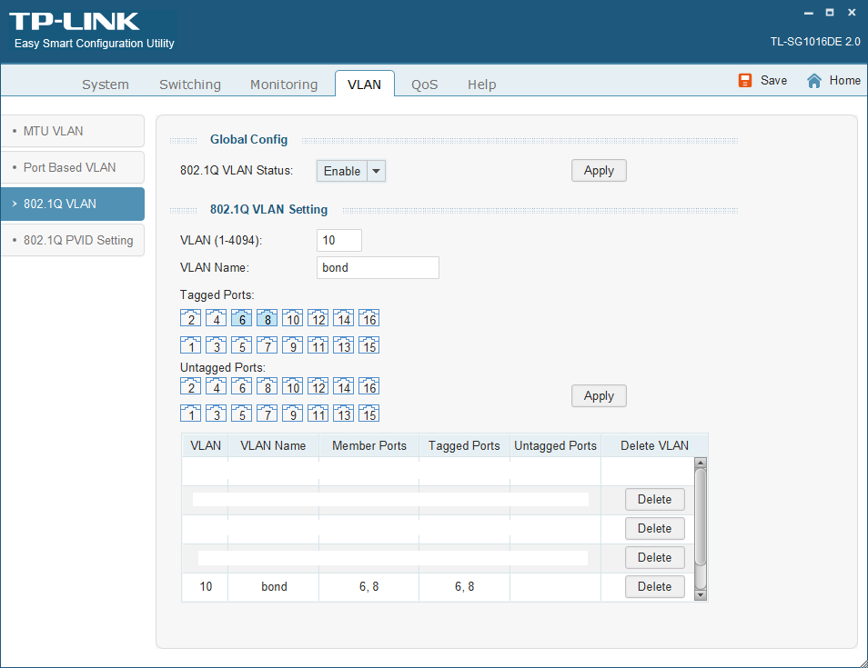

Switch is configured with additional VLAN 10 on both interfaces which connect to the server.
Made several tests and all is working fine. There are NO error messages and I can't make them appear either.
