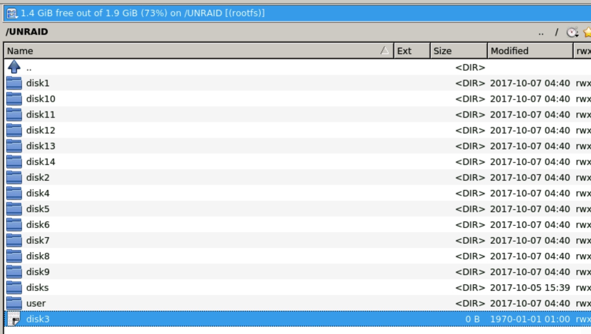

and all kept going well until I wanted to move a number of directories to the newly striped drive3...it shows just like all the other drives of the array in unRAID's "Main" tab, and in "Stats" it shows as 0% filled, but when I start Krusader to do my file operations, drive3 is listed not as a directory, like all the other drives, but like a document with 0 B size and a modification date of 1970-01-01 (see attachment).

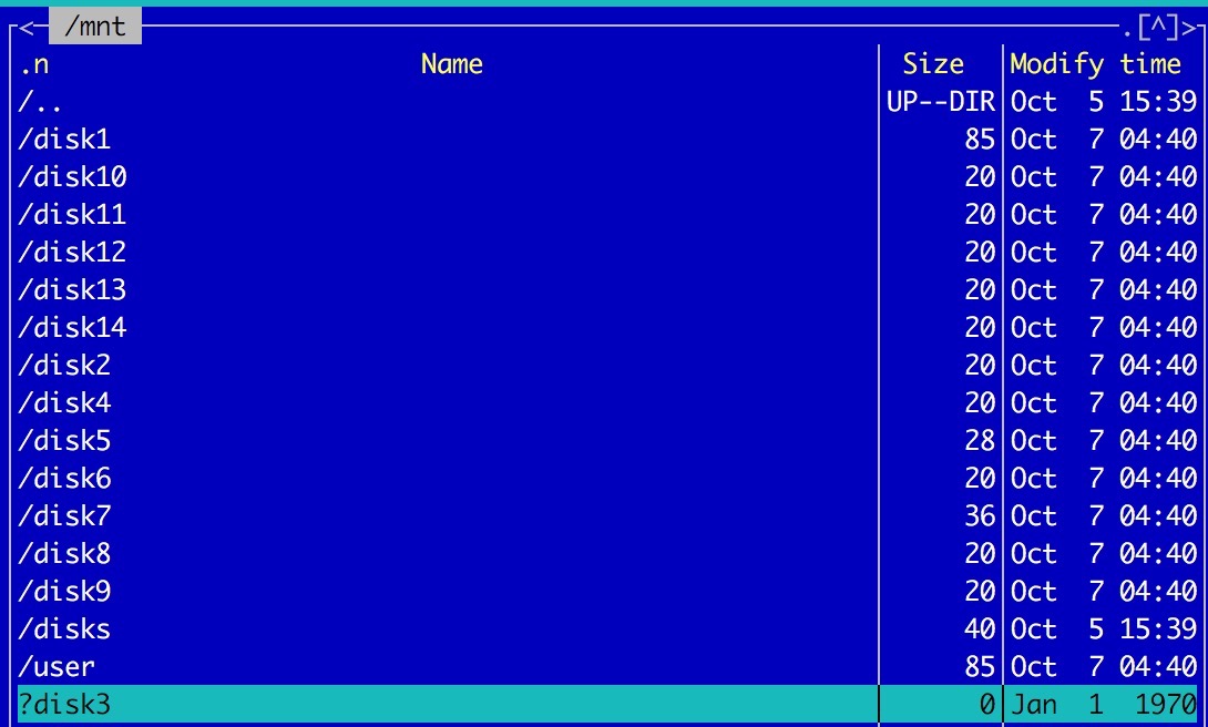

just to double-check I ssh'd into unRAID and ran MidnightCommander, which shows disk3 with a question mark before its name and also a 0 B file size and the same date (also attached).
what will I need to do to restore disk3 to normal operation? what file/log will you need from me to get the necessary insight into what could have gone wrong?

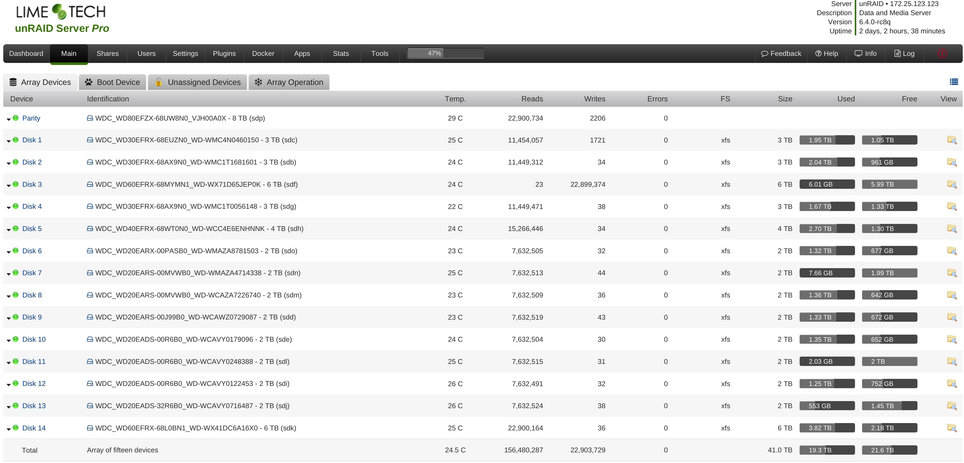

and this to show that the "Main" tab of unRAID looks like all is ok.
Strange, try stop and restart the array, if same post diags.
ok, will get started with that...might end up being a loong night (again).
I followed the first part of the instructions, the following output ensued...disk3 still not functioning as it should...might have to go to the "redoing a drive formatted with XFS" instructions, sadly...it's been two days of moving the old parity drive into the array while upgrading the parity to an 8TB drive...but so it does, sometimes :-/

You checked the wrong disk, it's md3, not md5
jeez, what a silly mistake! I'm beyond tired and probably shouldn't terminal, but I am now almost done reformatting, so let's see whether the error persists, and if it does, I'll be sure to address the correct drive...
Formating will fix it also
yes, indeed it did...good thing I started off with an empty drive, phew!
