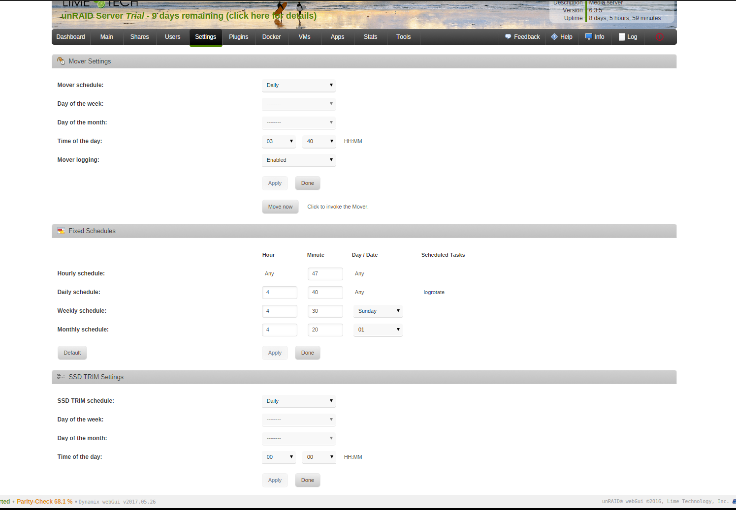

The partiy check option is not there in scheduler

You're the proud discoverer of a bug in 6.3.5.  If you don't have Parity installed (but do have Parity 2 installed), then you don't see the option to adjust the parity check times.
