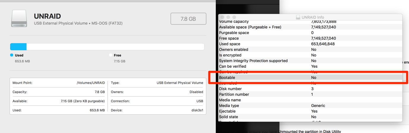

Great, it looks like the drive is no longer bootable:
59d6b59ca944d_Disk_Utility_and_UNRAID_Info_and_LimeTech__Registration_Key_Replacement.thumb.png.6489e84412e0ea3806f2bc24a0ddff8f.png
How is that even possible? And, more importantly, how can it be recovered?
