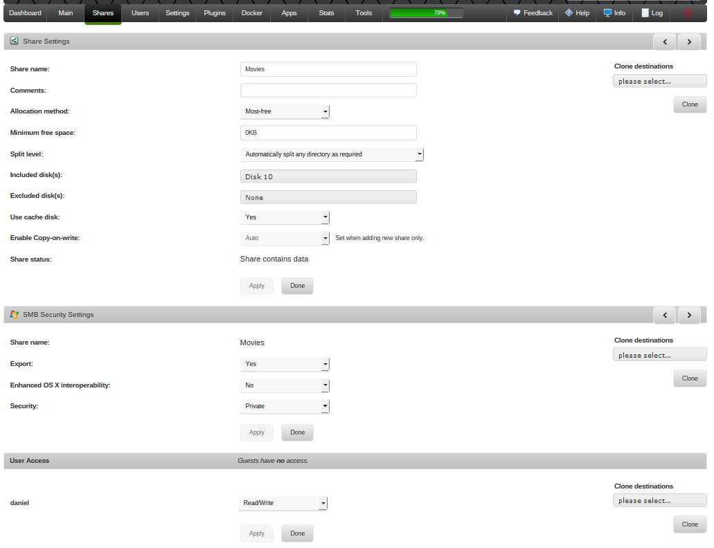

Settings for shares (Tab "Shares" on the GUI):
Export: Yes
Summary of security modes:
Public All users including guests have full read/write access.
Secure All users including guests have read access, you select which of your users have write access.
Private No guest access at all, you select which of your users have read/write or read-only access.
And then, dont forget to set access correctly for your unraid main user - your main user must have Read/Write access.

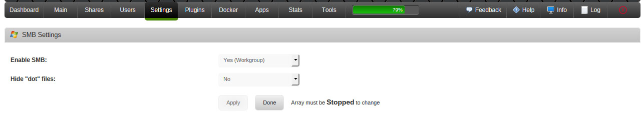

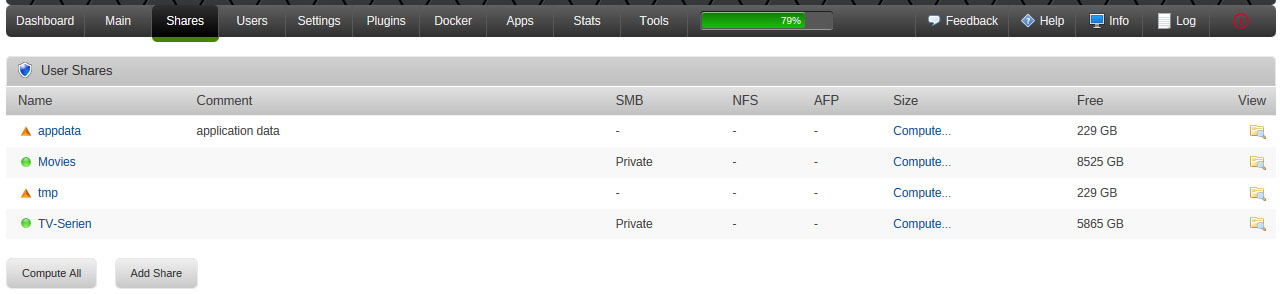

My screenshot shows all settings you need.
And dont forget to enable SMB under Settings, Network Services, SMB

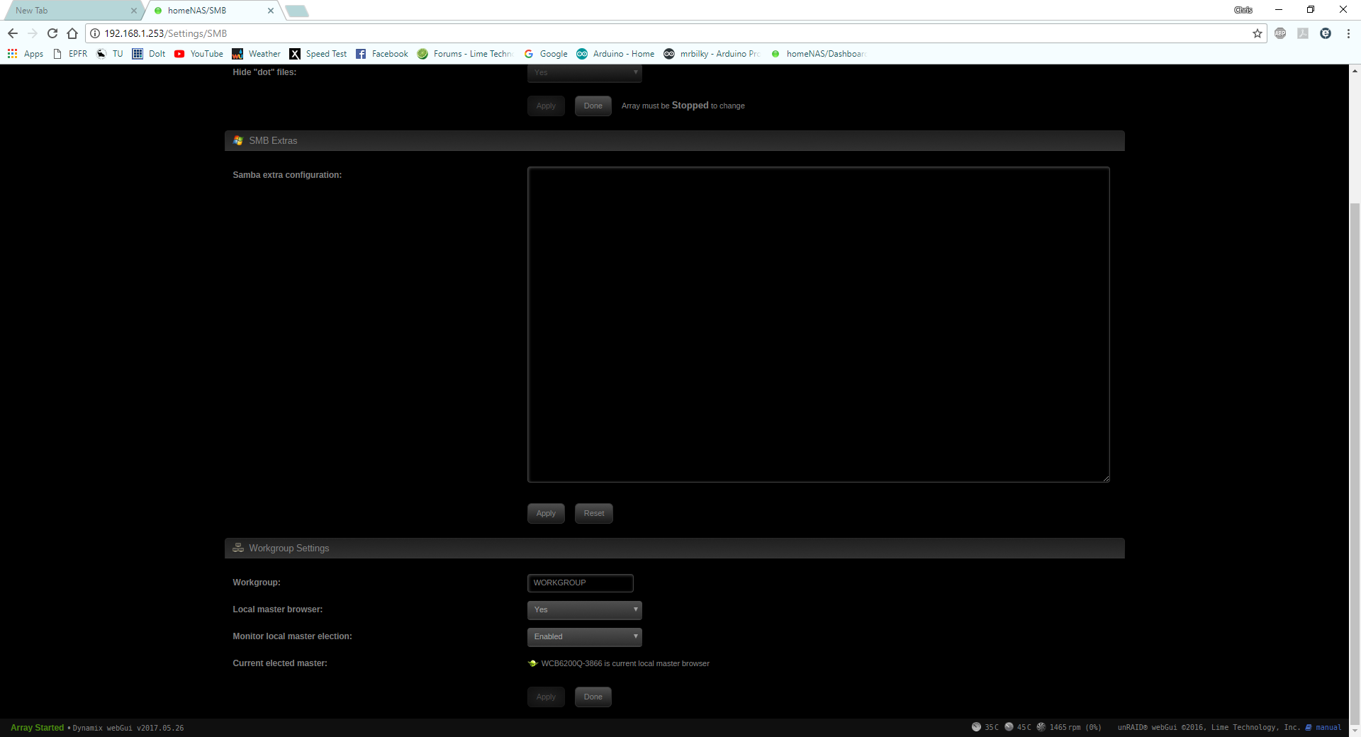

I've had the same problem with not seeing my box on my network with windows 10 and I too had to map my shares and that worked but I did find something interesting that may be playing an issue my local master is actually showing my extender as the master does that sound right shouldn't it be my unRAID server listed
The local master is an election.  Generally, the system that is up and running the longest winds up being the local master all else being equal, and if the system is up 24/7 any particular system running as local master is as good as any other.  (In my case, my LibreElec VM running on unRaid is my local master).
See here to force unRaid to be the local master https://forums.lime-technology.com/topic/53172-windows-issues-with-unraid/

Ha interestingly it worked although I tried several times and failed so I took the array offline and poof it worked! Another positive side affect is that now after trying for weeks to have openVPN start under host and failing it now works, will try later to set it up so I can access from outside the network Thanks again!
