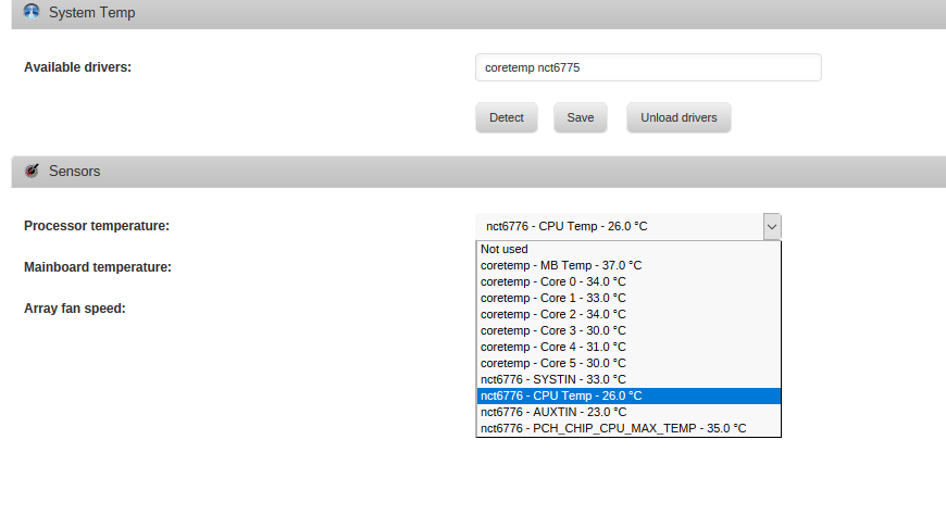

CPU temp - 51degC in IPMI, 26degC in Dynamix
I have a Supermicro X10sra-F with a Xeon e5-2620v3 cpu.
Dynamix System Temp shows a nice cool CPU temp of 26degC.

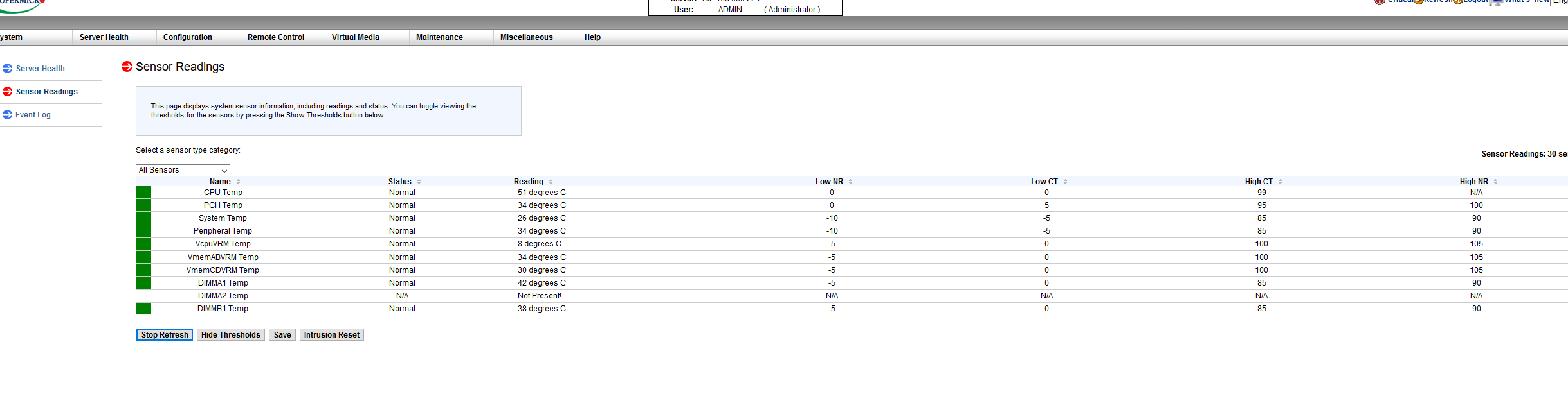

IPMI plugin and also the IPMI web interface shows a temp of 51 deg.
Which one should I believe. The cpu heatsink + fan is cool to the touch and the thernal paste was done according to the instructions and has spread well.

I have exactly the same problem with my X10SRA-F with a Xeon e5-2650L v3 cpu. I RMA'd the board thinking it was faulty but the new one had exactly the same readings. When I check lm-sensors in the OS the CPU looks normal and about 30 degrees C whereas IPMI is showing 60 degrees C.
