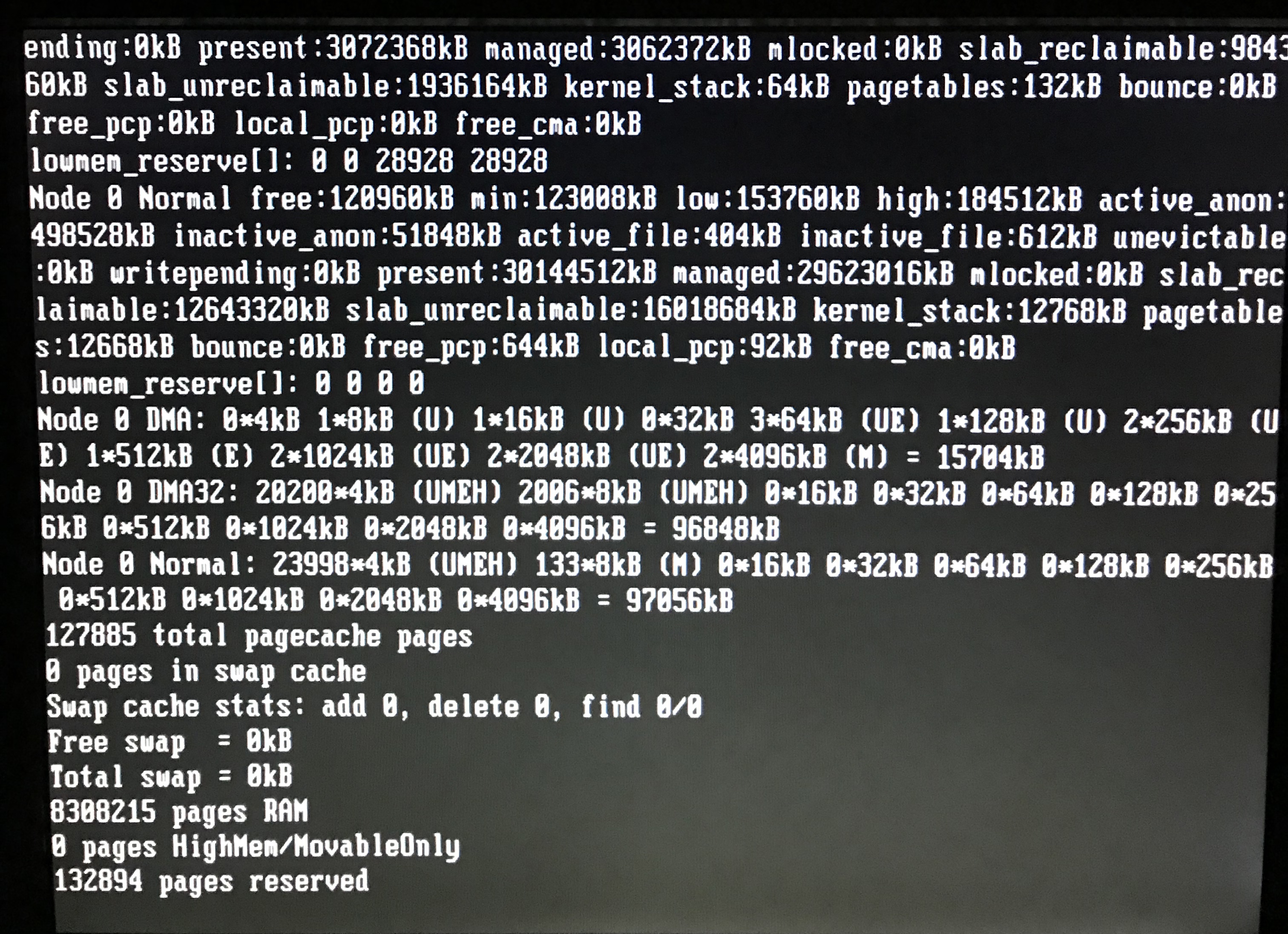

Looks like my server was completely hung this morning. I wasn’t able to access any of my Dockers or the Web UI. I’ve attached a picture of the console before a reset it.

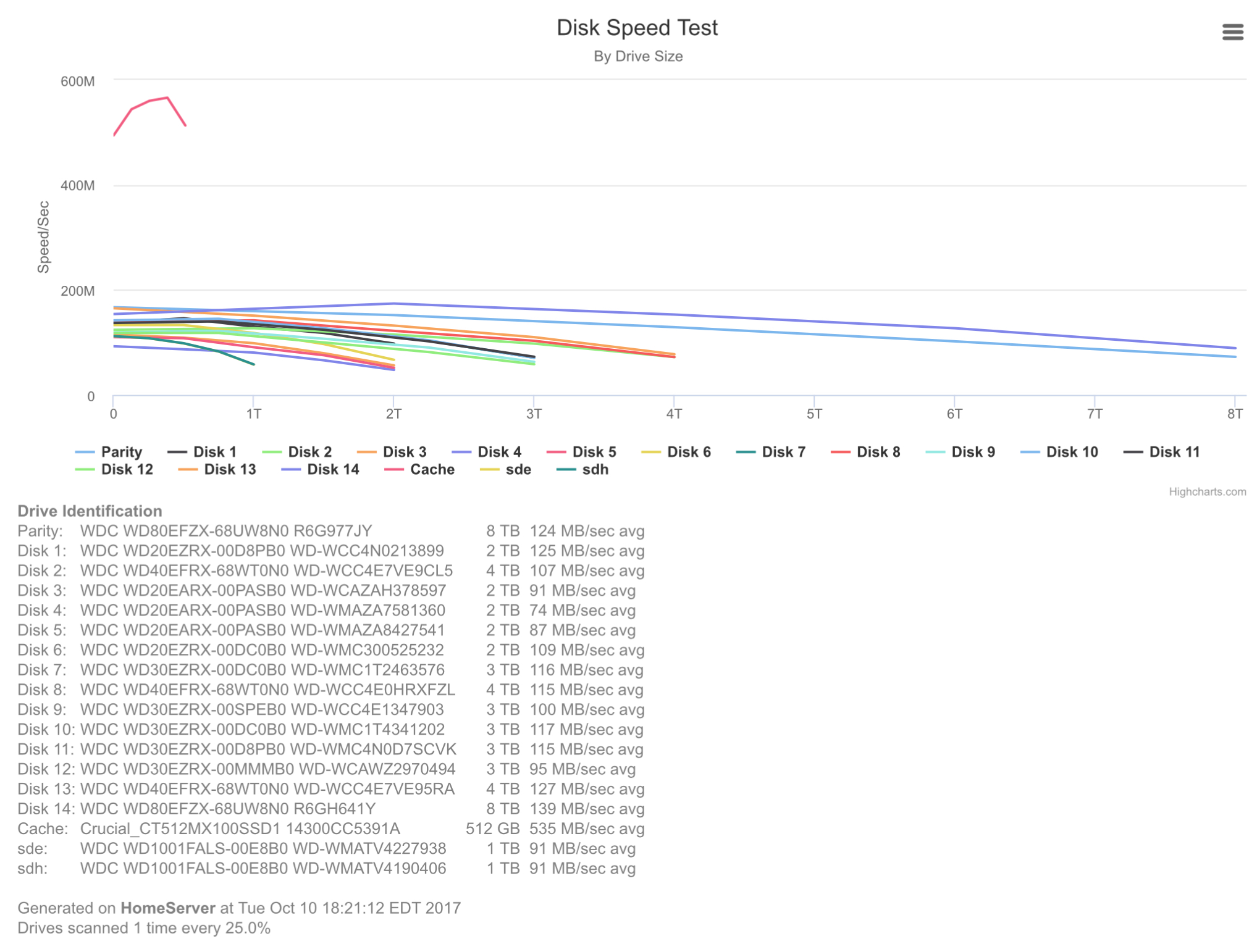

I’m still seeing really slow writes to my pool.  Downloading with SABnzbd to a drive outside of the pool is fast though. I ran a test with Disk Speedtest plugin and I’ve attached the results from that. All of the drives seem to be running fine, so I’m stumped on why the writing it so slow...
Edit - I see that that is just a test of the read speeds only, so I don’t have a view into the write speeds :)  Although my read speeds seem to be an issue too since I’m not able to play anything through Plex anymore either.

Memory issues again, you've since updated to v6.4, that kernel shouldn't need the previous tweaks, try setting them back to default.
