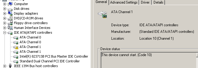

Thanks a lot for help with this, I was able to pass it through to the VM. But while the VM can see the cd drive and it can see blank discs, when I try to read or write anything it fails. I think it might be  a driver issue.
Not going to be able to help with that I'm afraid.  Sorry.
