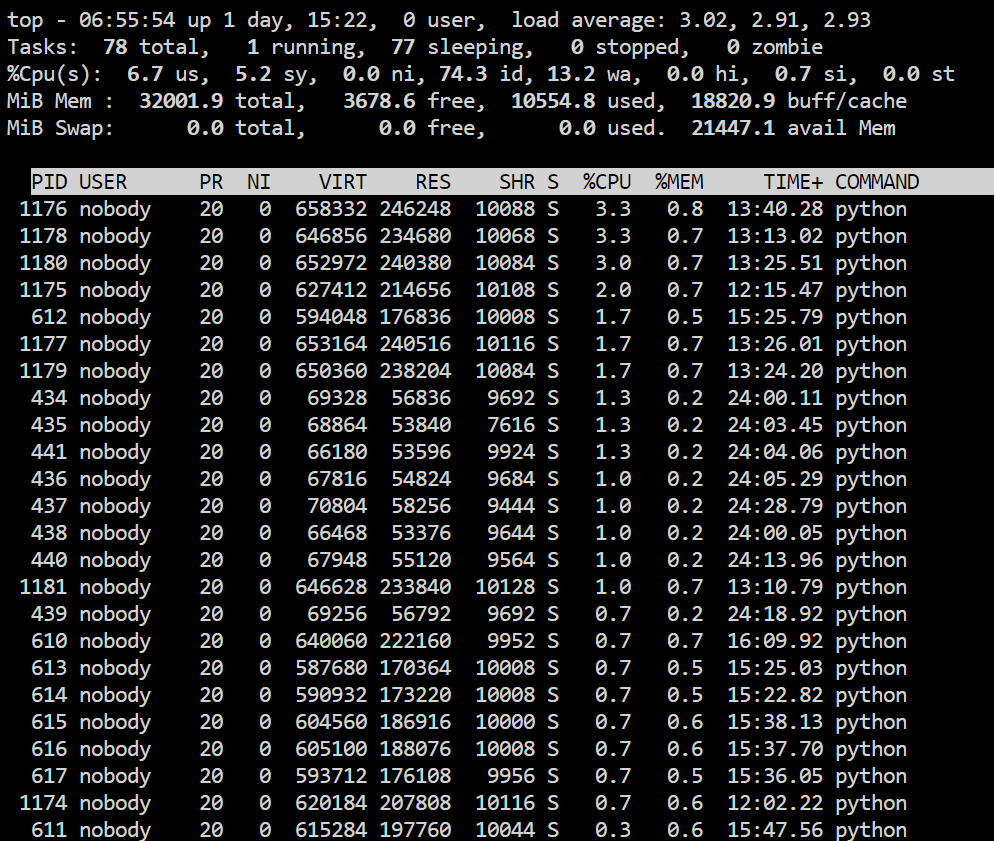

I seem to be running into an issue where rather than connecting to my previous vnc session, noVNC keeps creating a new VNC session when I connect, and I'm unable to connect to my old one. I know for sure my old VNC session is still running, because in it is a python script that I can tell is running based on both top and disk usage (its scraping APIs and saving them). Is there any way to "recover" that first VNC session?
Here is my output from a terminal of the multiple vnc processes:

And here is output from my top file showing that my python scripts are still running.
hmm probably not, i know its not ideal but can you not simply restart the container?
p.s. I'm not exactly sure how you got into this state to be honest, i use this container myself extensively and i have not seen a orphaned vnc session before, it def is an odd one, if you can replicate the issue i would be interested.

I can restart the container, I had seen something happen before that may have been the same issue, but this is the first time I have diagnosed it as an orphaned vnc session before. I'll let you know if I do have it happen again.
I do have the orphaned container issue again. If you'd rather take it to DMs for more back and forth we can. The primary thing that I can see being an issue out of normal usage is that my uptime is 4 days, and I'm running 5 python scripts continuously in it. I can share with you what you think you would need to diagnose/reproduce.
