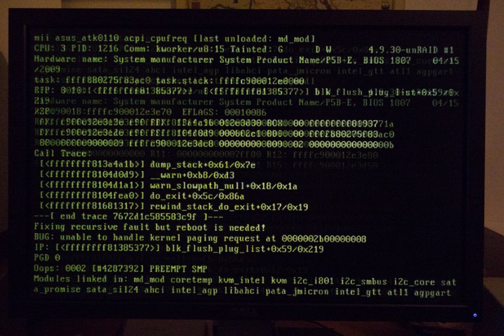

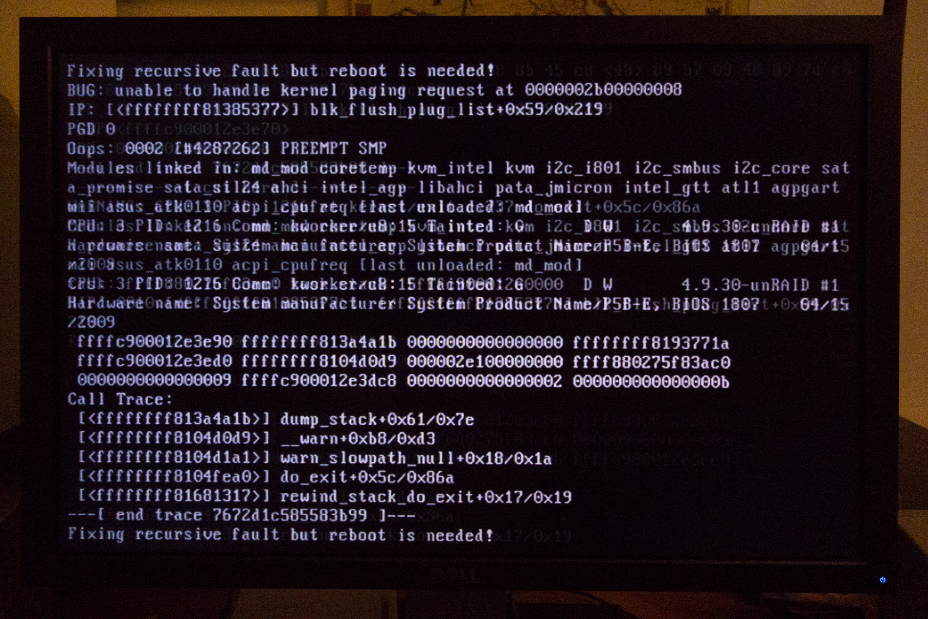

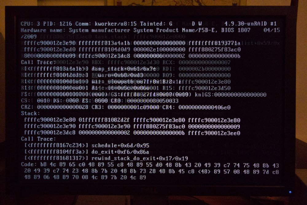

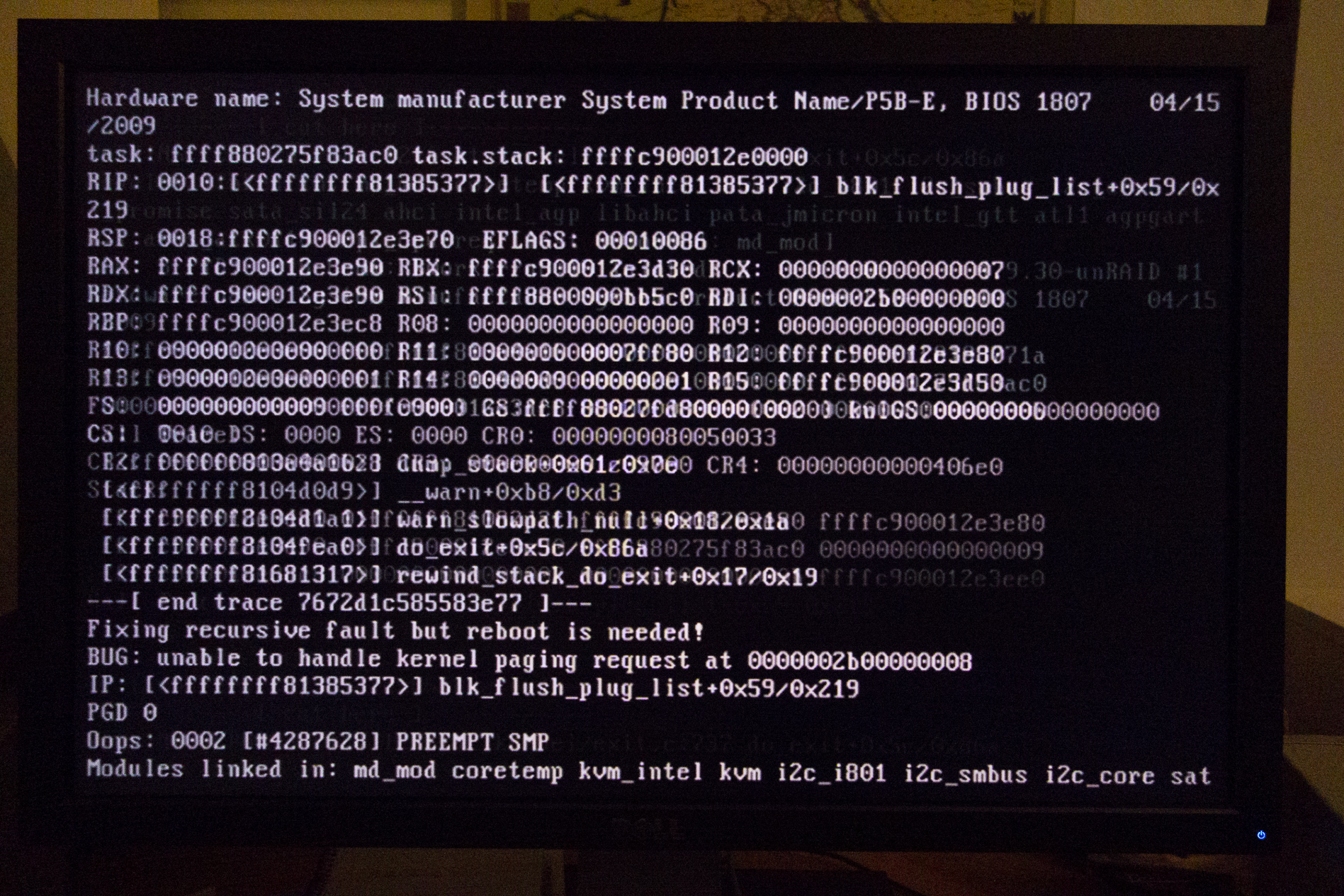

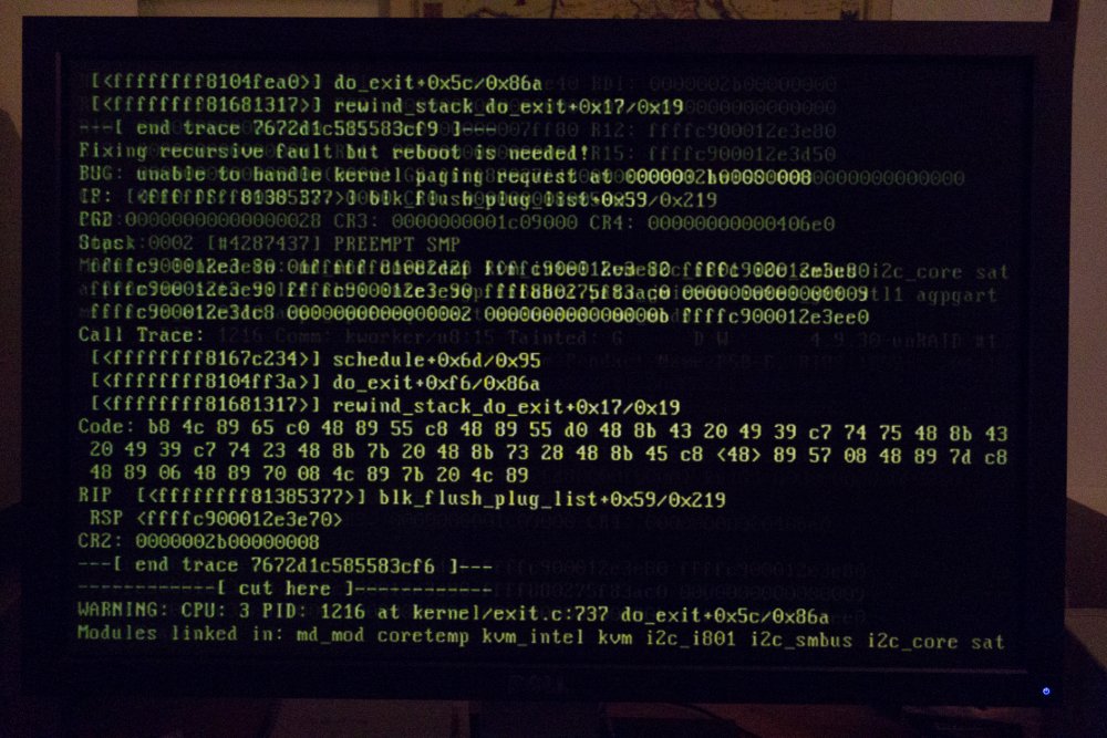

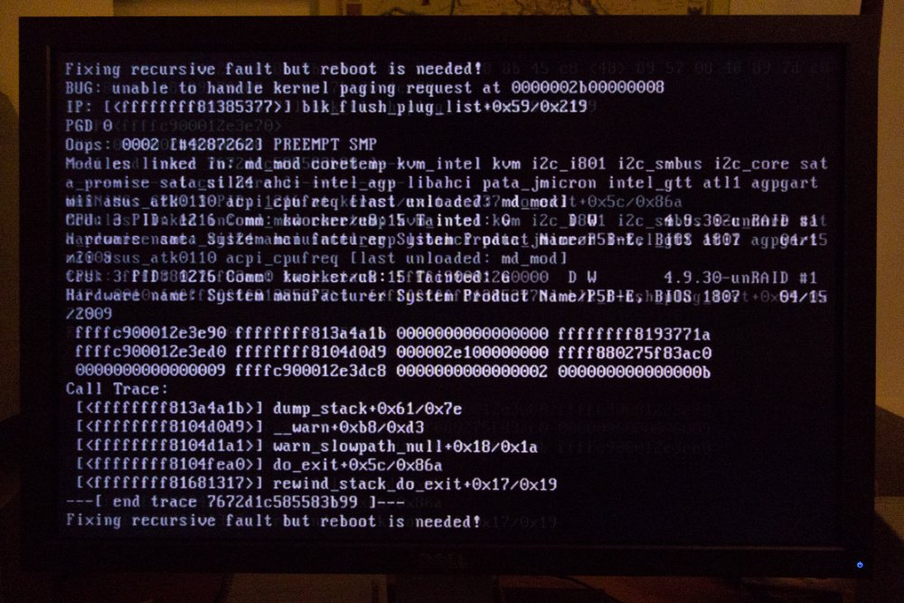

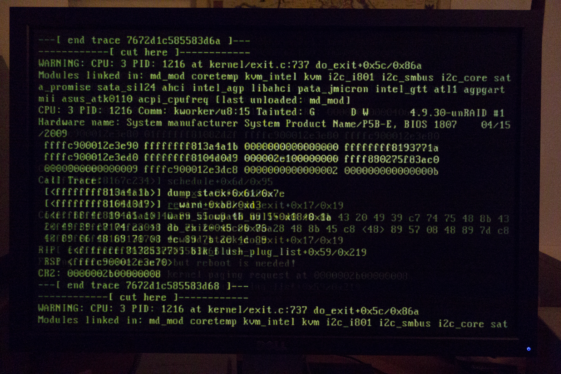

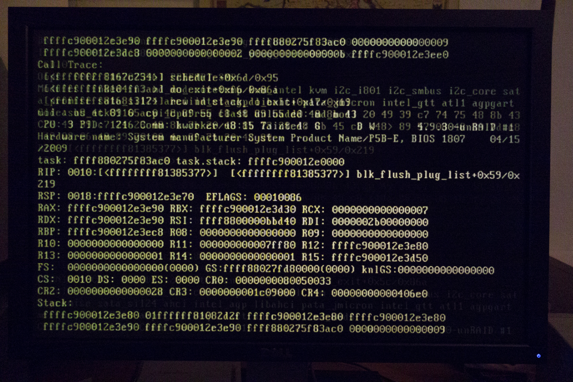

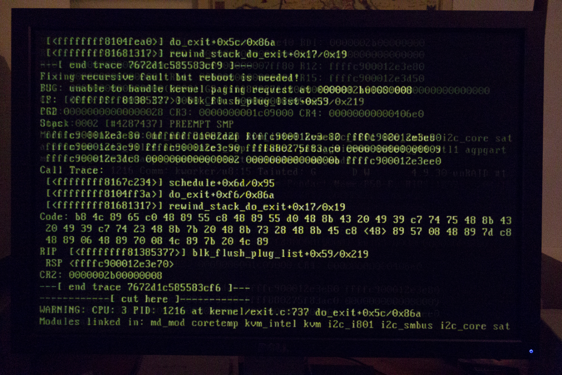

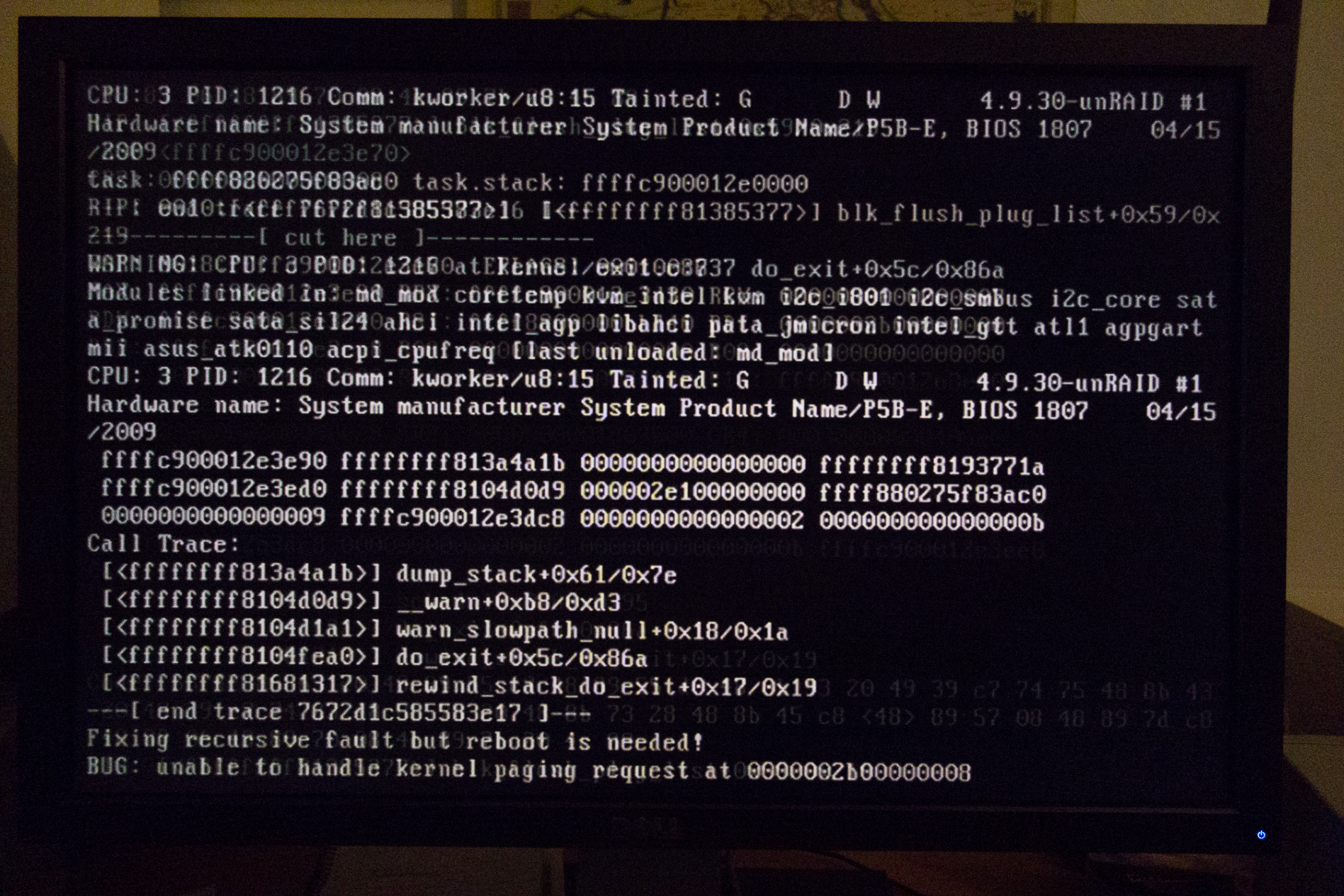

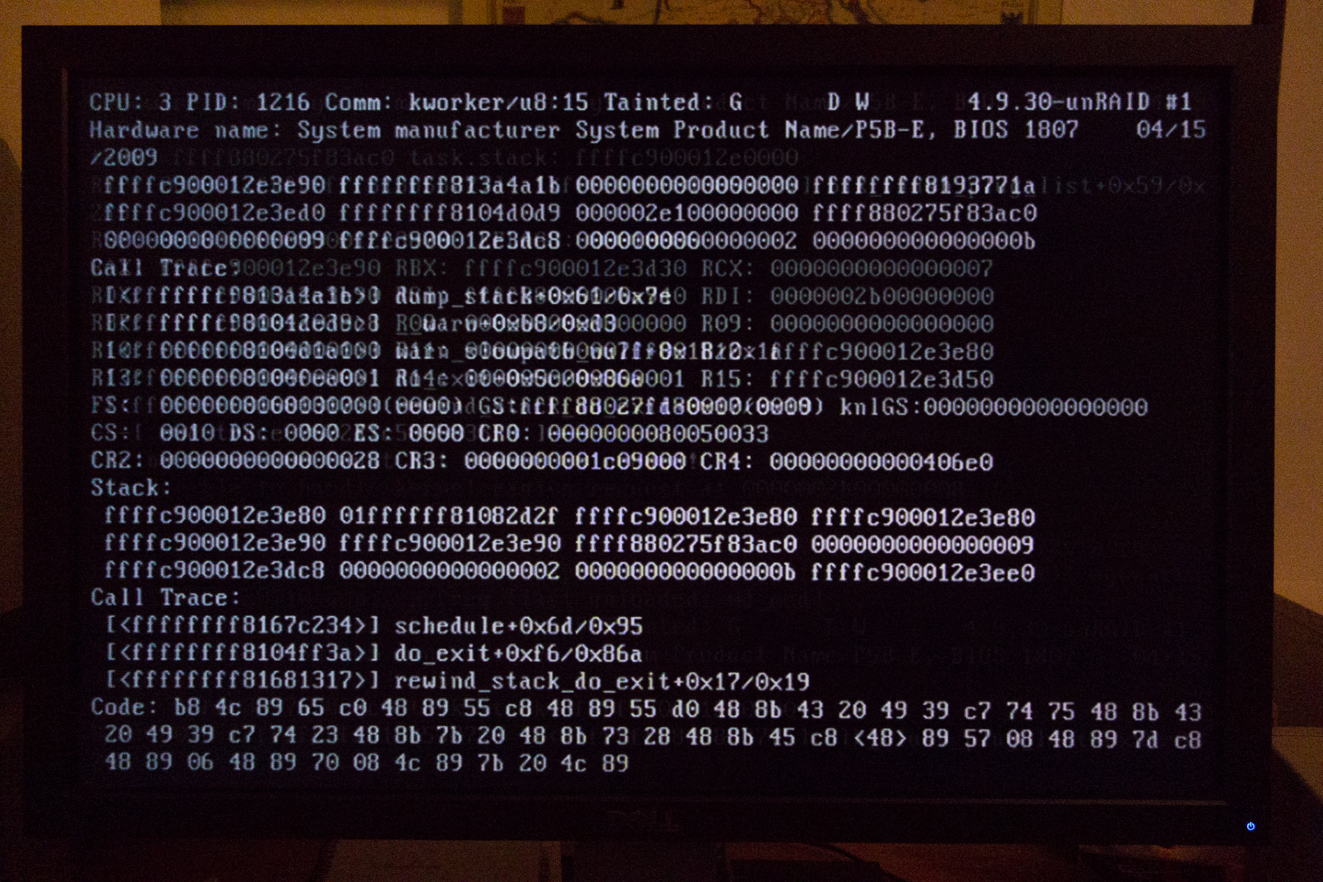

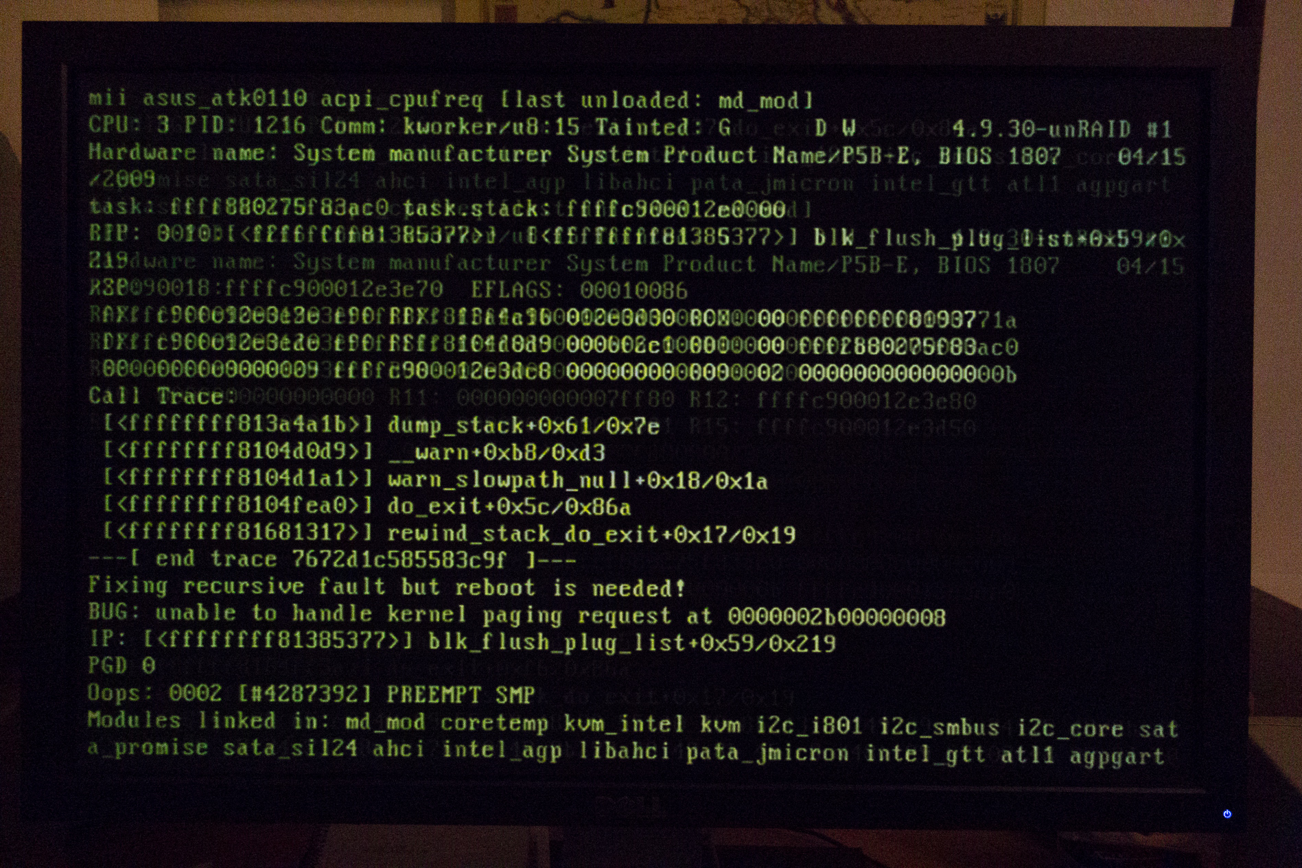

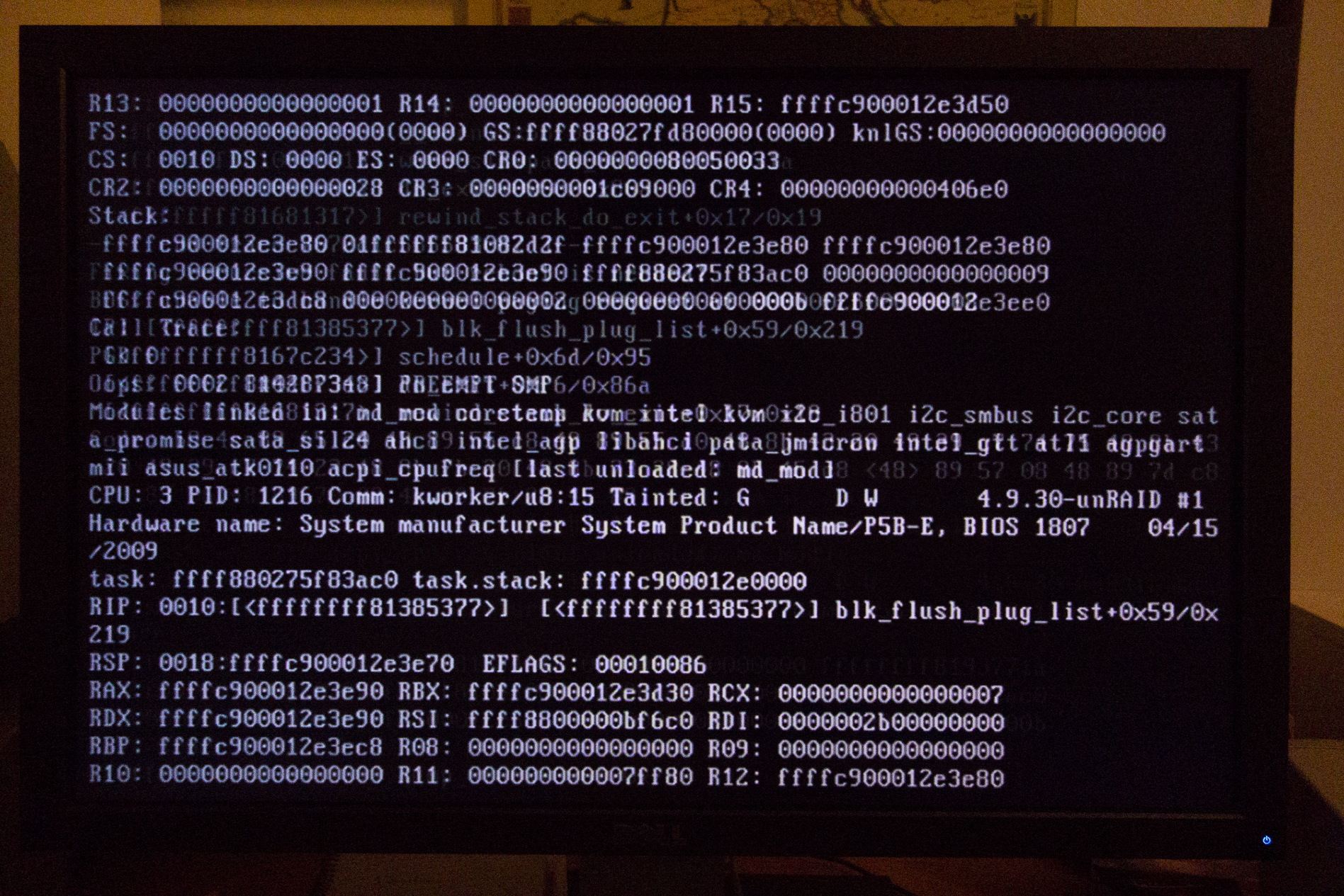

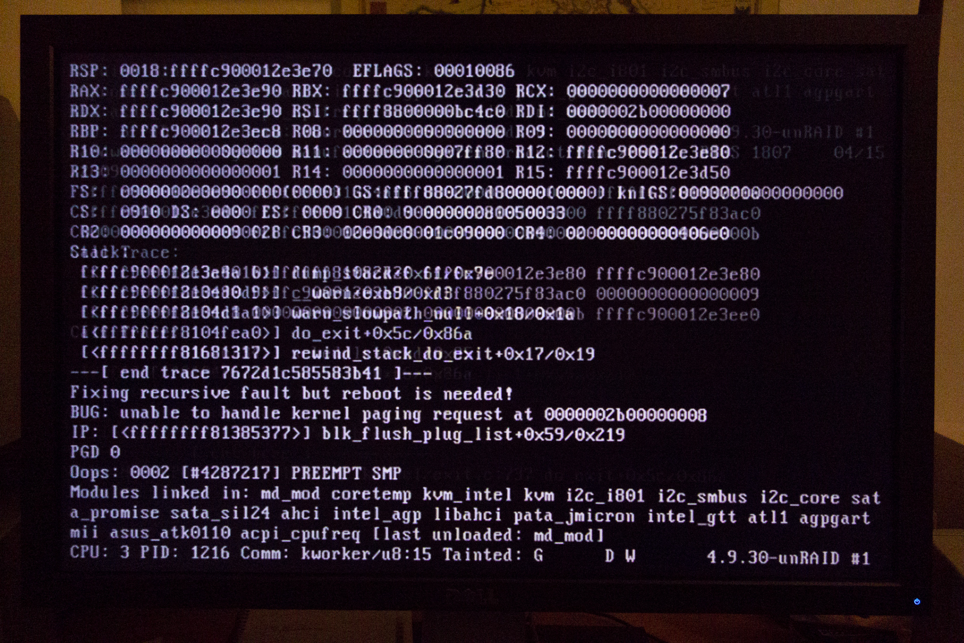

I need some more advice.
I replaced disk 2 with a new drive and started rebuild. Now I cannot reach the webgui and neither can I access server with PuTTY. It is about  13 hours since I started the rebuild and lost contact.
With PuTTY I get the error message “Unable to open connection to TOWER. Host does not exist.”
So I plugged my monitor into the Unraid server so see if something could be seen that way. There was a lot of fast text scrolling on the screen, but it was flickering so fast that it is impossible to make out what it says. I grabbed a camera and tried to capure it. I can make out some of it. I think it might be the same message repairing over and over, but I am not 100% sure.
I am not sure what it means and I am not sure what I am looking for. I can make out the following:
Fixing recursive fault but reboot is needed!
BUG: unable to handle kernel paging request as 0000002b00000008
IP: [<ffffffff81385377>] blk_flush_plug_list+0x59/0x219
PGD 0
Oops: 0002 [#4287628] PREEMPT SMP
Modules linked in: md_mod coretemp kvm_intel kvm i2c_i801 i2c_smbus i2c_core sat
A_promise sata sil24 ahci intel_agp libahci pata_jmicron ntel_gtt atl1 agpgart
Mii asus_atk0110 acpi_cpufreq [last unloaded:md_mod]
CPU: 3 PID 1216 Comm: kworker/u8:15 Tainted: G     D W     4.9.30-unRAID #1
Hardware name System manufacturer System Product Name/P5B-E, BIOS 1807 04/15/2009
[then there is some more code]
Call Trace:
[…] dump_stack+0x61/07e
[…] __warn+0xb8/0xd3
[…] warn_slowpath_nuyy+0x18/0x1a
[…] do_exit+0x5c/0x86a
[…] rewind_stack_d0_exit+0x17/0x19
---[ end trace 7672d1c585583b99 ]---
I think there is some other info in there as well that I might have overlooked.  Please have a look the attached screenshots taken with camera.
So, I guess something is wrong? What could it be?
Is it safe to just switch off/kill power to the system? So I do it?
BTW. I ordered an used LSI 9201-16i and some SAS to SATA cables yesterday. Hopefullt that will arrive within 2 weeks or so.
It's the only option, rebuild should restart from the beginning.
Any thoughts on what the above error is about?
