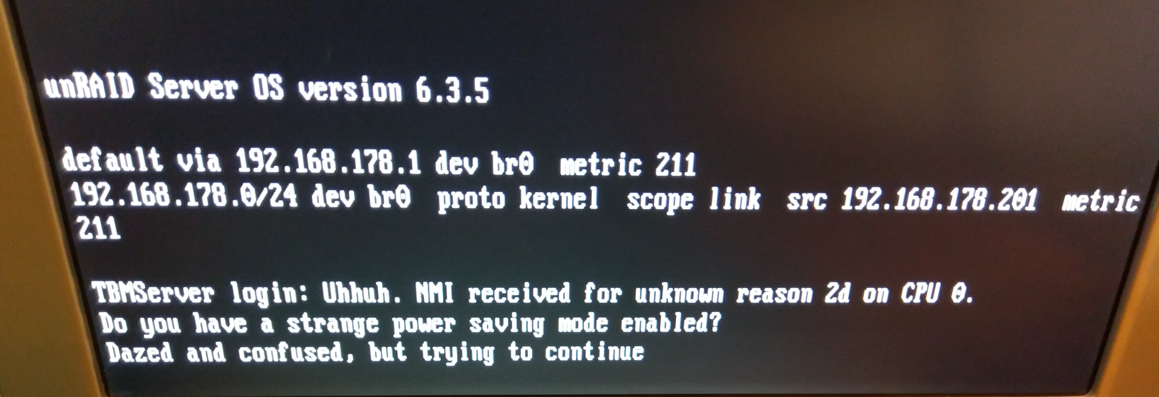

So, I have installed a RX550. I  chose this card since it would fit in the server and wasn't too expensive. Plus, RemoteFX worked with my RX480 so I'd reckon this should work with the RX550 too.
Unfortunately when starting the VM after assigning the GPU, the server crashes.
When both VNC and dedicated GPU selected I can see through VNC it boots the Windows logo but stops there.
Looking at the console I see this error the moment the VM starts:
Uhhuh. NMI received for unknown reason 2d on CPU 0.
Do you have a strange power saving mode enabled?
Dazed and confused, but trying to continue
Even when immediately stopping the VM, the server will still crash (just power down really) and reboot.
I have tried different settings (PCIe ACS override), tweaking the BIOS, set CPU to Emulated instead of passthrough.
Though, nothing helped this far.
An option would be to install Windows directly on the server to use RemoteFX, but with this I would lose the data protection UnRaid offers.
Has anybody ever experienced the problem I currently have? (and found the problem?)
Would there be other ways to use the data protection of UnRaid but use RemoteFX?
