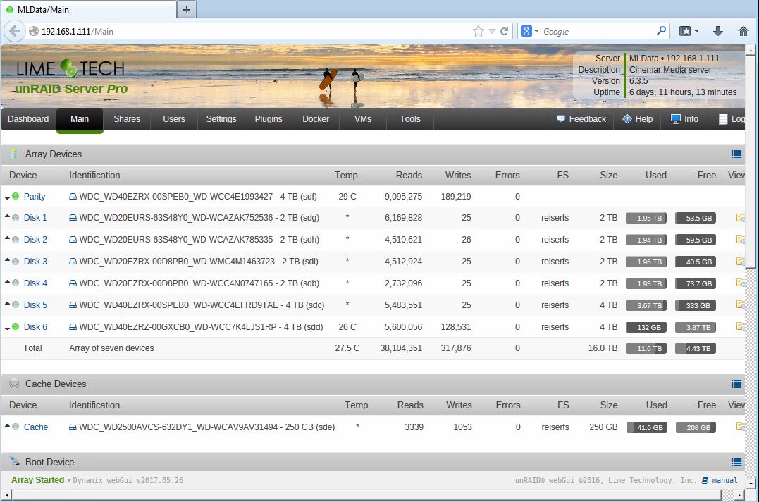

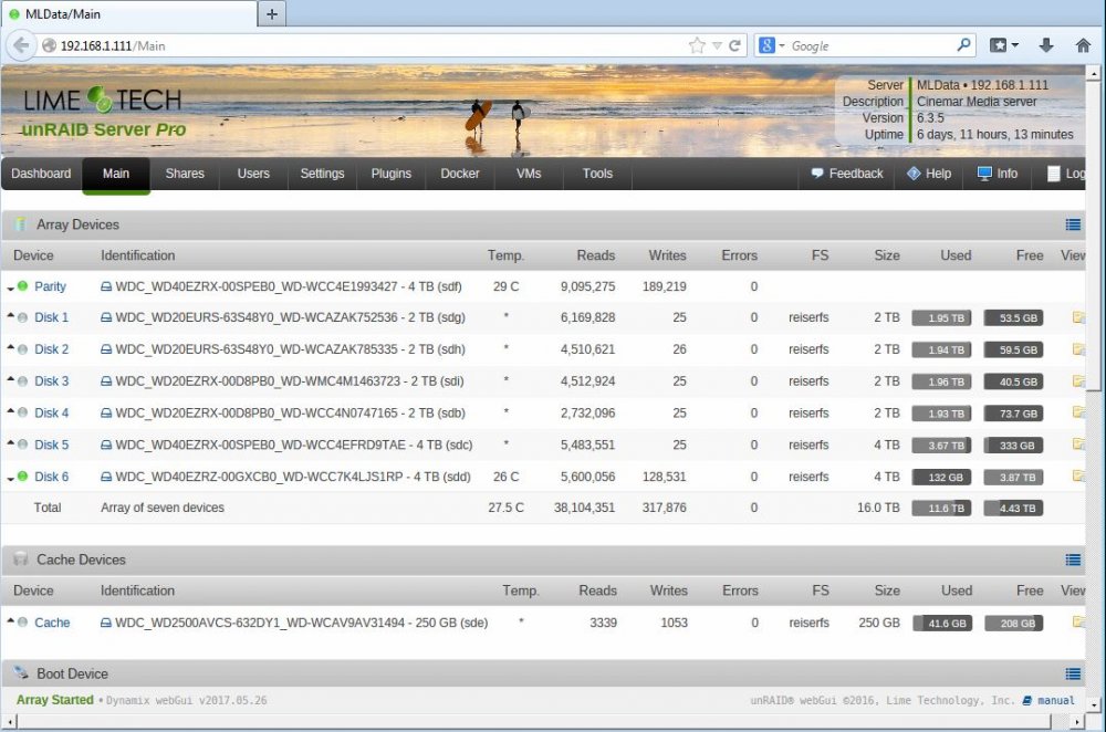

I'm attaching a screenshot of the "Main" view, along with my debug file, in case that helps.

Hi -
Do you have the specs on your server?  I.e., CPU, memory, etc?  (Looks like a Core i3 with 8GB but want to confirm.)  Also, what does your media server/player environment look like?  You mentioned Dune, so are you using Dune players to access the media files directly on your server?  Or is anything like Plex involved?  It looks like you setup Docker...
FYI, you have a bunch of really full ReiserFS disks - that's not good.  It's a deprecated file system that's know to behave poorly when full... You also have something going on with ntp.

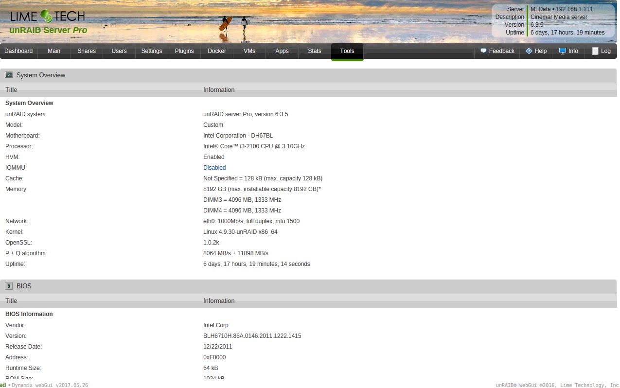

First off, thank you, tdallen, for taking the time to ask some questions.
I'm attaching a screenshot from the "System Profiler" plugin, which confirms your assumption of a Core i3 processor with 8GB of memory.
My media player is just a single, completely stock Dune player connected via a 100Mb link, one hop to the switch and one hop to this NAS server.  I don't know what Plex is, so I can't answer that question.  I also don't know what Docker is, sorry.

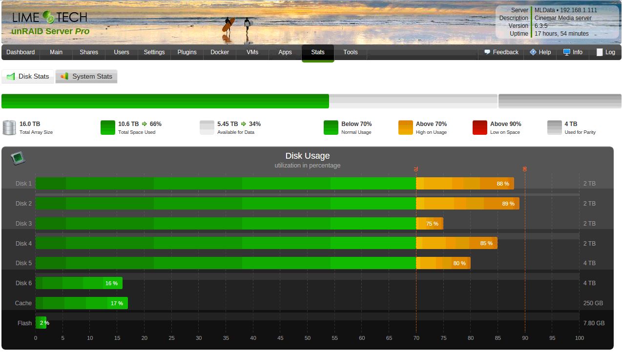

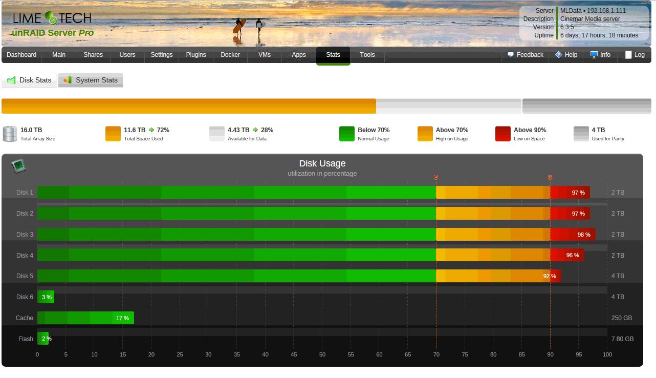

And yes, you're correct that my smaller disks are very full (screenshot of that attached, too).  I've just been adding more disks as the previous one filled up, assuming that anything less than 100% is okay.  Apparently that's not the case and I should better balance their contents.   I will need to go read up on how to do this.  Should I assume that they should be below 90%?  80%?

42 minutes ago, tdallen said:

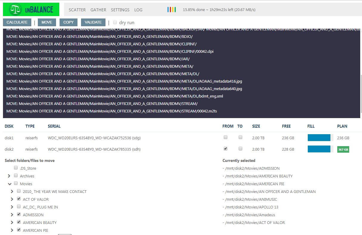

There is a plugin called unbalance that would allow you to manually move files around the free up space, you could try that and see if it alleviates the problem.
Thanks, that looks like what I need!  Unfortunately, once I've enabled it, I click on "Open Web UI (v3.3.3 )" and it just pulls up a blank web page.  I'll keep trying...
UPDATE:  I just tried opening unbalance via Chrome instead of Firefox.  Now it's working...  : )

Here's an update, along with a few more (basic, possibly stupid) questions:
I've spent some time with the "unbalance" plugin to reallocate files from drives 1-5.  I also took the opportunity to cull out some of the movies we'll never watch again.  With those two things I now have a slightly better-looking Disk Usage chart (below).  Not knowing a thing about the weakness(es) of the ReiserFS, do I need to get them all below 80%?  70%?

One more thing... when I am moving files from one disk to another (using "unbalance"), sustained performance is around 20-21 MB/s.  Is this about what should be expected?

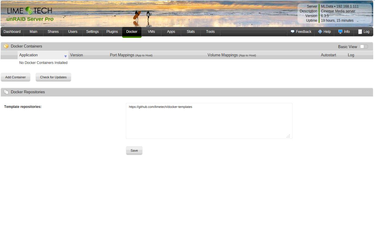

I know you mentioned that you aren't familiar with Docker, but it looked from the logs like it might be setup (and would explain the use of the cache drive).  Click on the Docker tab and post that screenshot.
Docker is the main thing that has turned unRAID from just a NAS to an application platform.  There are now dozens and dozens of apps that run on unRAID as Docker containers.  To support this, the cache drive has become the defacto "application drive" in unRAID 6+ and applications and their data are typically permanently stored on the cache drive.
Here's the screenshot of the Docker tab.  Is there anything here that explains the contents on the cache drive?
Nope.  Time to explore the cache drive and see what's there...

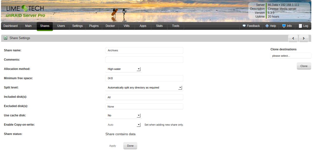

And below is a screenshot of the "Archives" share.
Questions:
1) Why do these files get placed onto the cache drive, when "Use cache disk:" is set to "No"?
2) Why doesn't mover push these to the main drives at 3:40am?

Questions:
Not sure why 1) is happening.
2) is explained by the fact that with Use Cache=No set then if any files for that share end up on the cache drive for some reason they are ignored by Mover.    Mover will only move files from cache to array for shares where use Cache=Yes.
I would imagine that something is writing directly to /mnt/cache/Archives rather than /mnt/user/Archives ?

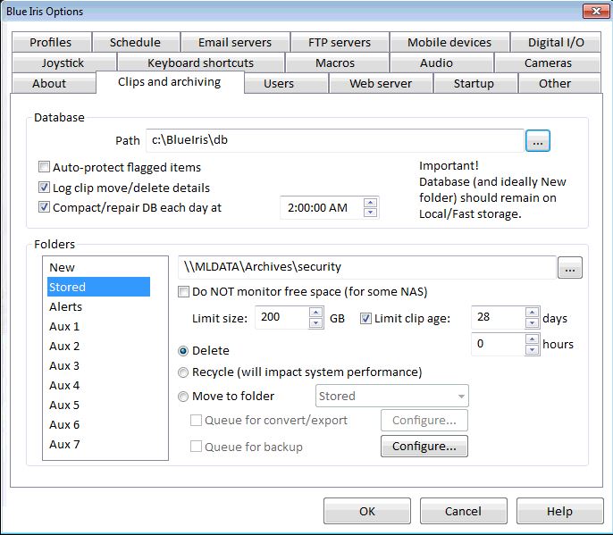

The security cam app is called BlueIris.  Below is a shot of the configuration that tells it where to move clips after 7 days.
BlueIris runs on a standard dual-socket Intel server, in this case called "MLServer".  unRAID is running on a separate storage server called "MLData".  (Cinemar, the original vendor of this, is the one who named them; ML stands for "MainLobby", which is their movie automation app that also runs on MLServer.)
My format of \\MLDATA\Archives\security is slightly different than yours, but it's not obvious to me how/why that is writing to cache.  In any case, I've kind of highjacked my own thread here on this cache disk content thing...
