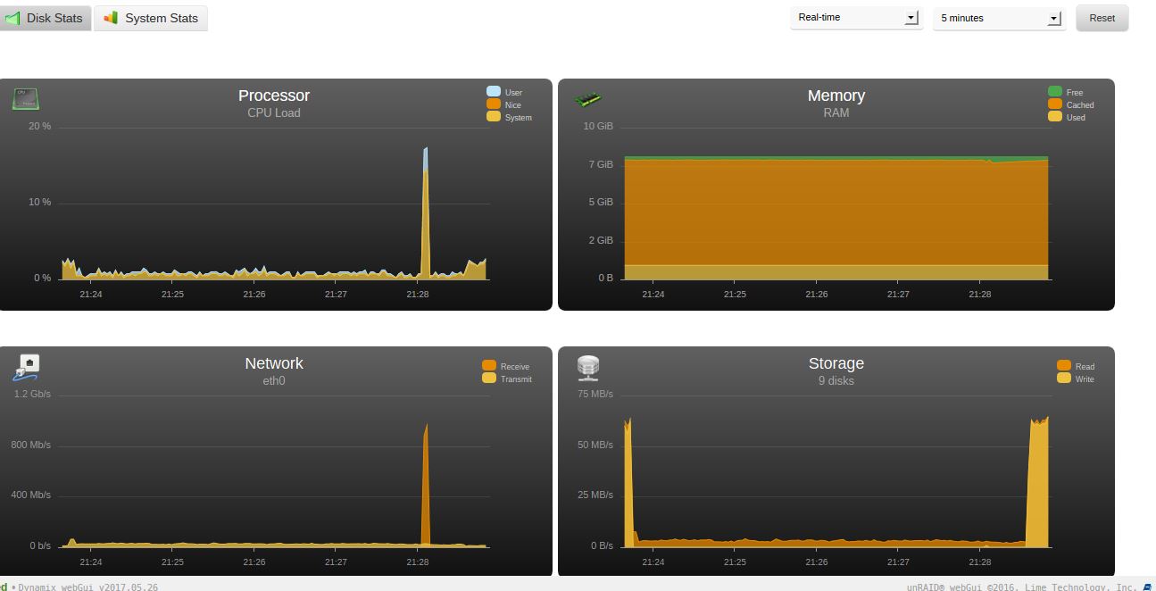

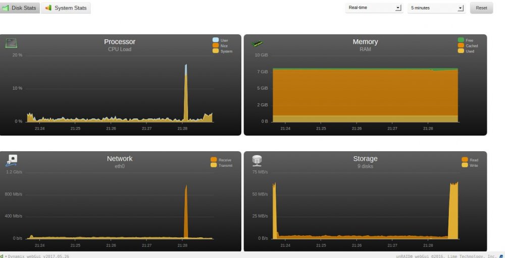

Okay, I collected some interesting data last night.  I am still able to re-create the stuttering playback issue, but this time I was looking at the activity within the array and captured the image below.  The array is ingesting a burst of data (a single file write operation, typically between 10 and 80 MB, sourced from the security camera app), and approximately one minute later, there's a huge amount of HDD activity and the movie playback stutters.  This phenomenon is repeated very reliably each time such a write to the array takes place.
So...  a workaround to this is to simply not have BlueIris write to the array, but I'm wondering if there is anything that can be tweaked in unRAID to solve this problem more elegantly.
My 2nd main question now is:  Did something change from 5.x to 6.x to cause unRAID to be more sensitive to this inbound stream of data during movie playback?  As I stated in my initial post, this problem only started happening after my upgrade to 6.3.5 from 5.0.6.

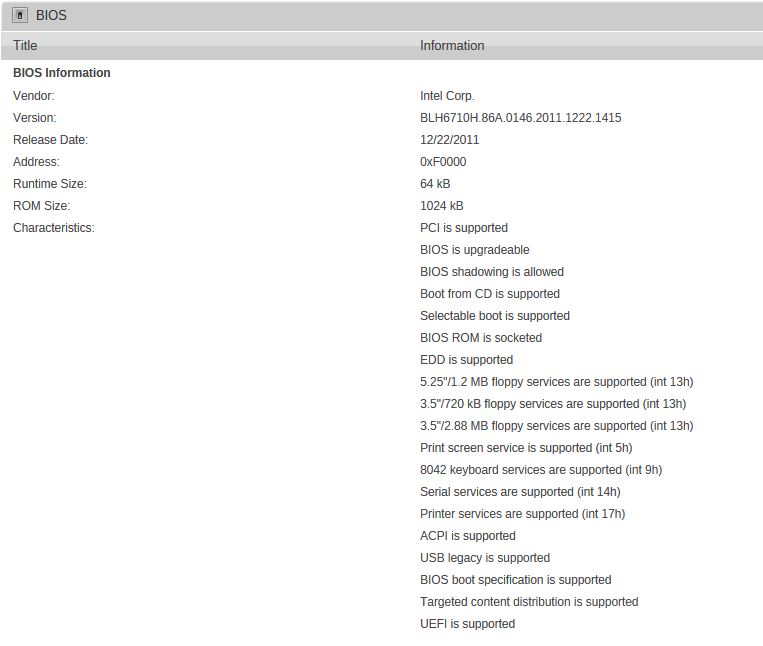

Okay... but unfortunately this is where I get in over my head.  Can you provide me an idiot's guide on how to check / affect this?
If it helps, attached is some information about my BIOS settings, but I don't see anything in there about ACHI...
AHCI is already enable.

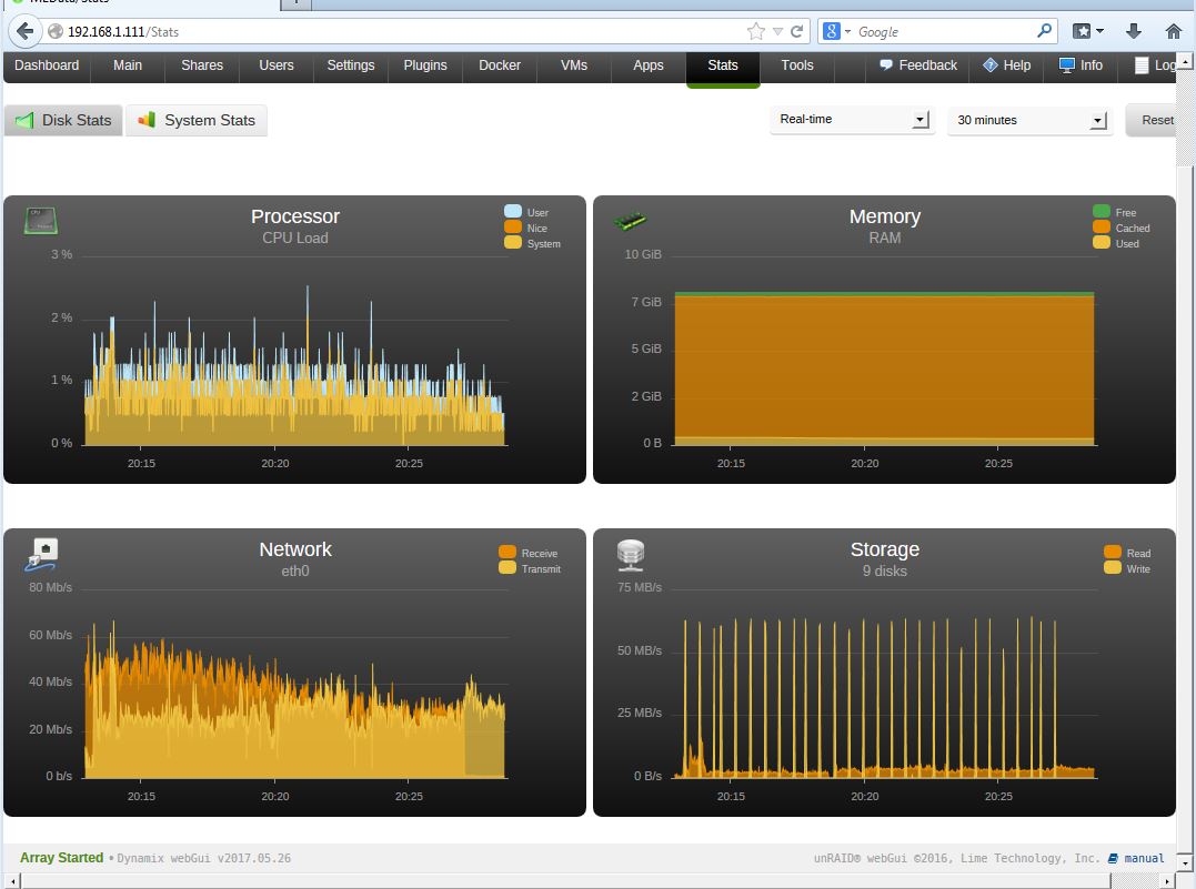

One final post to close this thread out.  In summary, everything appears to be fixed and now working as expected.  I've converted all disks over to XFS and enabled cache for writes to my Movies and Archives shares.  As a final test, I ripped a DVD to the array (to generate inbound traffic) while streaming out a movie last night and it worked just fine with no stutter events.  You can see the writes to the array as the 30-odd spikes in the Storage window below, while the movie streaming progresses without interruption.
I want to thank everyone who took the time to walk me through this.  I now have a much better understanding of my unRAID system, where before it was unfortunately just kind of a black box to me.
