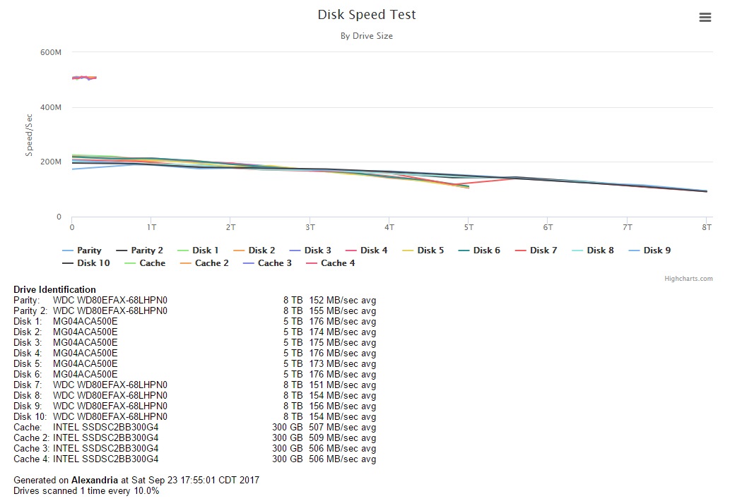

5. Ran the diskspeed script from these forums and performance seems adequate

Diskspeed Script Results:
