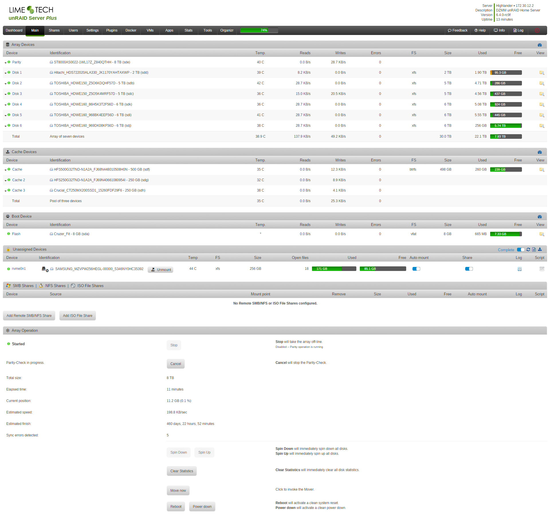

hmm it's still not right - screenshot is while machine is doing a parity check, plus 2 transfers via putty from disk 5-->6 and disk 4-->5; and deluge_VPN downloading at between 500-1200KB/s.
Look how low the speeds are.

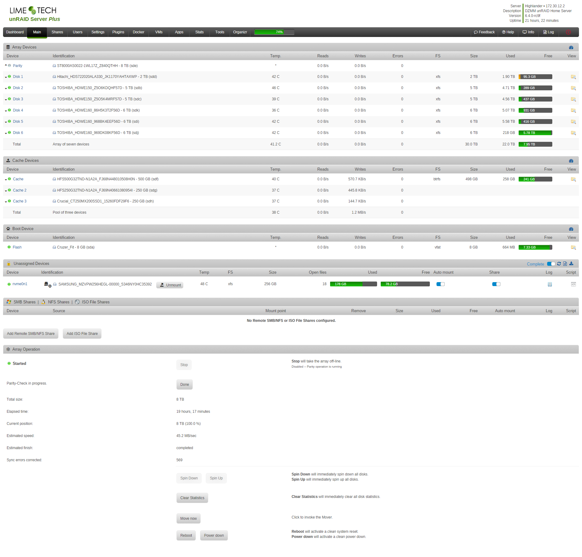

Update:
Parity check completed in 19hr 17 min at an average of 115MB/s which I think is about right.  It threw up 569 errors which I don't think it was supposed to after a parity rebuild?
59e71c652c347_FireShotCapture31-Highlander_Main-http___172_30_12.2_Main.thumb.png.e2f35a01872c00a03b10a0389ff822e2.png

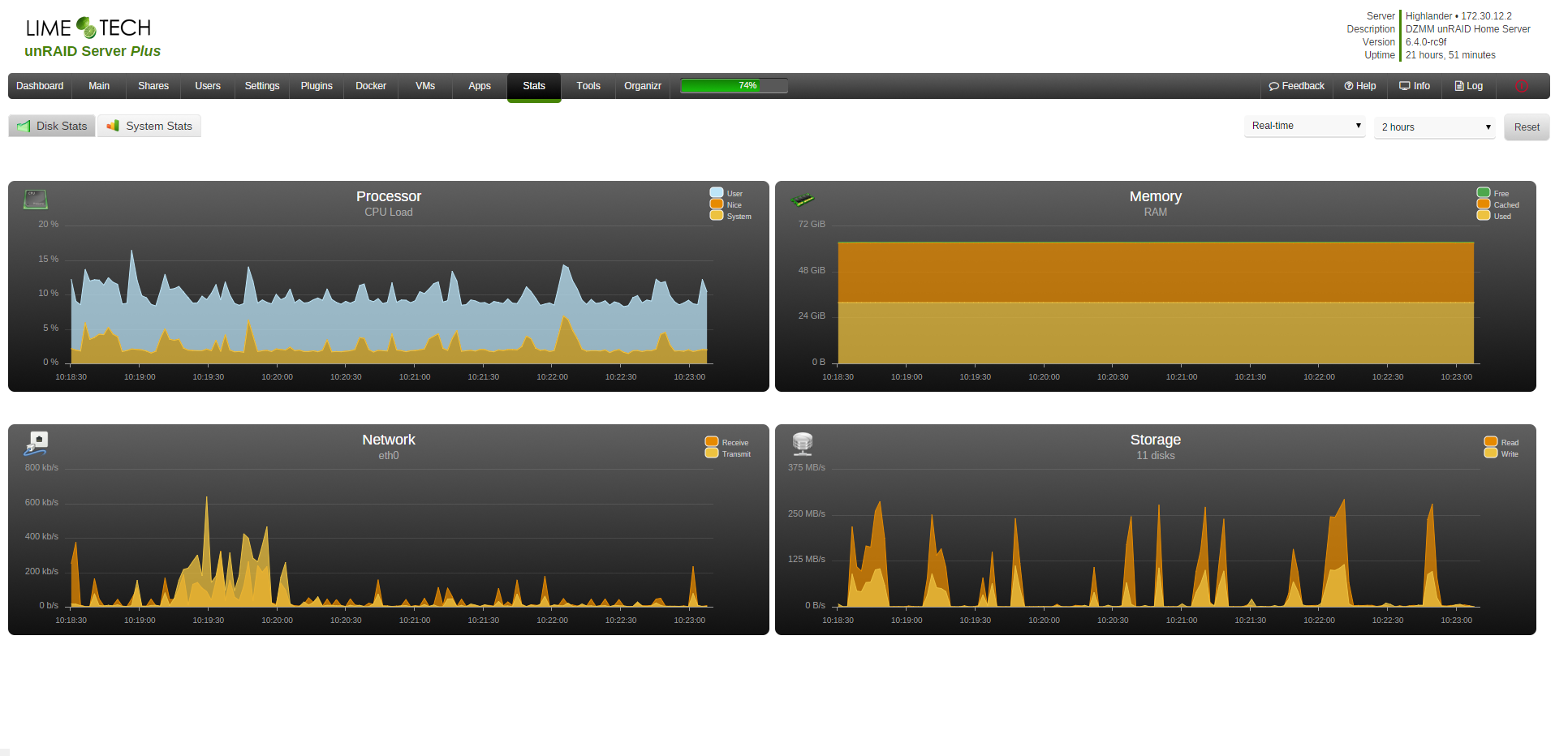

I'm now trying to move some files between disks to do some organising. I was doing this before with my last parity drive with turbo write on and it was flying; now it's barely moving.  Look at my disk history - it keeps peaking and then dropping off.
Even creating diagnostics took about 90 seconds.
Any ideas what's wrong?  I've got turbo write on.  Do I have a duff parity disk and need to return it,  or did something go wrong with the initial build (hence the errors)?  It did the parity check in the expected time, so the disk seems to meeting its performance envelope.
59e71d99b197b_FireShotCapture32-Highlander_Stats-http___172_30_12.2_Stats.thumb.png.5990d318adfc4b19d0deb28b57d895c7.png
highlander-diagnostics-20171018-1024.zip
Edited by DZMM
Update: reads are just as bad.  I just tried watching a 5GB GOT episode on a VM and it's buffering every 5 seconds.

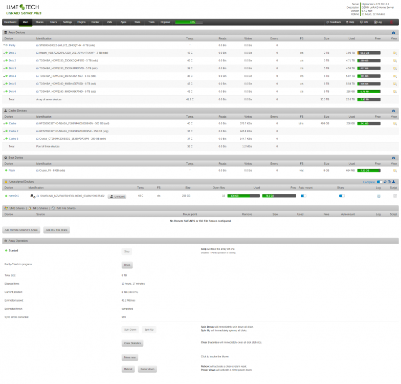

Check out the latest diagnostics - I've just rebooted (I couldn't shutdown using the menu or SSH BTW - had to use the case power button) as I wanted to check my cables.  Now 'all' I've got going on is a parity check and deluge & nzbget trying to start, and the parity check can only manage 198.8KB/s - over 460 days to complete....
My machine never had any slowdowns like this before - yes, individual transfers would slow down if I had a lot of concurrent ones, but the overall speed would still be high and the machine would never slow to a halt - particularly when I've not even initiated anything like in the diags attached, where the machine has just rebooted and has just auto-started dockers and a parity check i.e. is in a 'idle' state.  My old X300 6TB parity checks never went over 17 hours or so for an ETA, regardless of what I was doing.
This is the 2nd 8TB archive I've had in a week (first one was DOA).  Everyone else seems to have no problems with them, but it's looking like I'm the odd one out and I need to try and get a refund or try a 3rd.
highlander-diagnostics-20171018-1131.zip
Edited by DZMM
