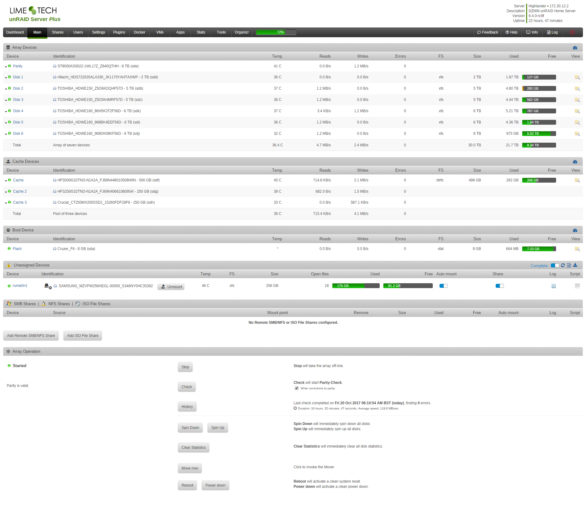

Blimey, this is awful.
I'm trying to move my old tv recordings from my cache to the array to free up space and I'm getting 1.5MB/s and that's using turbo write!!!  I must have a duff drive as I can't be the only person with a setup that causes problems, especially when I've stopped almost all activity?
Are there any additional tests I can do to prove a fault with the drive?  The retailer won't do no-quibble exchanges, so maybe I could try an RMA with seagate?

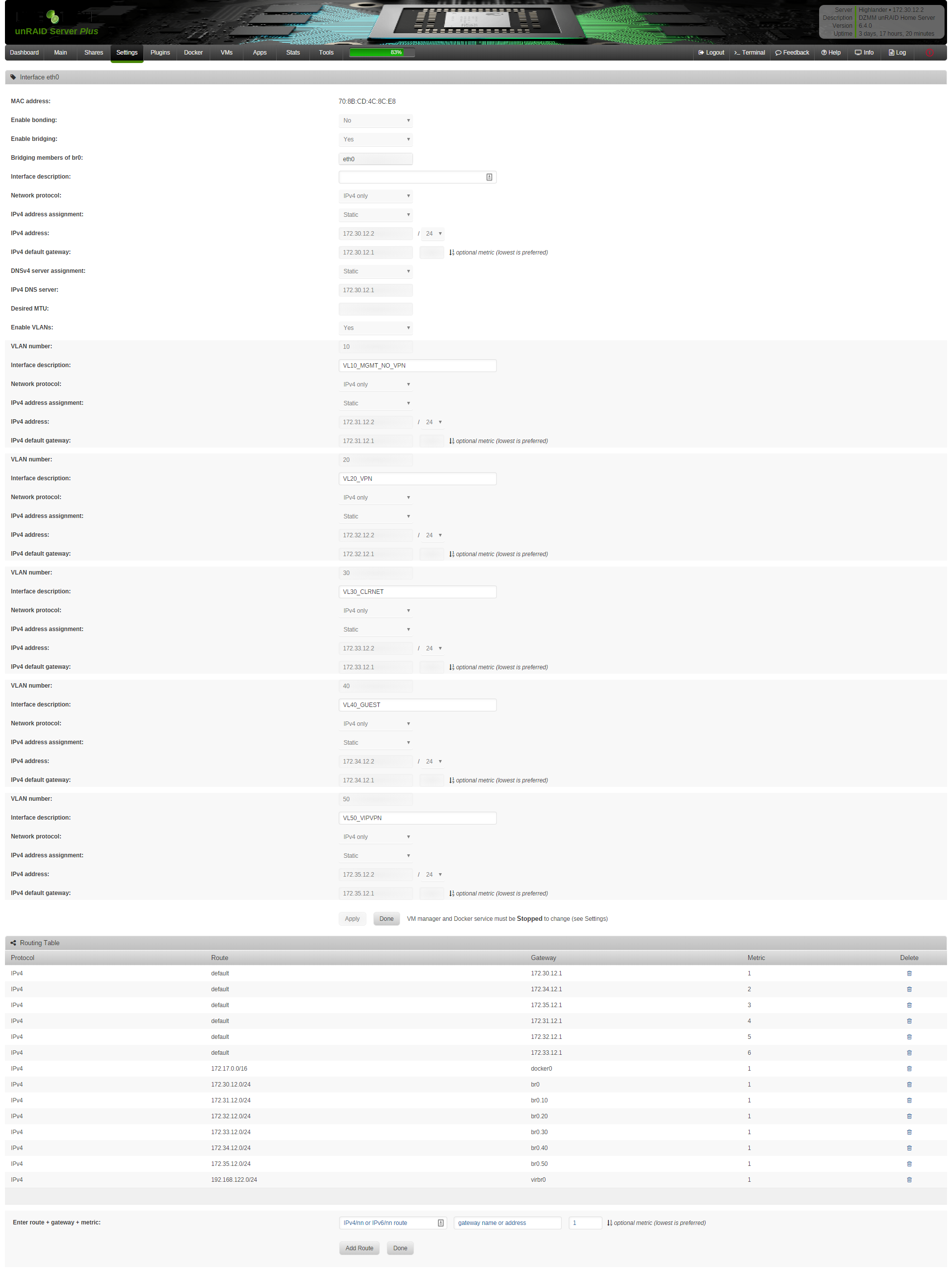

second update:  Adding a new note as I've found another source for the slow speeds.
In my unraid settings my server address is set to 172.30.12.2 and I have several VLANs a la 6.4.  What I noticed yesterday is that when I'm on my main windows 10 VM on VLAN50 (172.35.12.x) the unraid server is accessible at 172.35.12.2 as well as 172.30.12.2 - not sure how or why.
Anyway, if I connect to my server via SSH from VLAN50 to 172.35.12.2 instead of 172.30.12.2 I get expected transfer speeds e.g. 50MB/s+ when copying between drives - I was also having a problem with putty disconnecting when connected to 172.30.12.2 after a few minutes which is now fixed if I connect to 172.35.12.2.
@bonienl @limetech where has the 172.35.12.2 address come from?  I've changed some of my other VLAN 50 devices (e.g. kodi boxes) to point to 172.35.12.2 rather than 172.30.12.2 and again this has fixed intermittent disconnect problems.
5a5f715d6bfed_FireShotCapture37-Highlander_NetworkSettings_-https___1d087a25aac48109ee9a15217a.thumb.png.f6cfa7f5b27d7adb99ec2ca083fb7092.png
Edited by DZMM
Well your network settings show the 172.35.12.2 ip. And yes, the current docker network support requires unraid up on all interfaces your Dockers might be interested in using. Unseen side effect is that the server can be ssh'd smb'd or nfs'd on all of those ips. So even bigger attack surface. And your windows VM connecting to the local vlan IP is going to be more performant than the one on a different vlan to it.
RFC1918 defines private address range as 172.16.xxx.yyy up to 172.31.xxx.yyy
Addresses like 172.35.xxx.yyy are public addresses and used 'somewhere', you may not be able to reach certain internet sites if they happen to be on those public addresses.

Duh - when I created my VLANs I didn't even check to see they were valid addresses.  Will fix this - thanks
