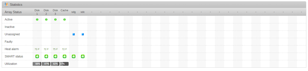

After a reboot, I'm now seeing this on my dashboard:
My other disks including unassigned devices are still there.  I'm not seeing the parity disk listed in any way:

Parity disk was already disable at boot time, whatever happened it was before the reboot (do you have notifications enable?), no extra 3TB disk detected so the disk is dead or disconnected, check cables and try a different port.
Yeah.  Figured my last option was to remove and reattach the disk.  I'll give that a go.  Thanks.

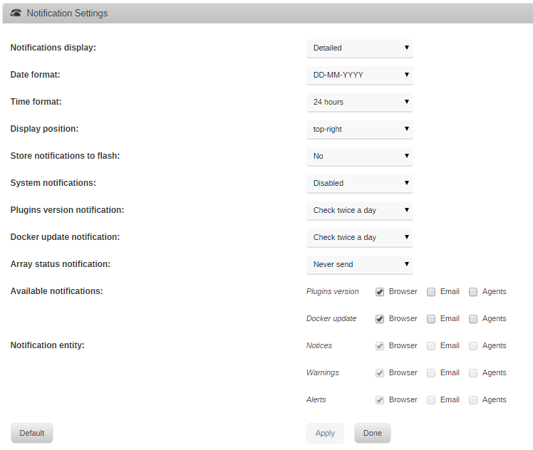

And yes, if this is what you're referring to:
I cannot recall any notification that there was an issue.
Enable "System notifications" and use email or another agent, at least for warnings and alerts.
Thanks for the tip!
