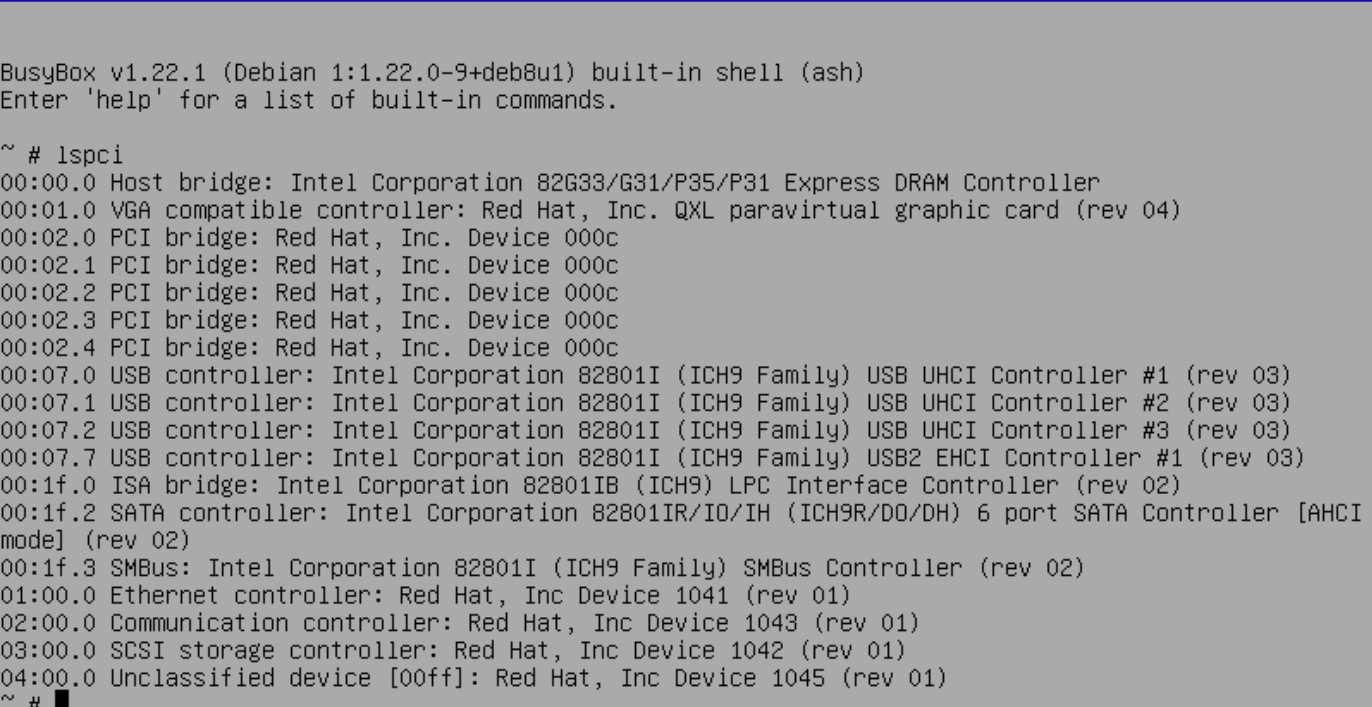

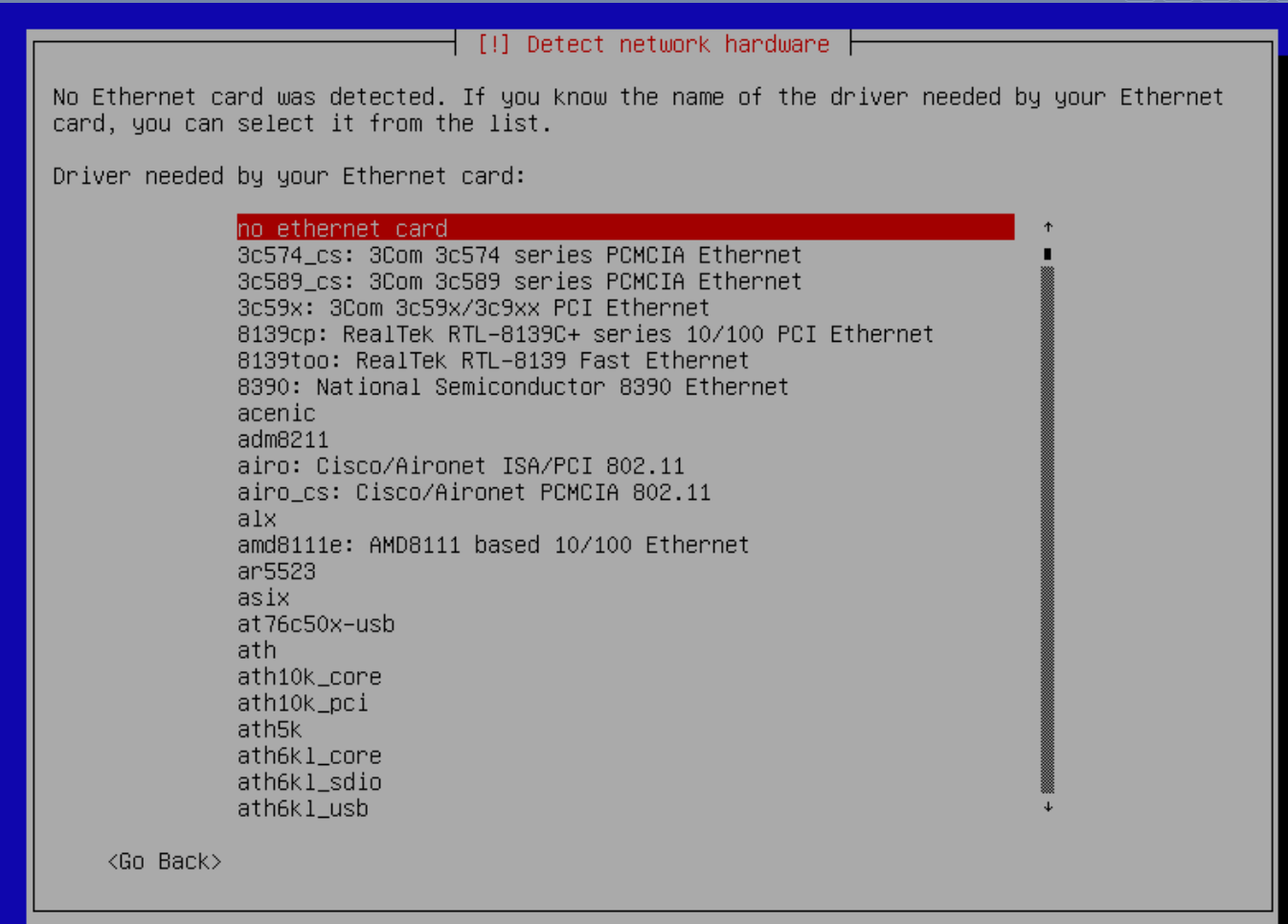

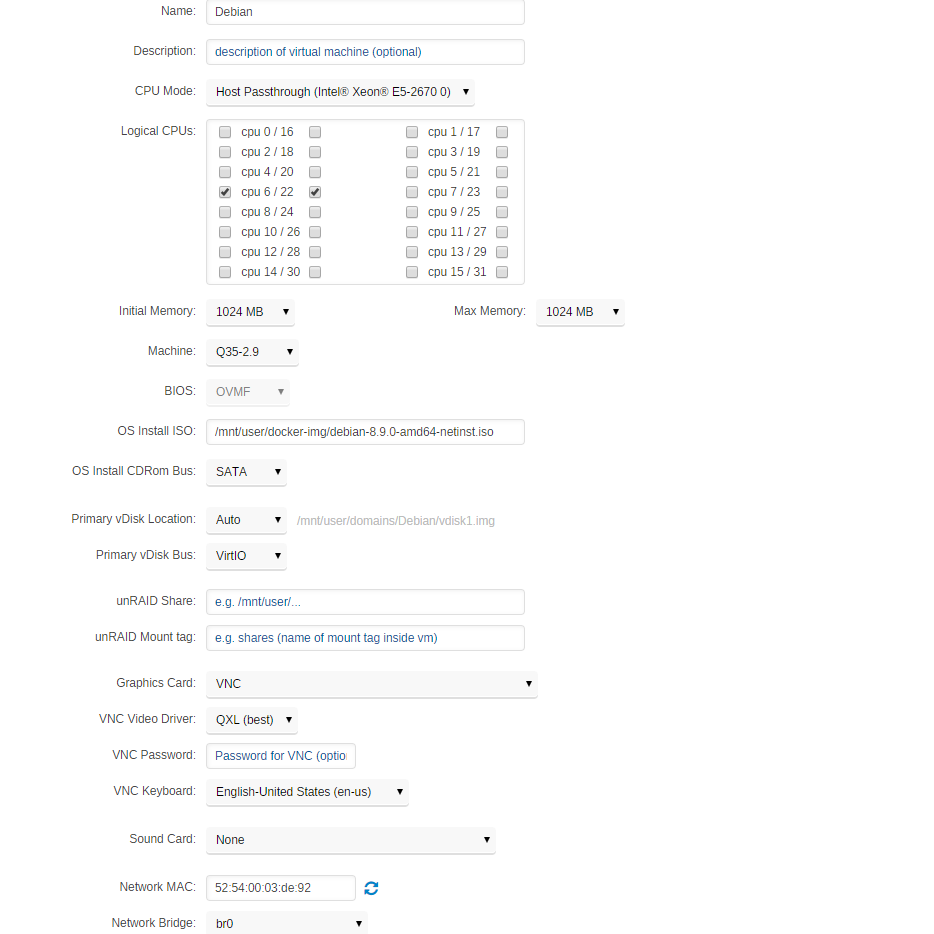

October 19, 20179 yr Hopefully this is pretty simple. Trying to make a Debian Jesse VM. However, it keeps saying that there is no network card detected: I have other VMs running on br0 no problem (1 Windows, 2 Ubuntu). Here is the 'Edit VM' page. No custom XML edits: lspci in VM: I have tried both SeaBios and OVMF, same problem. I am using the netinstall images, I will download the full images and try that, but you would think that the netinstall would have the correct drivers right :-D. Help?
October 19, 20179 yr Set the network adapter to be an E1000 rather than virtio in the XML for the VM. So change: <interface type='bridge'> <mac address='xx:xx:xx:xx:xx:xx'/> <source bridge='br0'/> <model type='virtio'/> <address type='pci' domain='0x0000' bus='0x0x' slot='0x0x' function='0x0'/> </interface> To this: <interface type='bridge'> <mac address='xx:xx:xx:xx:xx:xx'/> <source bridge='br0'/> <model type='e1000-82545em'/> <address type='pci' domain='0x0000' bus='0x0x' slot='0x0x' function='0x0'/> </interface>
October 19, 20179 yr Author 59 minutes ago, BobPhoenix said: Set the network adapter to be an E1000 rather than virtio in the XML for the VM. So change: <interface type='bridge'> <mac address='xx:xx:xx:xx:xx:xx'/> <source bridge='br0'/> <model type='virtio'/> <address type='pci' domain='0x0000' bus='0x0x' slot='0x0x' function='0x0'/> </interface> To this: <interface type='bridge'> <mac address='xx:xx:xx:xx:xx:xx'/> <source bridge='br0'/> <model type='e1000-82545em'/> <address type='pci' domain='0x0000' bus='0x0x' slot='0x0x' function='0x0'/> </interface> Bingo. That did it. Thank you ! :-)
