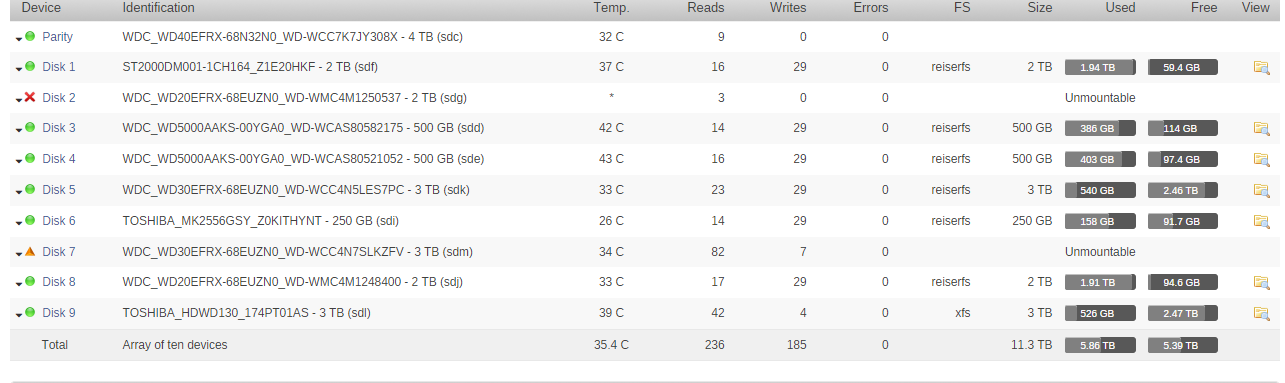

I had an unmountable disk (2TB) present which I thought was a dead disk. So I precleared a new 3TB disk and went to add it in to replace the disk. I now have a completely different 2TB showing as unmountable and the new 3TB disk is also showing the same.
I have done some reading around but I'm a bit of a loss what to do. Attached is the output from the diagnostics. I've also run reiserfsck --check which has shown 0 errors.

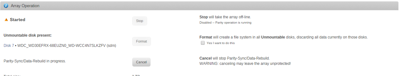

Its still saying Disk7 is unmountable, however its started rebuilding the array?

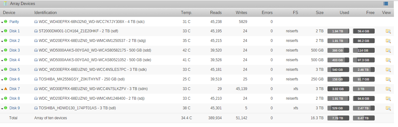

I think we're all good now;
The parity sync is running (will be done in 16 hours).

I posted to stop if one the disks was unmountable, but it's not a problem to continue, just no point in rebuilding if the filesystem is unfixable, though since it's reiser it should be fixable, let the rebuild finish, and then run reiserfsck on disk7:
-stop the array
-start the array in maintenance mode
-on the console type:
reiserfsck /dev/md7
Post the output if in doubt on how to proceed.

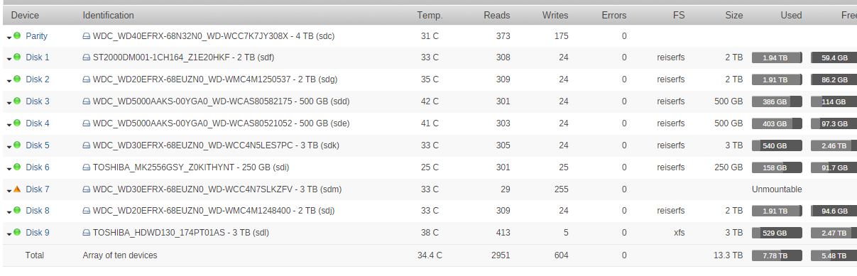

Looks like you formatted disk7, was it empty?
Yes was entirely empty, was the brand new disk.
Good, I though it contained data, all good then, just let the rebuild finish.
