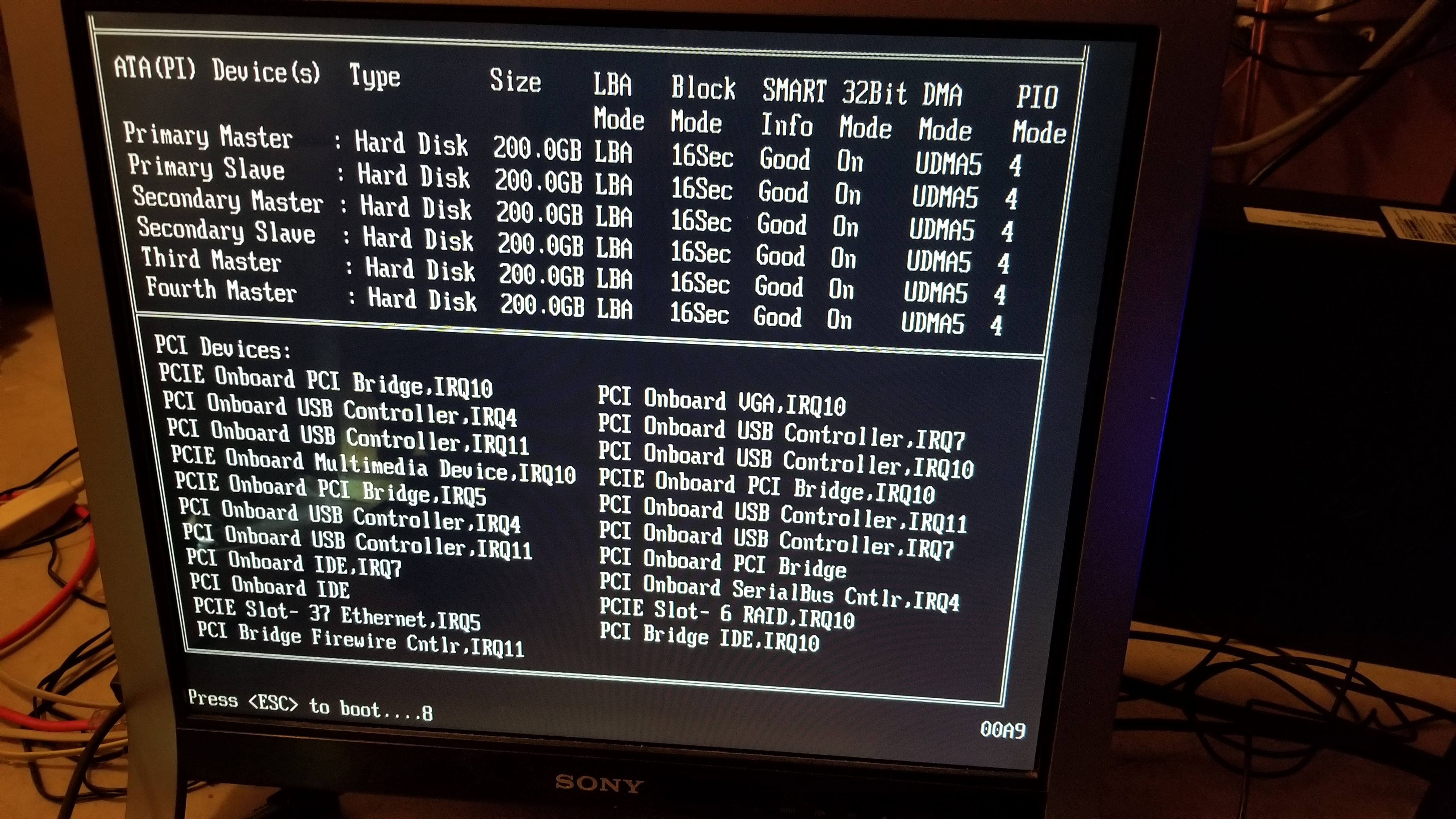

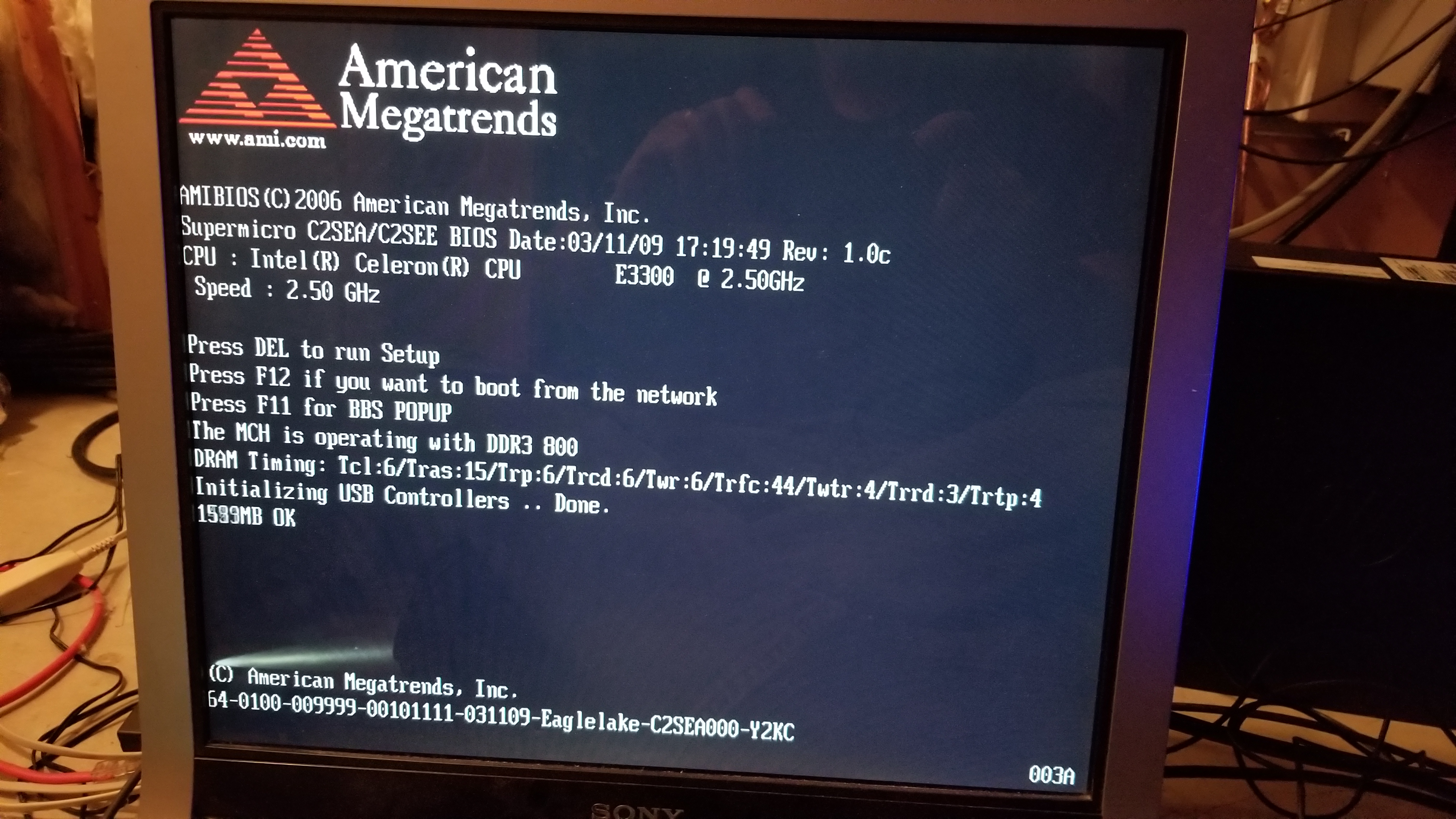

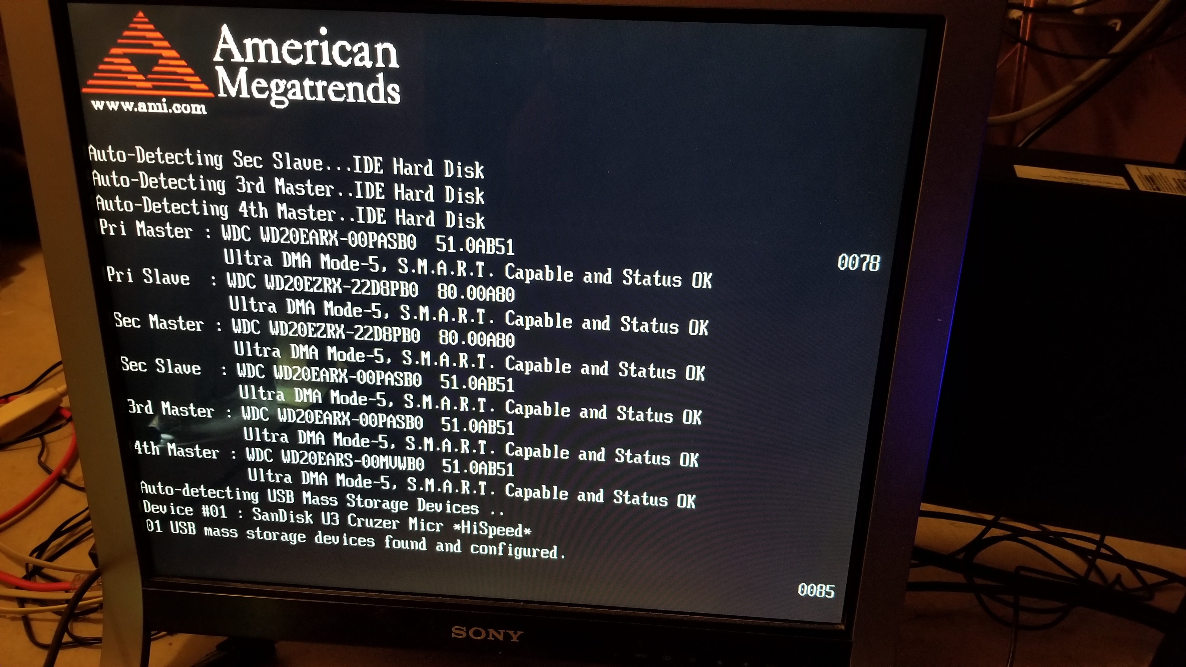

Ok. I see how my post was confusing.
During boot, only the drives connected to the motherboard are listed (they were always listed even before adding the RAID card). Drives connected to the RAID card are not displayed.
During boot, there is only one indication that a RAID card exists: it is listed as occupying PCIE slot 6.
I don't get any prompts or any other message from the RAID BIOS. Should i?
I have poured over the motherboard BIOS settings and cannot find anything that looks like it would limit the BIOS from a PCIE card from displaying or being interacted with. That's why I brought up the jumpers in the previous post. I'm wondering if those jumpers are preventing this - but I'm a little scared to add them and was asking if anyone could interpret their meaning for me based on what I posted from the motherboard manual.
I've attached 3 pictures of the monitor during boot. Maybe there's something I'm missing. I'll also try another slot.
