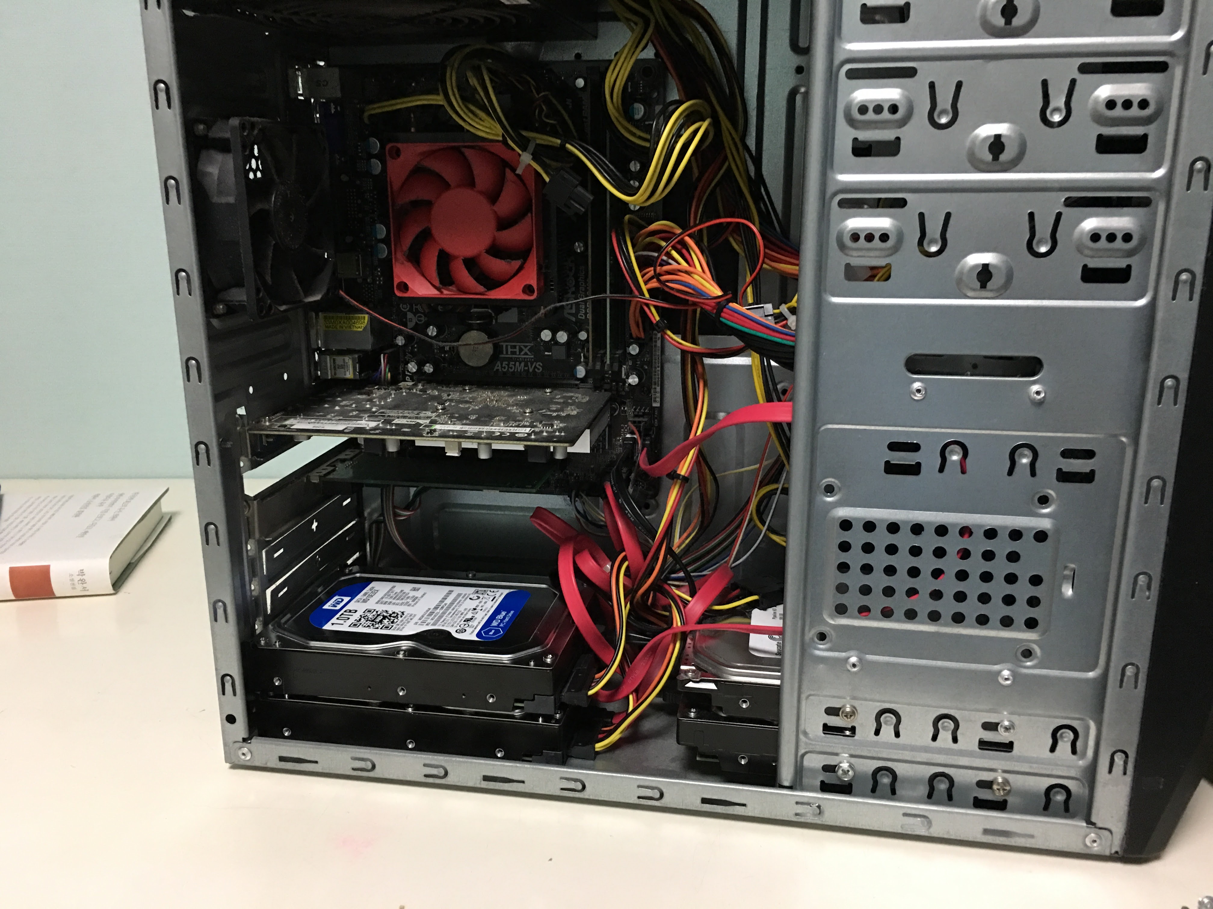

OK, replacement disks arrived today. This is probably the most ghetto setup ever:
New two disks on the left side, the dying disk was on the right side where all the array of holes are (2.5 enclosure) , which isn't shown because it's not there anymore.
Rebuild started and preclear started. Once preclear completes I'll take out the other 500GB disk and start rebuilding again.
Just laying the drives on top of each other isn't very good for drive cooling. Google "drive cages" and see if you can find something that will fit in the space.
It looks like you may have some 5.25 inch drive bays. You should be able to find some cages to put the drives there.
I highly recommend hot-swap cages like supermicro cse-m35t-1b. Hot swap feature not important, but ability to swap out disks without disturbing drive cabling is very important. Also, these cool very well.
Your bottom disk will probably run very hot. Also the disk above might get hot as well because it will absorb heat from the disk below it. If you want to place them like this in the bottom of the case you are much better off if you put them on their sides with some air around them. Also, you can strip a fan somewhere, just to create some airflow along the drives. Any fan you might have laying around might to the job. At least your drives won’t cook. Also, make some kind of support so they don't tip over if you move the case.
Order a pair of these 3.5 to 5.25 adapters or something similar. Those are all of $5 each with free shipping (at this particular moment in time) from the geek's favorite store named after not-old eggs. ;)
Worst case scenario, slide a couple of #2 Ticonderoga pencils between those drives. The wood will insulate, the hexagon shape will prevent rolling, and the gap will allow air through!
How many externally facing 5.25" bays do you have?
