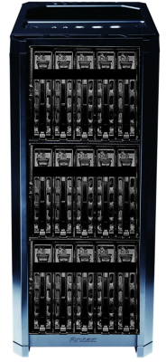

Nothing beats a Supermicro 24 or 36 bay case IMO, but you can certainly go with an Antec 1200 with 4x5 hot swap bays for 20 drives which should last you awhile. Nice thing about the Antec solution is that you are not as restricted on motherboard size as you are with a Supermicro and being a tower, the Antec is more versatile in where it can go as well.
Antec 1200 or similar with 4 5in3 CSE-M35T-1Bs.
Below is an Antec 900 with 3 of them (15 drives)
I have a Sharkoon Rebel 12 which is no longer made, but allows the 4 5in3s. (20 drives)
I also have one extra 5in3 that I use externally - giving me the 24 drive capacity you also desire.
Works pretty well in an unfinished basement or other unoccupied location where a bit of noise is not a big issue. I believe it is still quieter than a big rack, but not sure.
