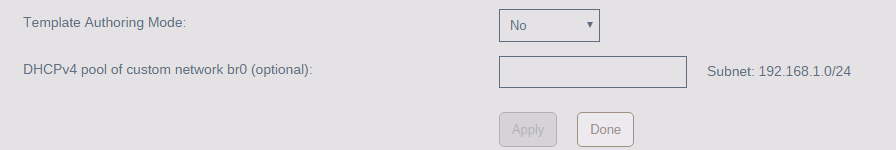

Do I need to set this up?
Start/stopping didn't make br0 appear.  I did fill out the custom netork for br0 as well, but it didn't help either.
The optional DHCP pool is used to defined a range of IP addresses for automatic assignment to containers in case a container is not given a fixed address. The range define here should not overlap which the IP range handed out by the regular DHCP server (usually your router) on the network.
When a DHCP pool is given, the network (br0) should also appear in the dropdown list.

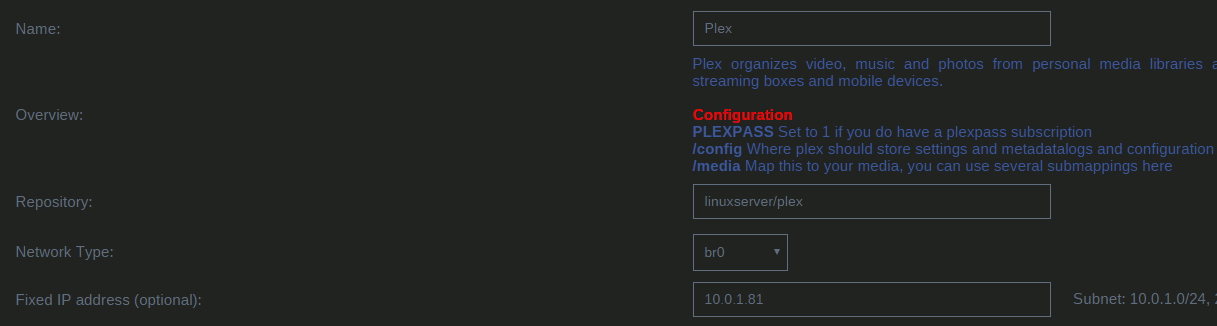

@bonienl Was wondering if I could get some help with this. Server has a quad NIC, and I'd like to take one of those and use it for one specific container, leaving the rest as they are (at least for now). I set the eth1 interface up with a static IP, and I'm able to choose that interface in the container template. When I start the container I am able to ping it locally just fine, but it cannot reach the internet. I've been all over the forums looking for an answer, and I'm sure its just me missing something, but any help would be appreciated.
